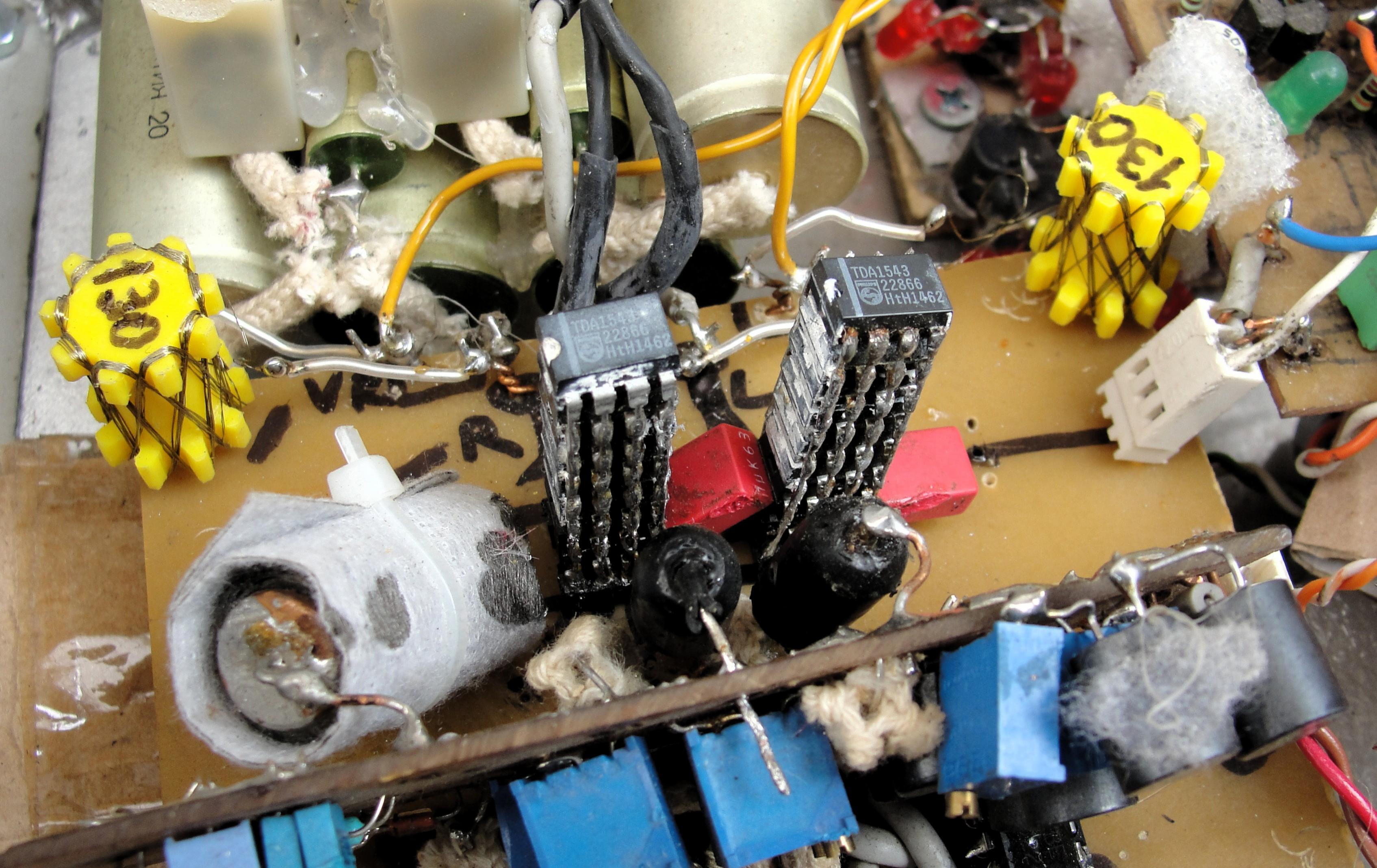

Exactly. It's all about satisfaction. That is why I continue to play with the obsolete and noisy 1543 😀 It produces involving and entertaining music, not the cleanest but who cares...
Attached, a detail picture of my 8*2 DUAL-MONO-SDplayer, with 130 Ohm honeycomb resistors. I have to include a temperature controlled air cooling system and some sort of Faraday cage...
