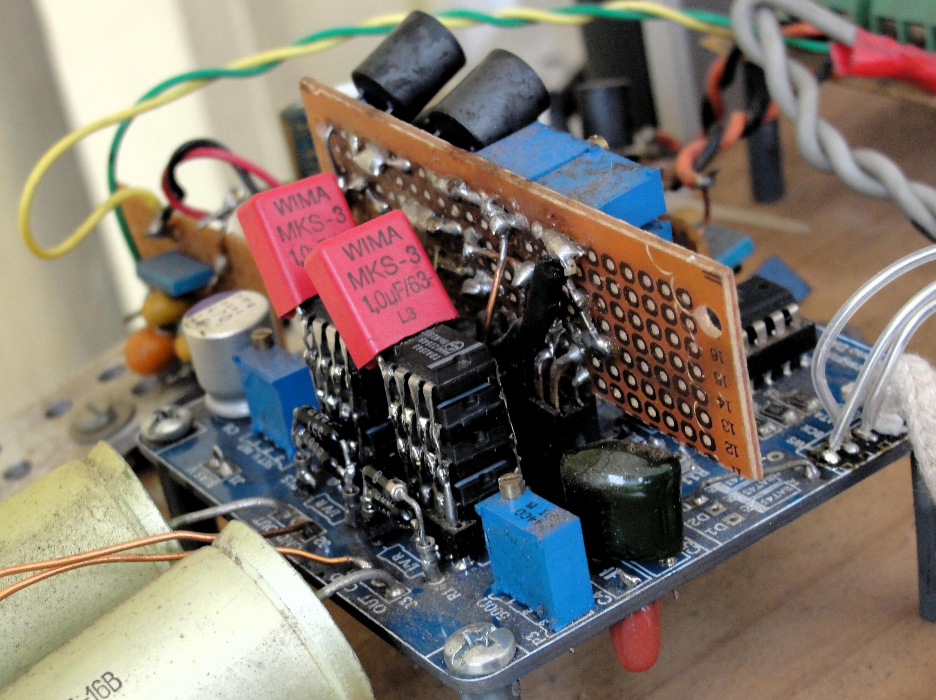

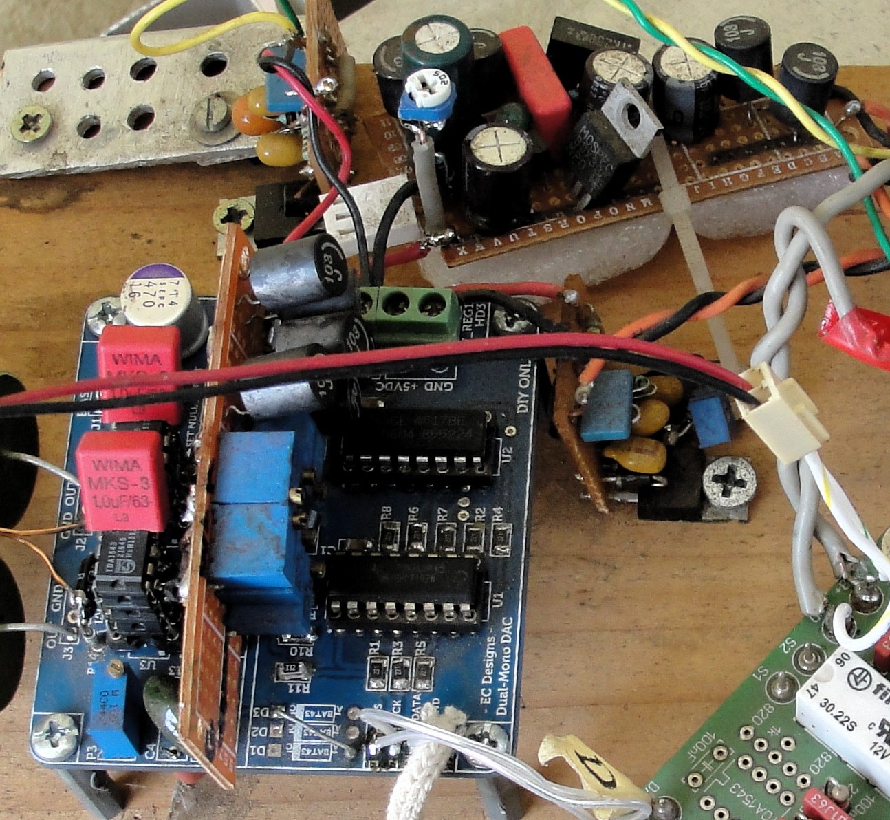

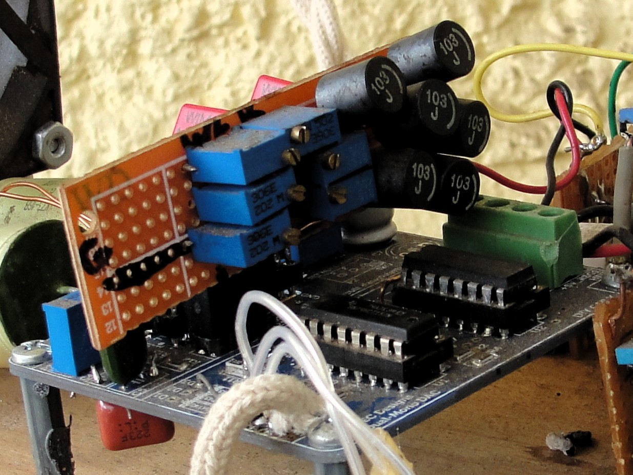

Nice screen. The problem is that Chinese re-sellers won't support you. For example, no one answered what the magnitude Vout for the I2S signals is?. If it is less than 1,2V, chances are that our beloved TDA1543 doesn't get exited, and if it is less than 1,5V maybe "I2S attenuator circuit" won't work.
IF I2S were higher, the player could be used with DUAL-MONO DAC. I attach some pictures of my DUAL-MONO in 4x2 version: two towers of 4 chips. Best midbass ever...
One of -EC- Vregs is visible on top.
M.
