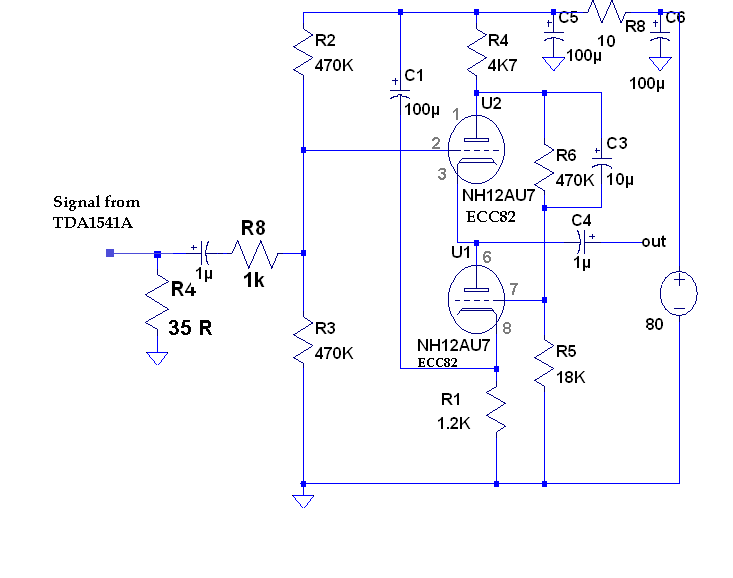

How about this ECC82 IV amp buffer for the tda1541a ?
Thanx

Hi tessier,
Here are some basic properties for a TDA1541A I/V stage :
- Output compliance of +25 / -25mV at the DAC output -must- be met, these are absolute maximum values.
- Bandwidth of the TDA1541A output signal must be limited prior to feeding it into an I/V stage.
- All bit currents -must- be returned to +5V
- The I/V stage should be perfectly able to handle the presented bandwidth.
- Full DC-coupling is -required-
- I/V stage should be able to resolve signals down to 61 nano amperes / 30 microvolts.
Your circuit generates -0.004 * 35 = -140mV at the DAC output, this grossly exceeds output compliance. Since no +2mA bias current is used, signal does not swing around 0V, this increases the problem.
When using a suitable +2mA bias current source, max. I/V resistor value would be: 0.05 / 0.004 = 12.5 Ohms. If the +2mA bias current is not used, the I/V resistor value has to be reduced to 6.25 Ohms.
The bandwidth of the TDA1541A output signal is too large to directly drive a passive I/V resistor or circuit. So the output signal must be bandlimited prior to feeding it to an I/V resistor or active circuit. This can be done by connecting a suitable capacitor between TDA1541A output and GND or connecting a suitable capacitor at the output of a step-up transformer.
Step up transformers can limit bandwidth, provide sufficient signal amplitude while meeting output compliance, and also handle low level signals quite well.
Suppose we use a Sowther 9762 1:12.8 step-up transformer. When using a 1K I/V resistor at the transformer secondary, the reflected secondary load will be 1000 / 12.8^2 = 6.1 Ohm. This will meet output compliance (-0.004 * 6.1 = -24.4mV). The output signal amplitude will then be 312mVpp. If an output signal of say 6.65V is required, tube amplifier gain needs to be 18.
It is also possible to use both secondary windings of the 9762 to drive a differential tube amplifier stage. In this case we have 2 I/V resistors of 500 Ohms each.
This however doesn't solve the issue with bit return currents. The selected bit currents are routed through the reflected load of 6.1 Ohm to GND. The unselected bit currents are routed to +5V (inside the TDA1541A). This means that the load current on the +5V varies with the signal, this results in a ripple voltage that is extremely difficult to reduce to required low levels in the microvolt range. The ripple on the +5V (that also powers logic circuits) will introduce trigger uncertainty, introducing deterministic jitter (jitter related to music content).
The use of a transformer no longer provides full DC-coupling, full DC-coupling is required for highest transparency.

Q for EC
will the low values of R-IV like 6 to 12 ohms overheat the TDA1541A chip
from Your knowledge?
I think with an I/V resistor this low the only chance would be a Jfet phopreamp type gain stage.
With a tube the SNR would kill resolution.
One of the quietest tubes is a triode strapped D3A and it has nice gain but even it would have trouble amplifiying a .002mAx10 ohms*0.0015849 LSB = 0.03 micro Volt signal.
Probably end up with a 12 bit resolution DAC at best with a 10 ohm I/V resistor.
