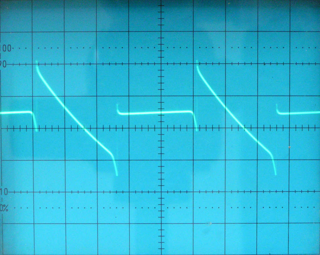

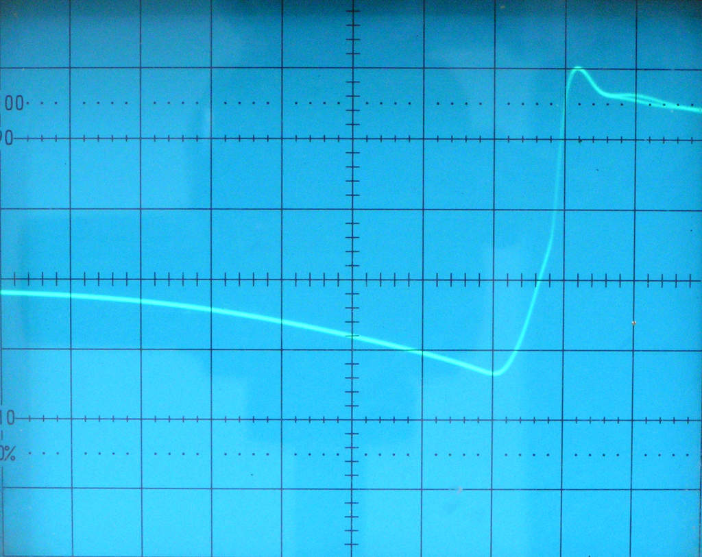

I am using a different DEM circuit in the SD8-player, here I can get low jitter at any DEM frequency I like. Circuit is as follows:
6K8 between pin 15 (-15V) and 16
6K8 between pin 15 (-15V) and 17
Timing cap between pin 16 and 17 (1n5 or lower).
The repetitive signal frequency (step-shape signal) on any active divider output equals fDEM /4. In order to keep this frequency above the audio range, the DEM frequency should be at least 4 x 20KHz = 80 KHz.
First oscillogram shows the DEM oscillator signal, second oscillogram shows one of the transients in detail.
The DEM oscillator crosstalks with BCK and WS (that's why the free running DEM oscillator can lock to multiples of fs). This means that the jitter spectrum will be changed by it and this in turn may be audible. In other words, when the DEM frequency is changed and the active divider outputs are perfectly filtered, one could still hear its effect on sound quality through jitter contribution.
