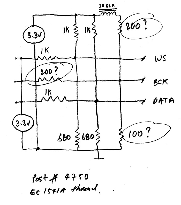

Clarification on Attenuators with 3.3V source (incl. BCK)
Hi ECdesign and others,
I'd like to ask what should ideally be done with BCK when its fed from a 3.3V source.
I can see that its amplitude will be about twice the level of WS and DATA (~1.7Vpp) when WS and DATA are using the 1k series and 1k + 680 voltage divider across the 3v3 supply.
From 3v3, (20 DCR inductor + 150R) +(100R) voltage divider would draw (3.3/270) = ~12mA and bias the input at ~1.2V when connected at the top of the 100R pull down resistor.
Is it then a simple matter of using 100R series resistor between the 3v3 BCK source and the top of that 100R pull down resistor (BCK/2) to reduce 3v3 BCK to ~1.65Vpp?
Is it close enough to be ok, or something else?.. (more series R, higher value pull down, higher value pull up, less current, same bias voltage, more attenuation ?)
Thanks,
Shane
Thanks,
Shane
Since they are wideband digital signals, they should be handled in very particular way to conform digital signal transmission techniques such as impedance matching.
Your "divider" is basicly an attenuator which output impedance should be matched to the characteristic impedance of the trace (cable) you feed it thru, as long as it is being placed on the source of transmission line. It's source impedance is easily calculated of paraleling these 3 resistors.
Another way of dropping-off the level of signal is to terminate it in series at the source's end, make attenuator's input impedance the same as incoming transmission line, and source impedance the same as outgoing transmission line impedance... Much over my head i'd think, especially when you have to bias the output HI/LO voltages at particular level 🙂

Thanks for this..
I'm a little confused because if the source impedance is the parallel value of the three resistors, consider the values of both WS and DATA 3k3//3k3//1k = 622ohms in the 5V attenuator cct, and 1k//1k//680 = 288 ohm in the 3v3 attenuator cct.
However, the values for WS and DATA have been given, and just BCK remains unknown (to me anyway). If I use the given values for the 5V cct 500//68//220 = ~47ohms.
If the attenuation is a function of the voltage divider created by the series resistor and the shunt resistor to ground, then signal level for WS and DATA in the 5V cct, after the divider, is 1.1V (this is Vpp?) and only 0.59V for BCK?.
If its desirable to have amplitude of the three lines between 1.2 and 1.4Vpp, and each biased between 1 and 1.4V, with a parallel resistor value of ~50 ohms for BCK, then the values I've arrived at are as in the attached image.
Does this all seem correct, or at least correct enough for the purpose, or have I got it all backwards?🙄
