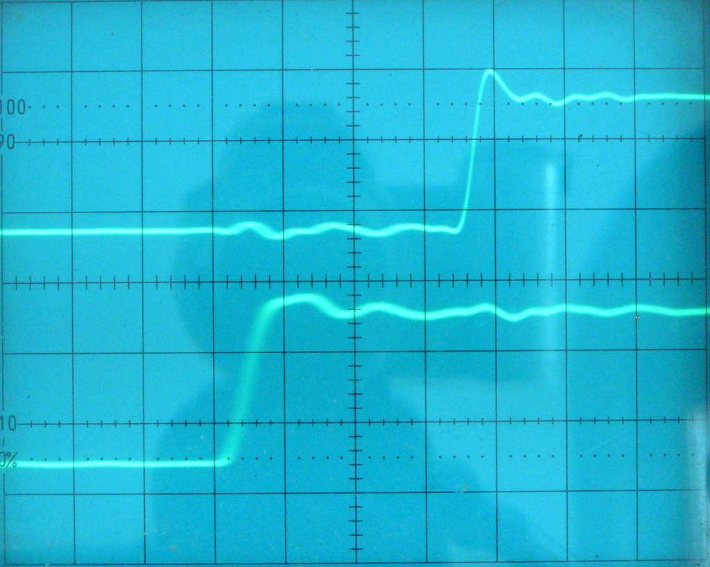

I attached an oscillogram of a novel jitter blocker I am working on.
Upper trace shows the jitter blocker BCK output. Lower trace shows PCM2706 USB receiver jitter (BCK) output before the jitter blocker.
The haze around the transient of the lower signal is clearly visible. So based on this measurement I can at least see that jitter has been reduced and I know the jitter blocker is functioning.
Now listening tests can be performed to further analyse the exact impact of jitter amplitude / spectrum on familiar high quality recordings. This is a fast ane effective method of examining the exact impact of jitter (spectrum) on perceived sound.
why don't you use a spectrum analyzer ?
Too expensive, too low resolution (A/D conversion), and it doesn't capture the information I am interested in.
How can you visually inspect a sinewave on a scope and claim it has - very low - distortion ?
I didn't mention that I measured sinewave distortion with that scope.
Same with your 2,5 kHz problem. Why not make a scan 20 Hz to 20 kHz ? It will tell everything.
The intermittent 2.5 KHz interference on the mains will stay there with or without measuring it with a spectrum analyser. It is generated outside my house and nobody will ever bother to remove it. It is also very likely that mains interference levels will continue to rise.
So I designed my equipment such way that it becomes highly immune to mains interference.
Not so long ago, - extremely low - jitter proved with 60 MHz Hameg…
I mentioned that I check circuit basic operation with a scope. The impact of jitter that the scope can't show is determined by listening tests.
