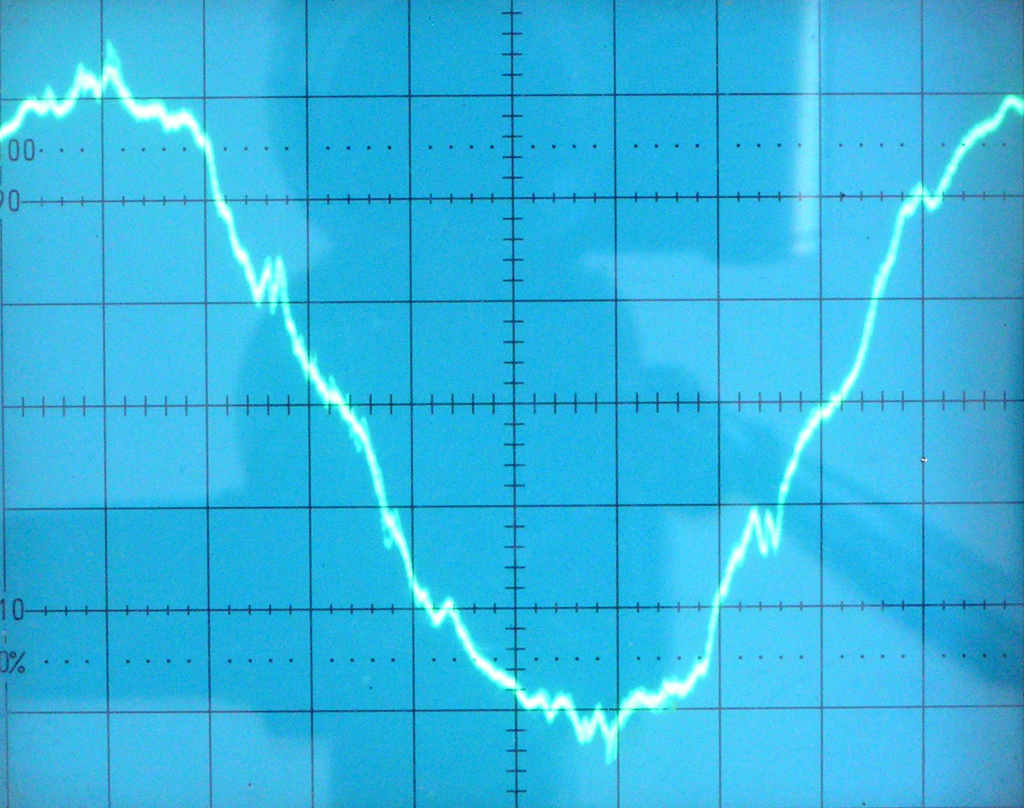

I attached an oscillogram showing my mains voltage when interference levels are lowest. Most irritating interference is the approx. 2.5 KHz signal riding on the mains. This interference swithes "on" and "off" with random intervals.
The interference is generated outside my house as it persists when my house installation is completely disconnected from the mains.
Ken Newton reported similar mains distortion, perhaps this mains interference is a global thing.
I would be very interested if people from other countries have similar distortion on the mains. If you have a scope the interference can be measured safely by connecting the scope probe tip to a sheet of copper. This will pick up 50 or 60 Hz mains frequency and the interference riding on it (when present). Measure for longer time period like a quarter of an hour because this interference switches on/off periodically.
Knowing the cause of the problem I redesigned power supplies so they are immune to this interference.

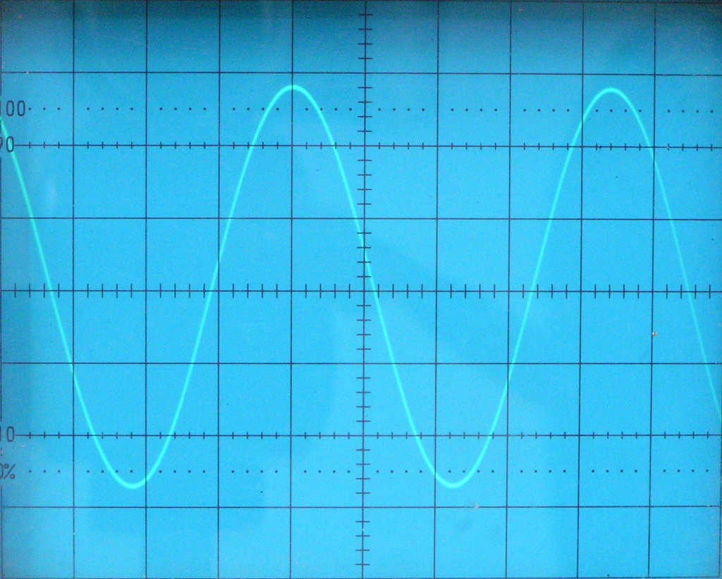

Next oscillogram shows the 11.2896 Mhz output signal. It's a pure sine wave with very low distortion (fundamental).

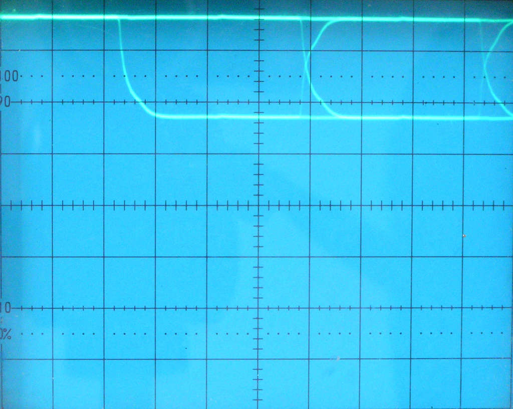

The third oscillogram shows the BCK attenuator output signal. The signal is band limited in order to minimise ground-bounce. The positive transient that's very important for sample timing is speeded up to maximum in order to ensure maximum trigger certainty.

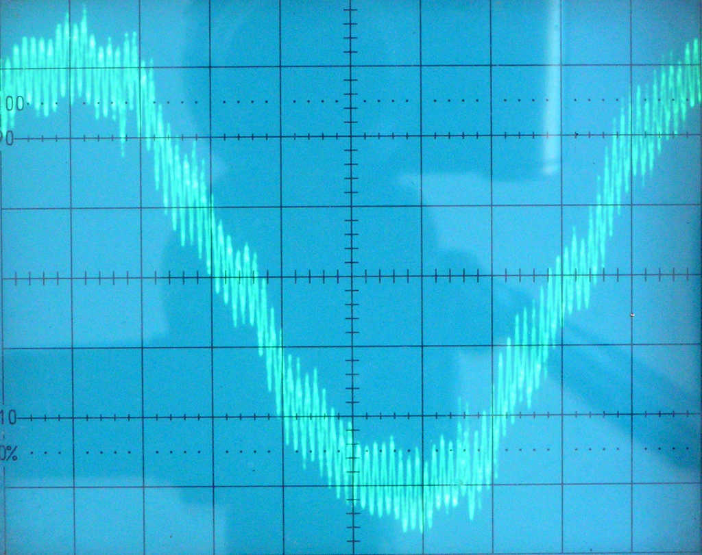

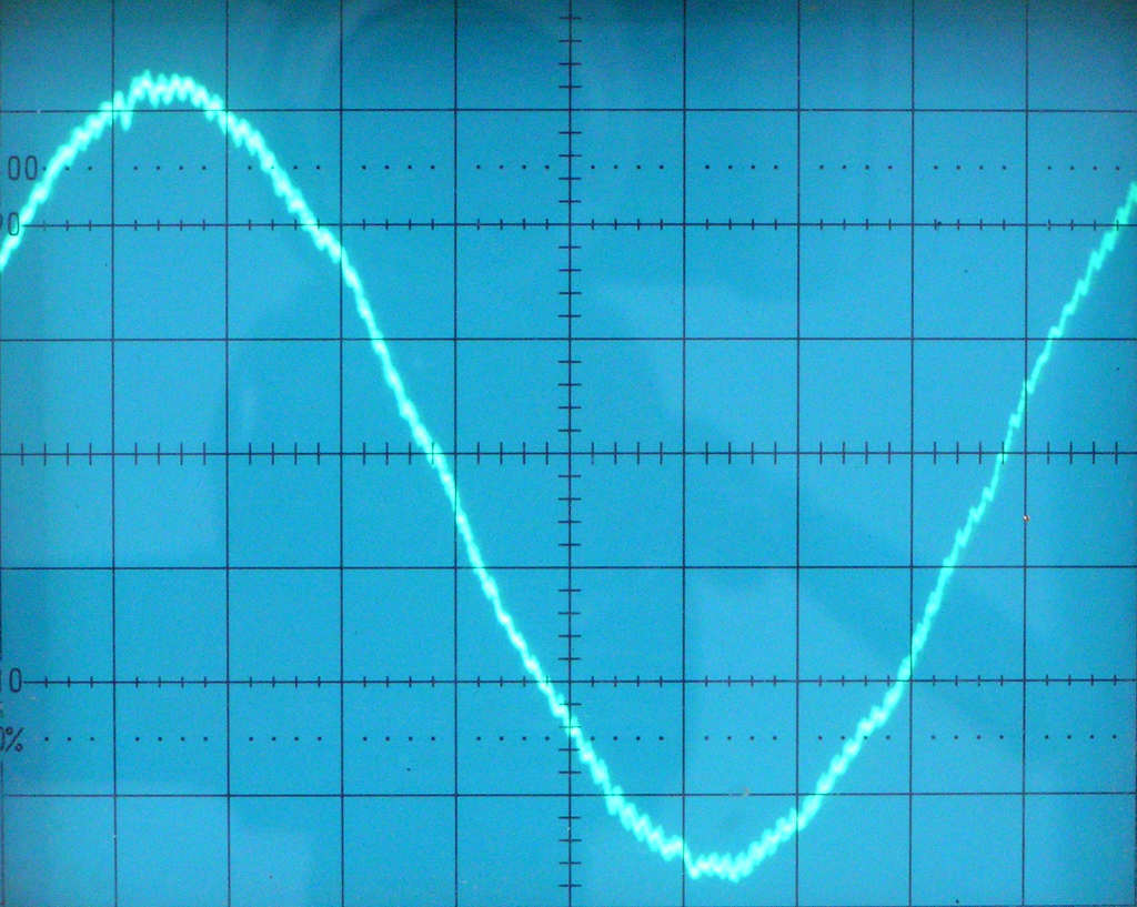

Here some mains interference pictures just captured today.
First picture shows 2.5 KHz interference when it is starting to peak (it gets even higher!)
Second picture just captured seconds later, the 2.5 KHz interference has gone for a moment.
I also have periodic mains drop-outs (few milliseconds to seconds) as cars pass by (loose connection in distribution point / arcing).
