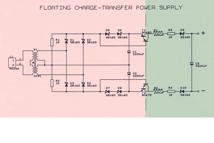

Building the ultimate NOS DAC using TDA1541A
See attached picture of FCTS

Hi, Marcel,
The main problem I see with this particular charge-transfer topology is that it still doesn't effectively isolate the powered circuit from A.C. line noise. While C1 is disconnected from the A.C. line by the periodic commutation of D5 and D6, any A.C. line noise still modulates the base of T1. Which means the current supplied to the powered circuit from C1 will be a modulated replica of that noise. The same noise breakthrough mechanism will happen with C2, T2, D7, and D8 during the opposite half-cycle.
The rise time inside the TDA1541A is determined by its specified limiting frequency of 6.4 MHz. This corresponds with a signal rise time of approx. 56ns.

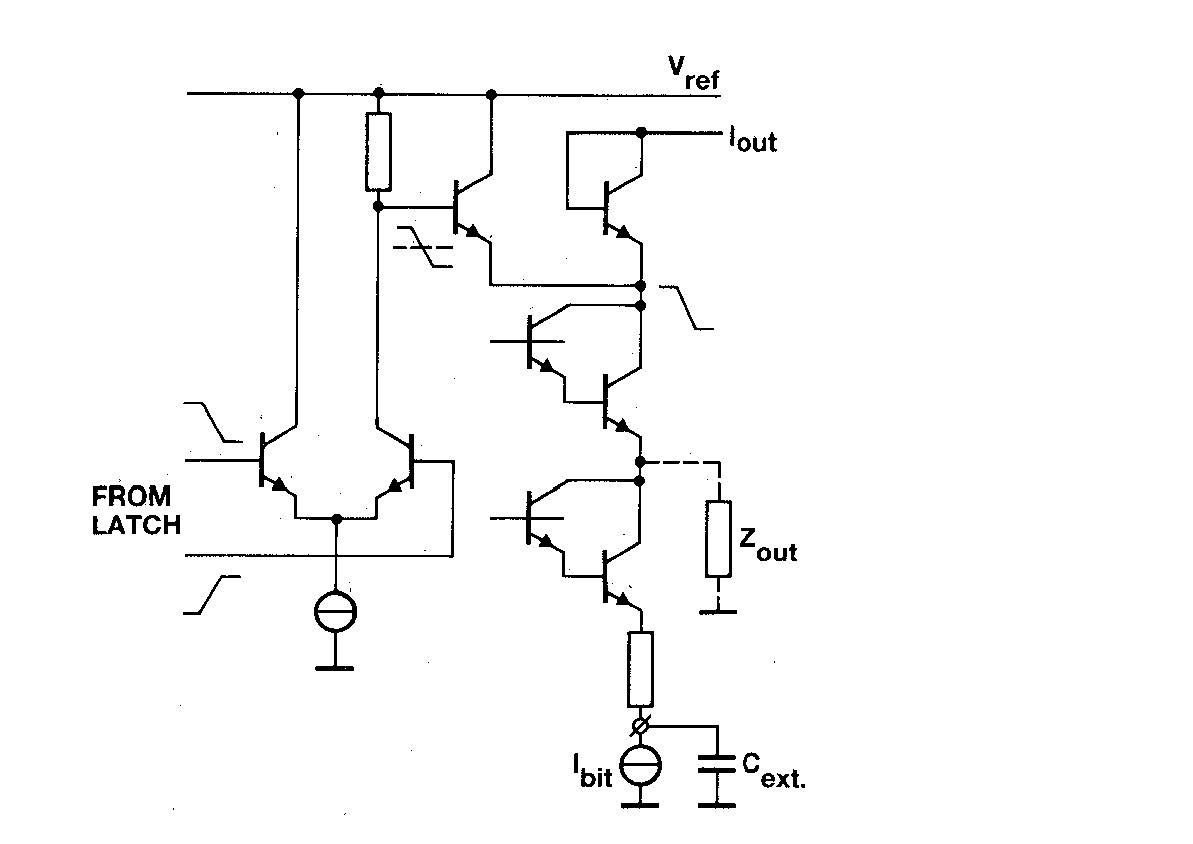

Each TDA1541A I2S input has a diode in series that stops conducting when the external signal amplitude exceeds approx. 1.4V. In other words, the external drive circuit is disconnected when the input diode stops conducting.
On the TDA1541A inputs stand the transistors but diodes connected with output of TDA1541A.
See: ″A Monolithic Dual 16-Bit D/A Converter″, ieee journal of solid-state circuits, vol. sc-21, no. 3, june 1986 and see attachment.
Based on this, the limiting series resistor value for TDA1541A BCK, WS, and DATA inputs would be 1K8
The value of the resistor must be close to wave resistance of the signal line to prevent the signal reflections. For PCB conductors this resistance has an order 100 ohm (nowhere near not 1k and not 1,8k). 1,8k - in any event too much
It is impossible with impunity enlarge duration a rise time of input signal. This enlarges the uncertainty of the switching, but signifies and jitters.
Serg

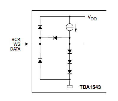

TDA1541A I2S input circuit is similar to the TDA1543 (attached schematic diagram).
I do not know, as beside TDA1543. But on TDA1541A I have studied much material and can confirm that you mistaken.
Here is circuit (see attachment) from monograph "High-speed and high-resolution analog-to-digital and digital-to-analog converters", R.J van de Plassche, 1989. This work is dedicated to family TDA1540, TDA1541(A). Obviously that diode unites with output, but at the input stands the transistor.
When using 44.1 KHz exclusively TDA1541A still works correctly with series resistors up to 1K8.
As be with reflected signals? Furthermore, signal fronts have too low slew rate. This enlarges jitter.

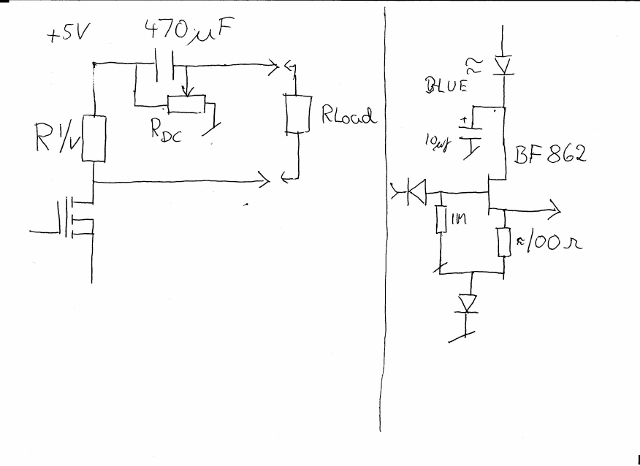

Qustion and suggested buffer/levelshift
Hi All
I have been following this thread for some time now. Facinating!
I am currently using a prototype DAC with much of the technique -ecdesign- uses and it is really showing promise (still a prototype with too long wires, bad screening aso.) .
I have a question regarding the DC shift in I/V stage.
Is this capacitor not as much in the signal path as a coupling capacitor?
See the attached schematic.
Depending on the load resistor, it is not even a correct DC coupling , is it?
And if you use a 470 uF coupling cap. and a load of say 100k , isn¨t this as good as a DC coupling (besides the fact that there is a capacitor in the signal path, witch has its problems)

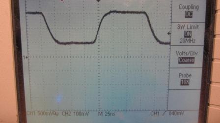

The other thing is a suggestion to a buffer / level shifter to act on the I2S signals.
Again look at the schematic.
The blue led reduces the 5V to 1,8V witch according to John, should be fin for BCK. A green or red could be used on the WS and DATA signals.
The diode below the source resistor raises the signal to about 0,5V. Maybe this is too muc, but a germanium diode could be used.

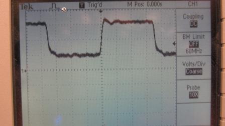

It is a very clean BCK that comes out of this - look at the pictures. Even from the very rude circuit as seen in the last photo.
Comments?

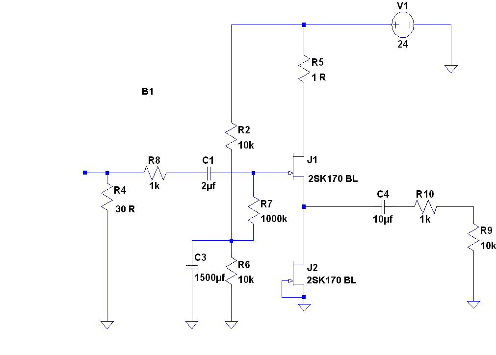

Hello -ecdesigns-
I just found a Pass Lab B1 buffer amp ready made board.
If I do a modification (R4) like in my schematic, can I use it as a IV amp for my TDA1541A ?
Do I need more modifications and which ones ?
Thank you

Hi koldby,
It is in the signal path like elco's in the power supply, but the cap is bypassed by a relatively low resistor value. This improves performance compared to only a cap in the signal path.
The 3 resistor I2S attenuator has proven its effectivity. For BCK I added a RF Schottky diode to split-up the transients in zones with different speed. This enables both, extreme low jitter levels (low ground-bounce) and fast transient within the trigger zone.
Digital scopes have limited resolution (A/D converter), so signals are "forced" to fit in the few pixels on the LCD. This prevents accurate analysis of wave form shape. If you want to observe signals in more detail you will need a suitable large bandwidth analogue scope.
If you -have- to use passive I/V conversion with the I/V resistor tied to GND you have to add a super clean +2mA bias current. This is necessary to create equal signal swing around GND and thus maximise output signal swing with given -25mV and +25mV output compliance.
CCS usually cause problems with perceived sound quality in these applications. If you -have- to use a CCS, then I suggest to use the Aikido circuit where issues with non-linear properties of active elements are largely canceled out. The Aikido circuit can also be translated to JFETs, but I personally prefer the tube version.

-ecdesigns-
I have been using the original I2S attenuator on "The Red Baron Dac" and my Audio Widget usb to I2S is 3,3 V logic so I was forced to have a buffer to increase to 5 V I2S.
Therefor I was planning to replace buffer + attenuator with the suggested buffer as a better way?
Maybe the original solution is better, time will tell.
Thanks for your reply.
Koldby

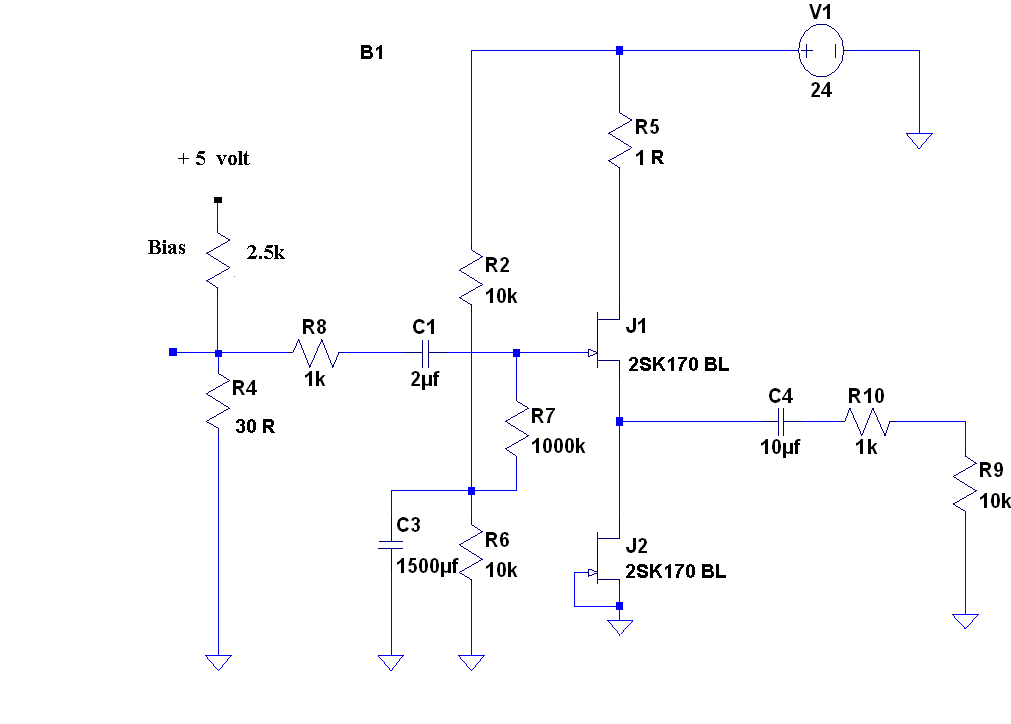

Hello
So I just use a 2.5k resistor between 1541 output and the +5 volt, like in my image ?
