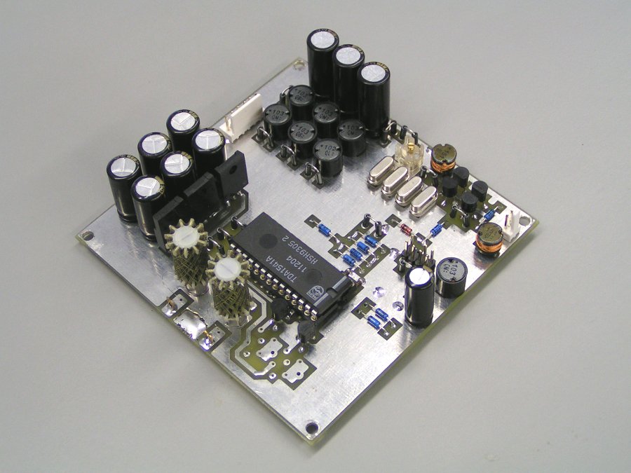

I attached some photographs of this new module.
First photograph shows the component side. The 14 TDA1541A SMD film decoupling caps (1206 size) are located underneath the chip like with the previous design.
I used plain voltage regulators plus LC filtering, did some tests with shunt regs like TL431 but sound appeared to be less accurate. Anyway, separate shunt regulator modules can be used instead of the voltage regulators if required.
I/V resistors are moved away from the masterclock in order to minimize crosstalk with 11.2896 MHz.
Schottky diodes are used for DJA circuits, DEM synchronizer and BCK/WS attenuators.
The two selected JFETs (near I/V resistors) are used as current buffers. gate is tied to GND, so both, reference voltages and reference voltage filters could be removed. Interference from these reference voltages is now eliminated. The JFETs are selected for low Ugs in order to meet +/-25mV DC output compliance.
There is room for 4 optional JFETs that form unity gain buffers to isolate passive I/V resistor from external loads.
4-crystal masterclock is now integrated on the PCB, simplifying design. I added a DJA circuit between masterclock and BCK reclocker. The masterclock can be set to exactly 11.28960 MHz with a trimmer.

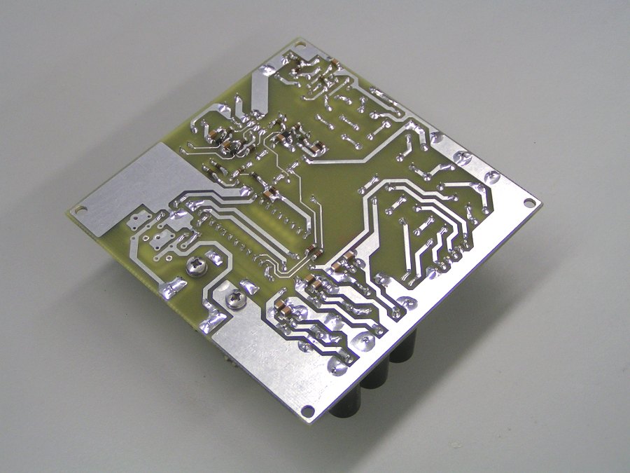

Second photograph shows the solder side. Here I put most of the SMD parts like resistors and decoupling caps. I used fastest available (5V) D flip-flop for BCK reclocking and driving the balanced DEM synchronizer.
The BCK D flip-flop is a tiny US8 size flip-flop with balanced outputs (Q /Q). Both WS and DATA are also synchronously reclocked using 2 more miniature SMD D flip-flops.

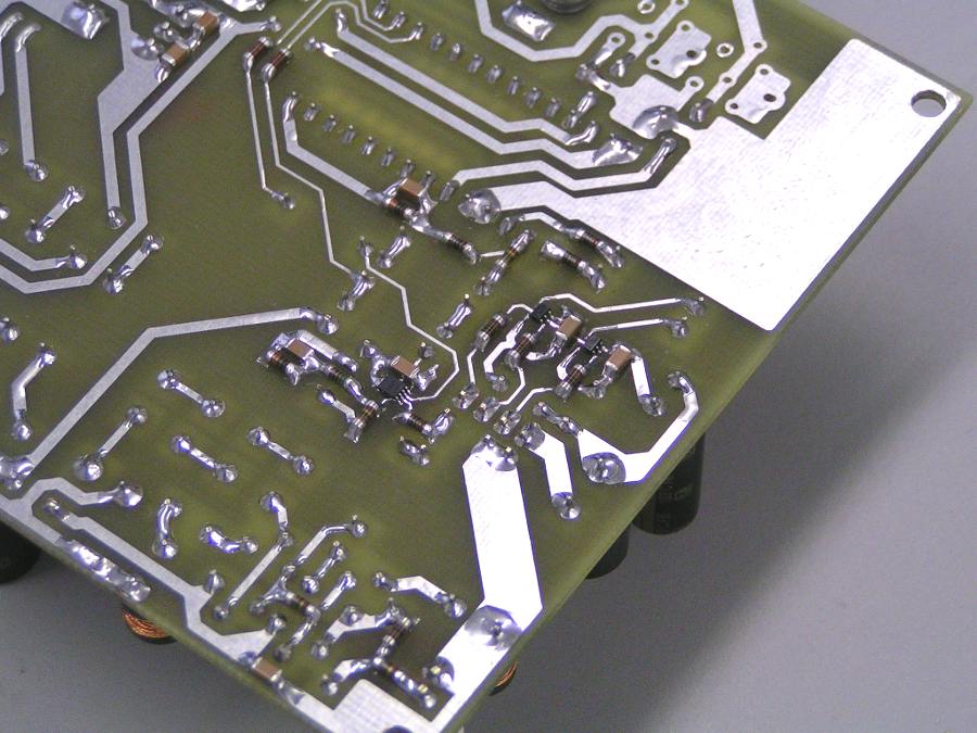

Third photograph shows a close-up of the tiny D flip-flops. It takes a steady hand and magnifying glass to solder these. The BCK D flip-flop measures approx. 2 x 3mm including the 8 terminals.

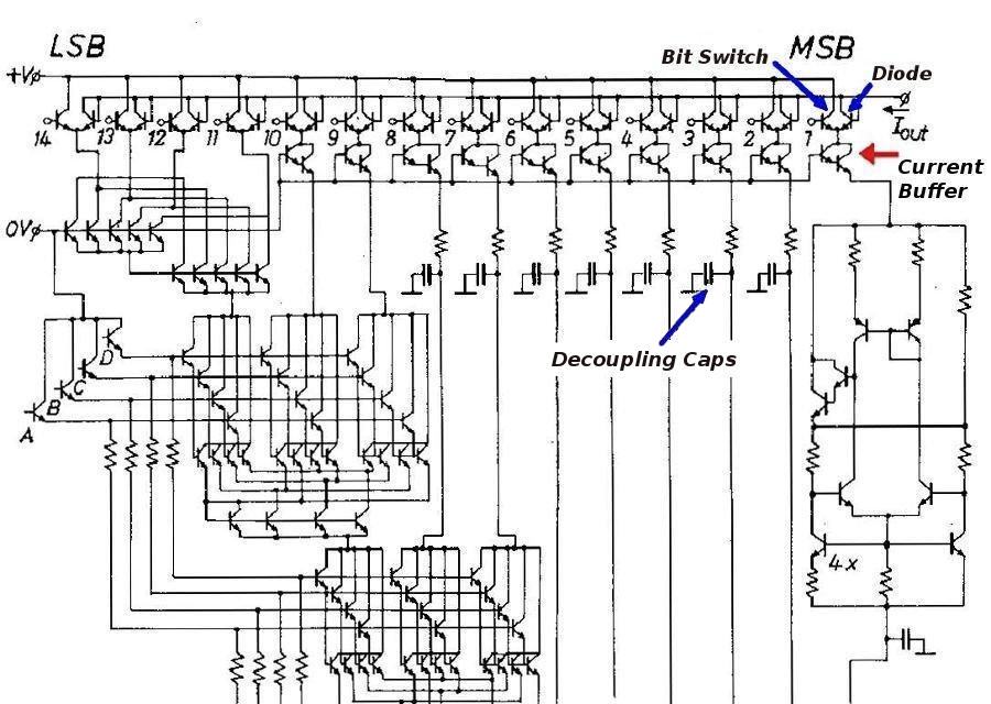

Hi Bernhard,
A passive I/V with a JFET is no passive I/V anymore.
I attached part of TDA1541A schematics.
I marked bit switch, diode and current buffer. Bit currents from 10 MSBs are buffered using on-chip current buffers (marked with red arrow). Buffered current is either routed to +5V (diode conducts / bit is not used), or to the output (bit switch transistor conducts, diode does not conduct).
What I did is simply add another external current buffer that presents a low impedance to the DAC output (compliance) and provides an output that's no longer limited by DAC output compliance. I used a single selected JFET for this. The JFET gate current is specified at 1nA, LSB bit current equals 61nA. So DAC output current is simply passed by this JFET current buffer.
Actual I/V conversion takes place in a 500R passive I/V resistor. Big difference with most passive I/V converters for TDA1541A is that this one generates 2Vpp directly across the I/V resistor with no need for active amplification. This keeps noise levels down and provides required large bandwidth to cope with TDA1541A output spectrum.

Hello EC, is your new JFET approach much better than this schematic also posted by you?
Perceived sound quality has improved a lot. There is less "stress" in the sound and sound is smoother / cleaner.
The filtered reference voltage is no longer needed as the JFET gate (current buffer) now connects to GND. The DC voltage on the TDA1541A output was trimmed by using selected JFETs.
The JFET gate current is specified at 1nA, this is much lower compared to LSB bit current of 61nA. So the JFET simply passes the DAC current without adding significant drive current like with the Darlington circuit. JFET property is the ability to conduct current without applying drive voltage (Ugs = 0V).

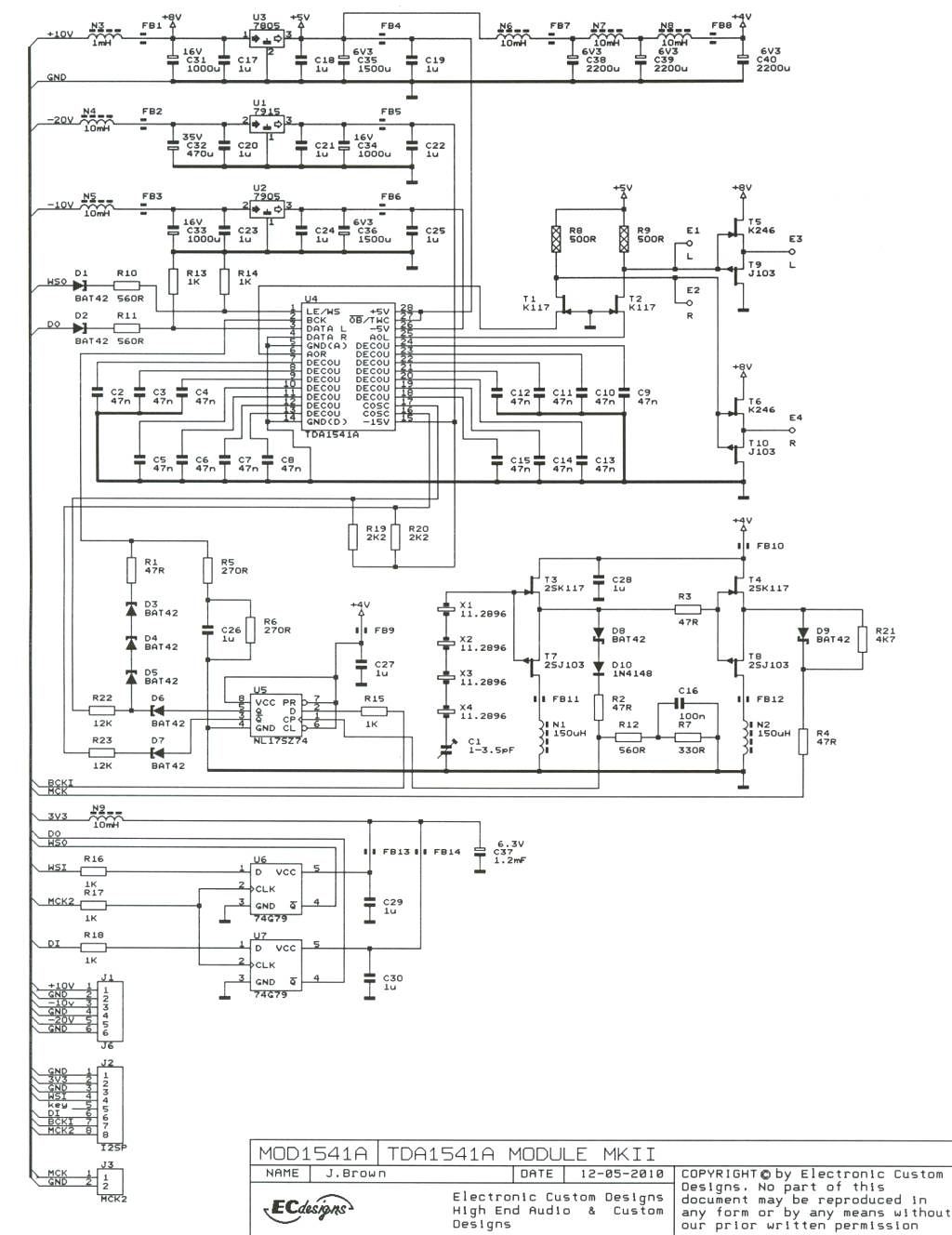

TDA1541A-MK2 module schematics.
Hi Sandor,
it would be very nice to have a look at the schematic of this new version of the TDA1541 based dac.
I attached TDA1541A-MK2 module full schematics (non-commercial use only).
+10V, -10V, and -20V outputs from the capacitance multipliers on the power supply module are LC filtered (N3 .. N5, FB1 ... FB3, C31 ... C33, C17, C20, C23). Voltage regulators are used to derive +5V, -5V, and -15V. Voltage regulator outputs are connected to large value electrolytic caps (C34 ... C36) to attenuate regulator noise. LC filters (FB4 ... FB6, C19, C22, C25) are used for extra filtering.
Additional 6th order LC filter (N6 ... N8, FB7, FB8, C38 ... C40) is used for master clock, clock buffer and bit reclocker. The DC resistance of chokes N6 ... N8 (approx. 60 Ohms in total) together with the connected loads result in approx. 4V output voltage. I used no regulators after this filter to keep noise levels down.
The 4-crystal master clock consists of X1 ... X4, C1, T3, T7, FB11, N1. T3 and T7 form a unity gain complementary buffer. Crystals are driven through combined gs capacitance of both JFETs. Phase shift is accomplished using choke N1. Output swings between -4V and +4V (8Vpp). Clock buffer (T4, T8, FB12, N2) is connected through R3. Source is driven through clock rectifier D9, R21, R4.
Bit reclocker (U5) is clocked through DJA1 (D8, D10, R2, R7, R12, C16), the DJA also acts as clock rectifier. Bit reclocker output is balanced (Q /Q). The Q output drives DJA2 (D3 ... D6, R1, R5, R6, C26). DJA2 drives the TDA1541A clock input.
The balanced output of DJA2 drives the DEM synchronizer (D6, D7, R22, R23, R19, R20). The DEM synchronizer drives the DEM oscillator through pin 16 and 17. Bit clock equals DEM clock (1.4112 MHz).
Decoupling caps (C2 ... C15) are 1206 size PPS SMD film caps with stacked construction (low inductance) and high insulation resistance (>3000 M Ohm).
Both WS and DATA are synchronously reclocked (U6 and U7) and fed to the TDA1541A using attenuators (D1, D2, R10, R11, R13, R14). These reclockers are powered by 3.3V and clocked with buffered 5.6448 MHz from the SD-transport.
TDA1541A output currents enter JFET current buffers T1 and T2 that pass the DAC current to passive I/V resistors R8 and R9. The JFET current buffers are required to meet DAC output compliance. The current buffer JFETs need to have high Yfs and need to be selected for lowest voltage on the DAC outputs. Gate current equals approx. 1nA while LSB current equals approx. 61nA.
Amplitude across 500 Ohm passive I/V resistors equals 2Vpp. This signal can be buffered (T5, T6, T9, T10) using optional complementary unity gain JFET buffers.
