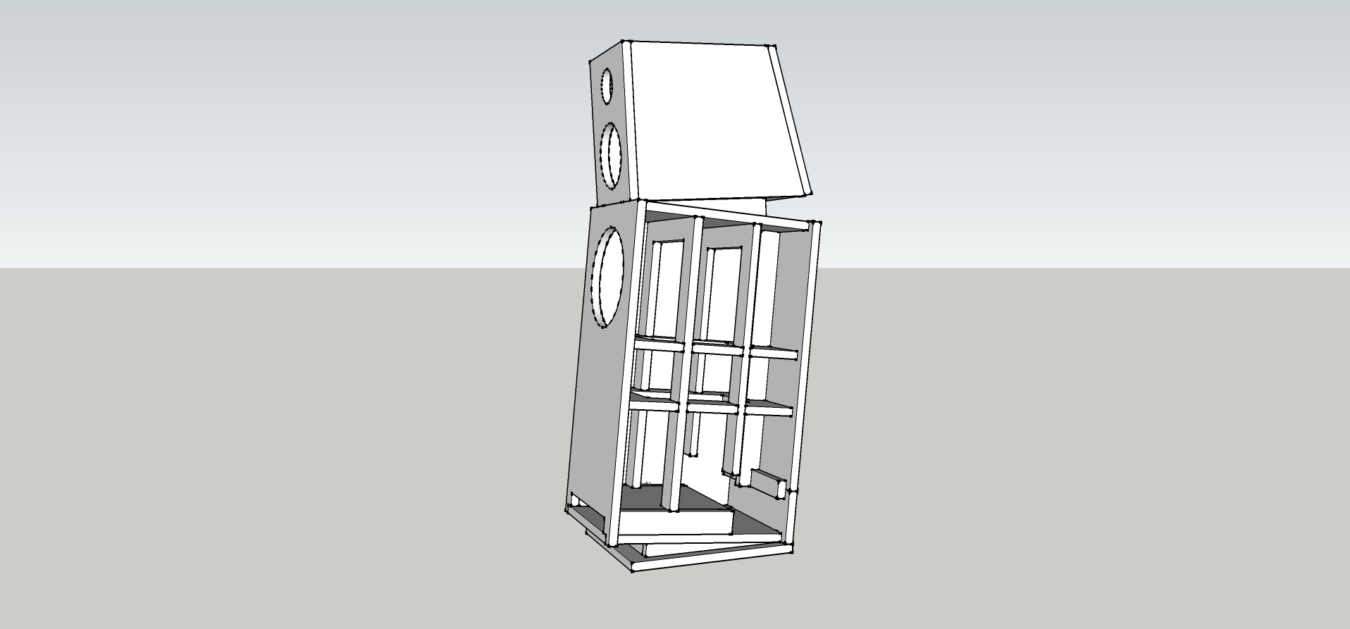

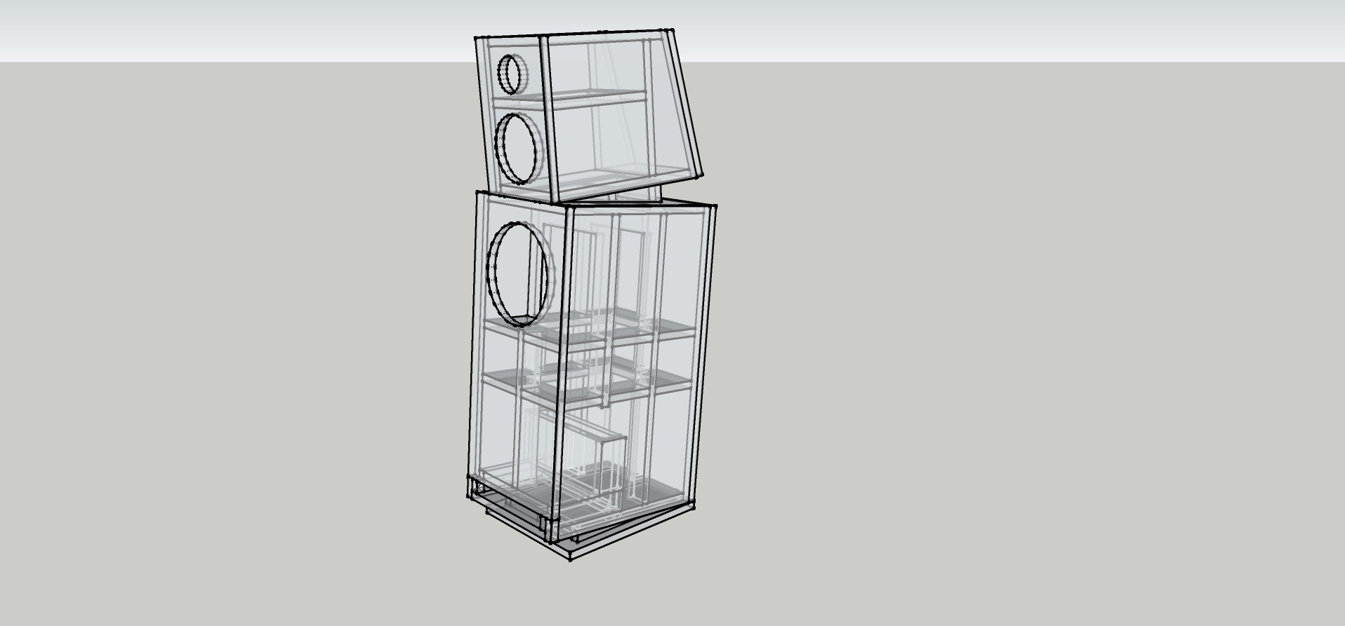

i have been to a lumber provider and i have checked out materials. i will finally use 19mm MDF, and veneer it.
i have prepared a cut sheet for them.. since their saws are computer controlled its going to be very cheap to get most of the pieces cut to size.. still a lot of minor sawing and cutting to do for me so i wont get bored..
i simplified the bracing and various other things. im getting a lot more work in real life and i will not have as much sparetime as estimated. anyway - the design itself still will look more or less the same.
changed the port location to have a 90º angle to the cabinet, since having the vent in the stand mean i would ahve needed to cut a big slot with exact angle, and this can be done by hand but it will be time consuming so i selected to avoid it.
the stands that are leaning the speakers will be done last, they will be detachable.
attachment.php
anyway - i might make more changes..
Using rods (broomsticks!) or strips of plywood on opposite walls is even more simple than the labour you'll end up with when picking the suggested braces. And I wouldn't bother to create a tuneable slot. Most if not all reflex constructions I have established ended up within 5% of the targeted resonance frequency, just by calculating by hand or using the software available on the net. And 5% is far more accurate than the tuning in your listening room will require.
good points. i wonder if you are commenting on the earlier sketches or the last one?
i already decided skipping the tuning part - this is why in the sketch above there is no parts to extend the vent.
the braces in the first sketches were too time consuming to build by hand (only the measuring and drawing would take weeks...), so to save time i have updated the bracing to something more normal and faster to make :)

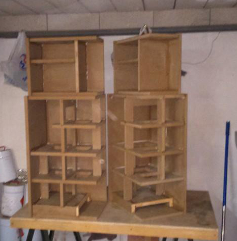

the boxes were faster to build than i thought. i wont cut out the holes for the speakers until i have received them..
i have also built a 16 unit rack for the gear for the soundsystem.
the coming week i will order the woofers etc + crossover components and eggcrate foam, polyfill and everything else...
thanks all who have helped this far with tips :D i owe you guys a beer!
