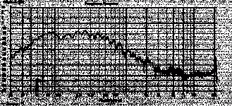

it is not that frequency of 400Hz that will trouble your plans. that driver is not easy to tame as i said already.
it has nasty hump between 70 and 100Hz and right afterwards huge trench.
here is the graph without Xover and with some attempts with test Xover (3.3mH+68uF+5E6, then 2.2mH+150uF+3E9)
didn't have larger coils for more tests
box was approx. the same size as Carmody's
second pic is the first one, sorry
ground bounce effect?
change distance to ground ( flip sub upside down ) plus perhaps measure closer
gated measurements can help
mic, driver and box were aligned on some 3 or 4ft above floor.
830866 driver is the cheap crappy one. Carmody cut it with 6mH coil if I remember well.
I doubt 400Hz is the happy road for this driver. one can trust it to play below 150 or even less Hz. It means few lbs of copper in coil for air winded coils.
