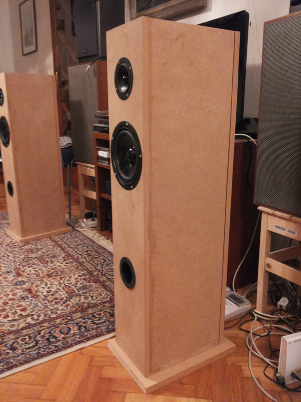

Gated measurements on 100-ish Hz frequencies require almost free field conditions, that's no option here. I agree on the ground bounce or any other first reflection that screwed up that measurement. In a normal living room, measure in box or close to the cone and port. When a large hall is available, use ground plane technique.
it was measured proper way and results were not screwed up. there was no ground or any other first reflection messing up these results. sad fact is that driver is cheap, hard to tame.
I bought pair of these from an guy who tried to play them in his construction of ported box and failed. I tried to use them too AND in sealed box and I failed in that too.
So looking forward to see what will come out. My sincere guess was to use really big BIG coils but money went in other direction
namely this but that is another story off topic here

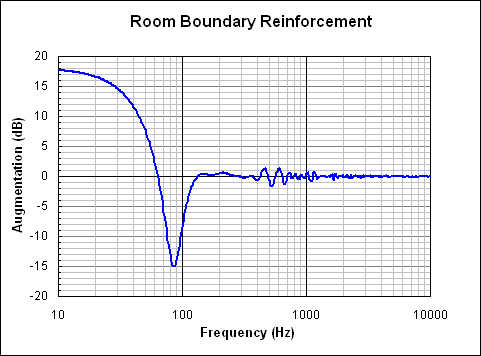

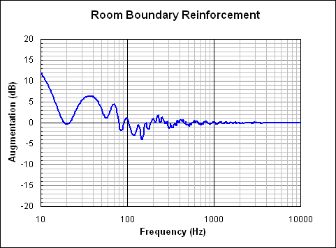

The room boundary reinforcement, axial response:
3 ft above floor
4 ft from rear wall
4 ft from side wall
Response varies very much depending on the speaker placement
in respect to boundaries.
Courtesy of Jeff Bagby, Diffraction and boundary simulator.

Ok, let's assume you room was 5,5*5,5 m.
You were complaining about the 70Hz something range hump
and dip that follows it. Now, see if this has anything to do with
the point in room you were taking the measurement.
1st graph: 3ft from the floor,18 ft (5,5m)from side and rear wall.
2nd graph: 10" from the floor, 18 ft from side and rear wall.
Loudspeaker building is not only science.
Loudspeaker building is applied science at things we like
to keep in our homes. People will always have issues building
stuff. That's where diyAudio comes in to straighten it out.

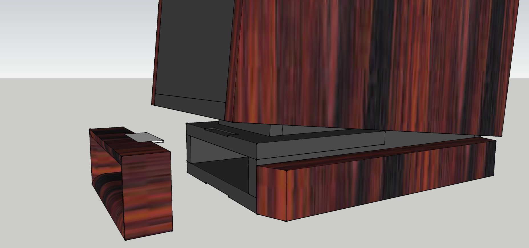

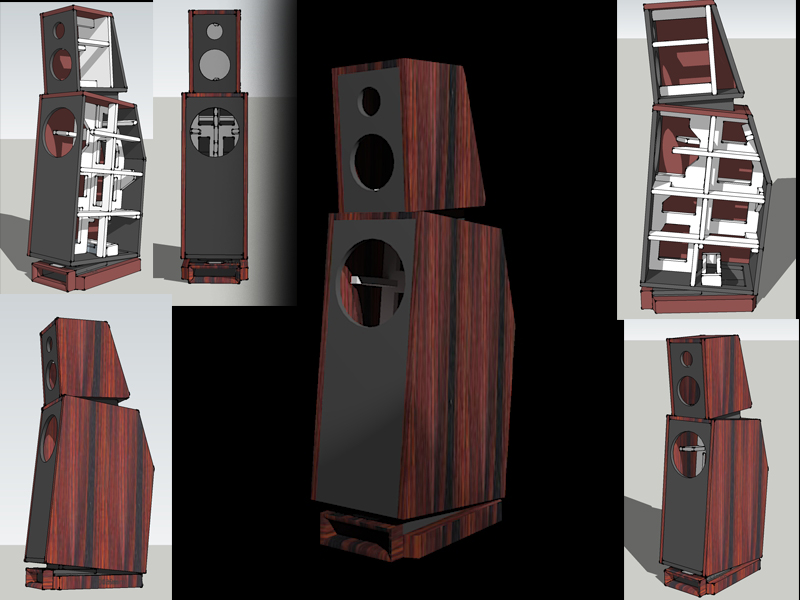

a few changes to the design.
tuneable vent - the outlet of the vent and also the inlet (inside) are designed to have 1 additional piece with interlocking metal plates that fits into a groove
if i decide to have access to the inside i will leave an air proof maintenance entrance in the back.
if not i will do the tuning with the addition in the outlet.
at first i will use duct-tape to air-proof the addition, and once down to to final size i'll most likely glue it into place. if needed i can easilly make several pieces of varying lengths etc. the final endpiece will be done most likelly in hardwood.

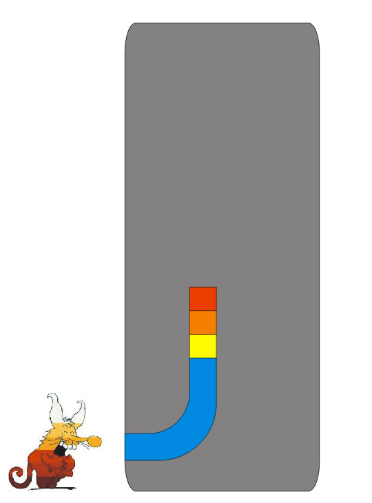

Looking nice, will you be making slot extensions something like this?
yes, u got it 🙂 most likelly both inside and on the outside. after plotting the volume of the cab tuned at different differences i see the interval of increments in cm is about 2,80 for 29hz an aditional 3.2 and so on. i will later have a closer look when it is time.
flared ports - i read i should measure about the first 1/3rd of the rounded part as part of the vent...

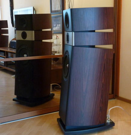

What is the motivation for tilting the cabinets?
The mid/tweeter cabinet appears to be tilted forward rather than the more usual vertical or backwards to help align the tweeter and midrange acoustical centres. Is the tilting accounted for in the crossover or is it small enough not to matter?
i dont know your experience with studio monitors, but they are usually tilted slightly forwards standing ontop of foam decoupling pads. this is since if they are higher up the sweet spot for the mixing also moves up so the tilting brings the focus back to the listener position.
same idea is aplied here. the inclinatin of the tweeter is only 3 degrees from vertical, but the tilt of the woofer section makes it look more severe. its fooling the eye a bit since the woofer is leaning back 6º and the TM is tilted 9 degrees in relation to the woofer but in reality as stated before it is only 3º. both the woofer and the TM are sill in same line. in depth the Mid is about 4mm behind the line of the tweeter woofer. but ONLY if i would be standing up to listen to them, if i sit down they are aligned.
the woofer is aimed at the listener position more or less, the focal point is at 3,5-4 meters at about 90cm heigth - perfect for leaning back on the sofa.
i will make the top part tilt adjustable. i want to be able to to put it to vertical position, or even lean it forward a few more degrees - if i need to.
also adding wheels to the base will add a few more cm of heigth.
also if the design turns out be a flaw it has an easy solution. i can tilt the woofer cabinet forward to vertical position using 2 rubber pads in the back of the stand and just put the tm box back in vertidal.
I am still not clear why you are tilting the woofer cabinet. I would not expect it to have any adverse affect but I cannot see any benefit either unless you consider it to be more attractive?
