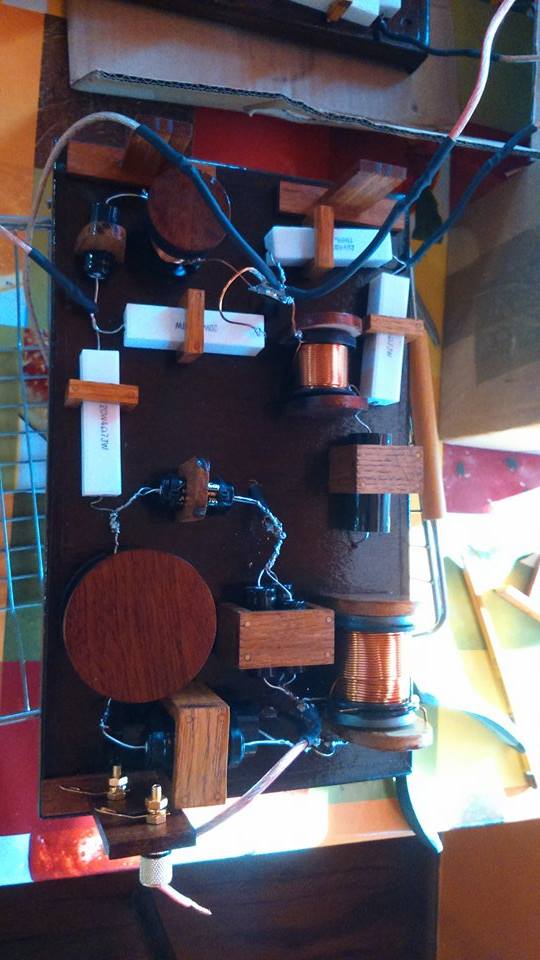

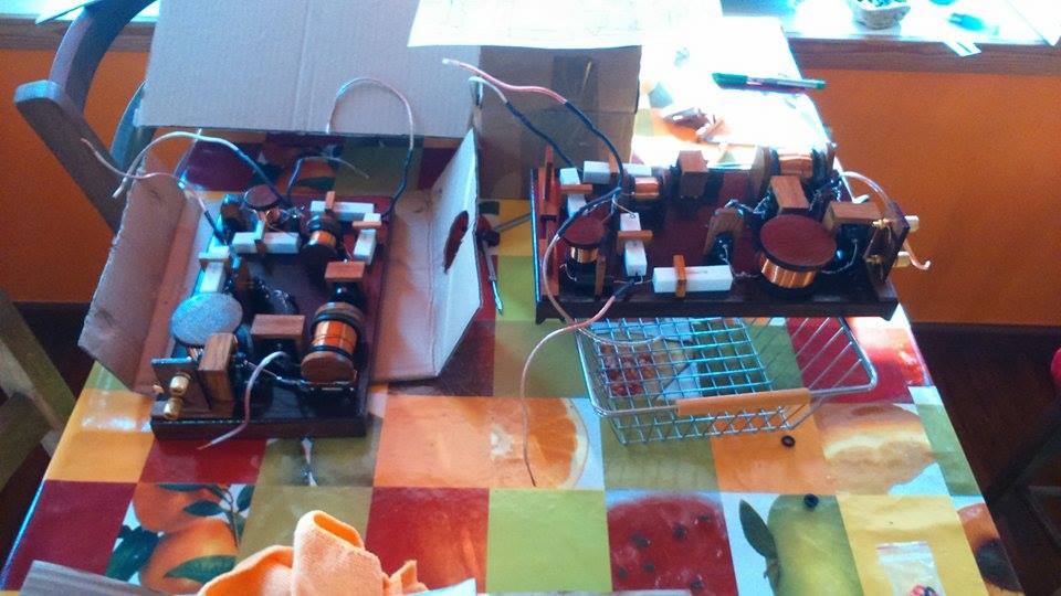

the crossover is almost done. i need to get a few more connectors before i can wrap it up.
the wooden pieces are dry fitted, i have not glued anything yet - first i will finish it, make sure it works, and then ill glue it up 🙂 but still all the joints are so snug i have to make sure not to push the holders to the bottom, to make sure i can pull them out when needed. i used oak and mahogany mostly and beech and bamboo for the joints. i will also put a bit of heat resistant glue under the components when i glue the holders to make sure they stay as i want them to...

ive been doing the interiors (foam on the walls + cabling) of the tarkus bass speaker during the weekend, and i also finished the top/mid boxes entirely. im waiting for a few connectors i need to finish the crossovers, and im almost good to go..

first the crossover with its last minute changes to the layout of the connectors. i think like this it looks cleaner.
