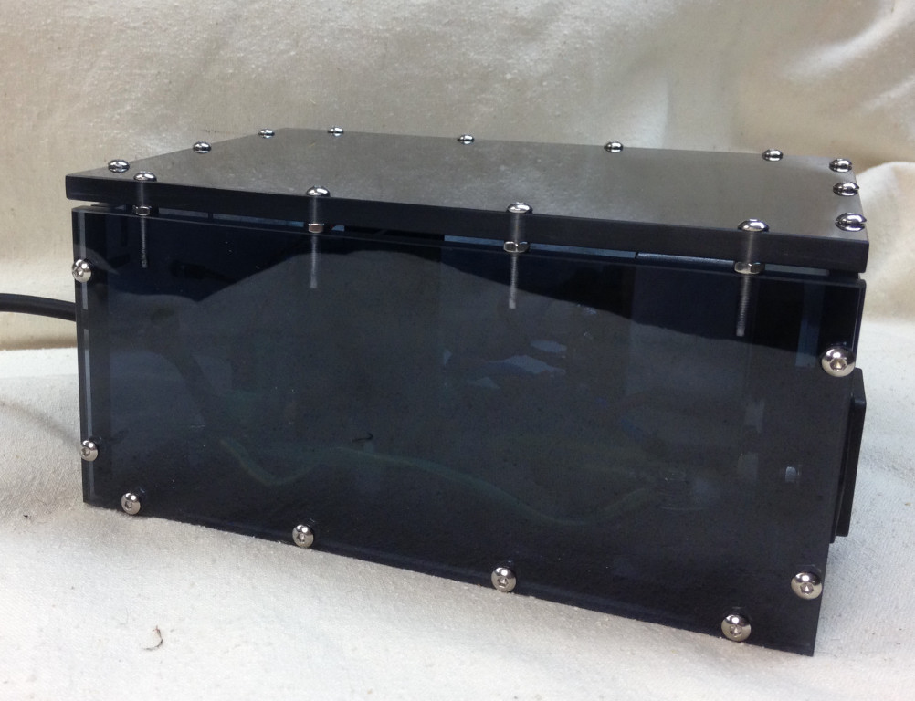

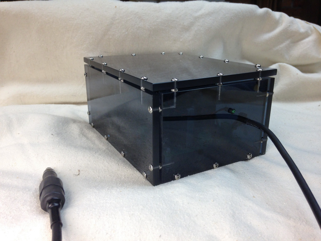

I had the Polycarb laying around so I thought I'd use that.

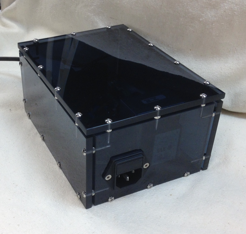

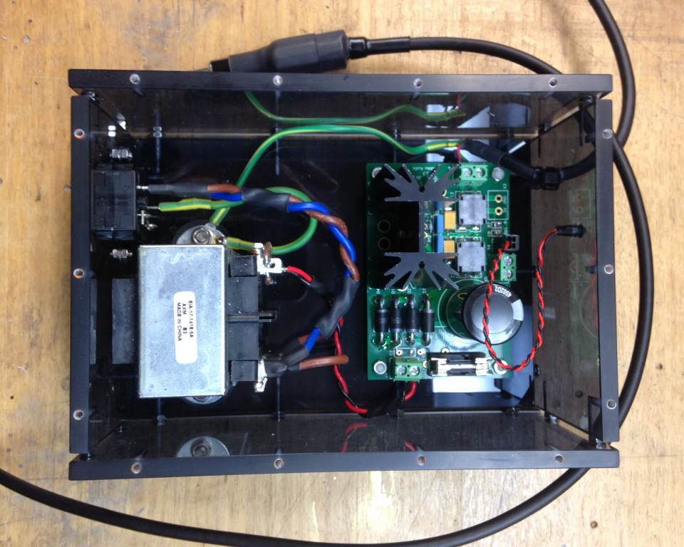

My PSU
Transformer is not fastened yet.
Does the transformer actually need to be grounded/connected to PE ?
(core is glued, no ground connection screw on it - no problem so far in testing)

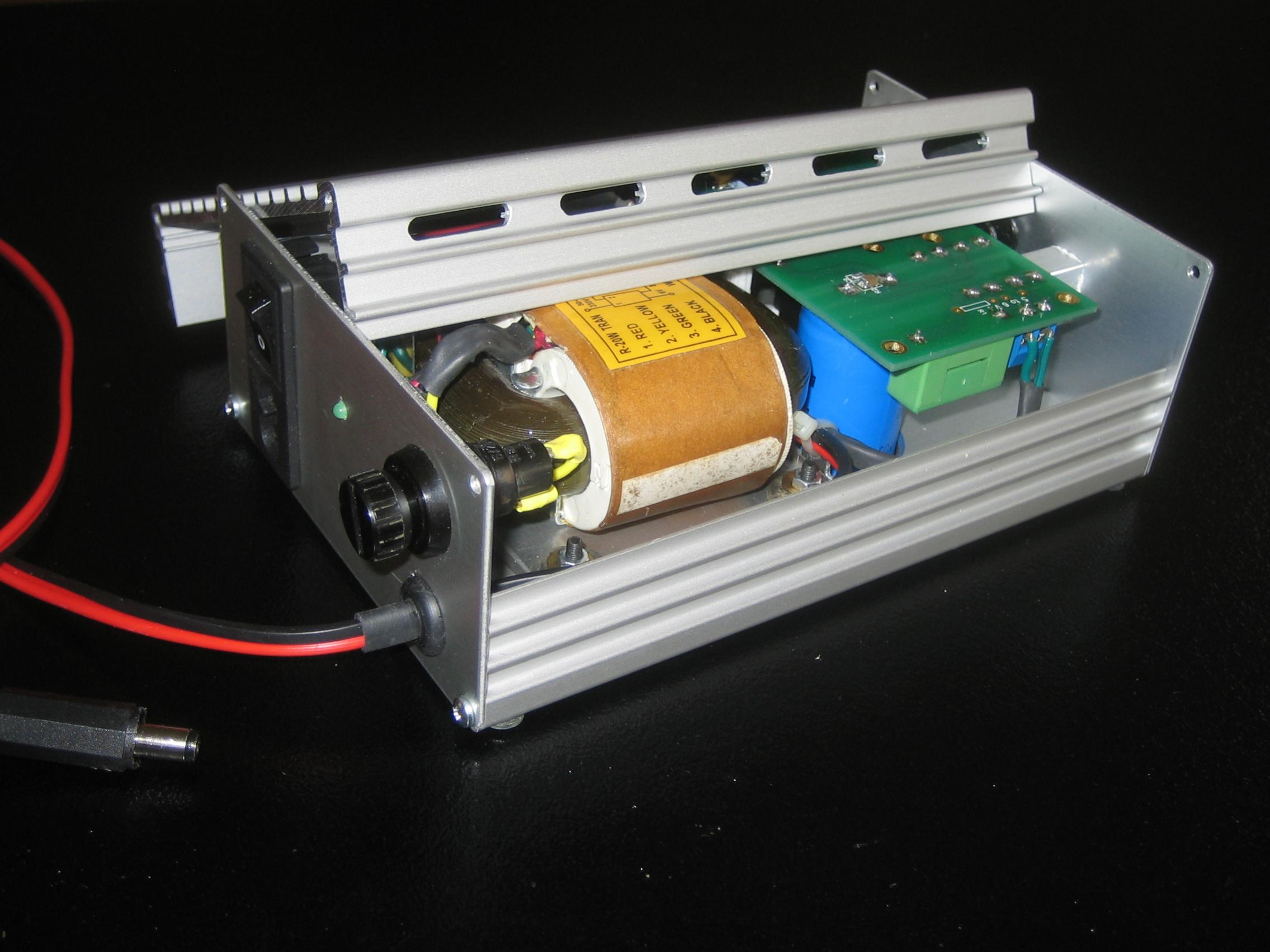

With the Nomex in place
backside
with cover
I have reused the chassi and some parts of an old medical power supply.
BR
Pilsern
backside
with cover
BR
Pilsern
The Nomex will hamper the working of the heatsink severely that way. Please change that to avoid overheating etc. Shorter standoffs for instance.
*Regarding PE: I would connect the case to PE but not GND to PE. So the case connected to PE for safety, just like it is now. The transformers frame will connect to PE to when you use one of those special washers (don't know their name) that cut through the paint and touch the metal. PE regulations may differ in some countries but I like it best this way for audio devices.
Is that the case of a medical isolation transformer ? I use one of those to have a floating mains supply with good results.
Will cut down a bit on the Nomex, though the heatsink did not get particularly hot during test period - lots of holes in the chassi for cooling.
My chassi is low so the transformer must lie down - I don't want screw-holes on the front so my plan was to glue it to the chassi.
Pilsern
Well that make sense, I fell asleep at the wheel 🙂
Nice looking enclosure. I like the way you spaced out the polycarb for cooling slots. If you close it up, run it for a while, then check the heatsink, does it stay pretty cool that way?

It's such a pain in the bum to pull apart I dont think I'll be doing that testing sorry 🙂
The design evolved as I was making it, I had cut most of the bits except for the top, and I was pondering how to ventilate it then this idea struck me, all good except I had to go out & buy some longer screws & as I say it's time consuming to pull apart.
Seems to be working well but ATM it's only connected to the garage system for a run in, proper testing later on.
DQ828,
Looking a bit closer. Is that your output minus wire running to the base of the transformer? If so, it may give you some hum. I would have thought running it to the minus connection (GND on the board) in the output junction block would be better.

No it's the cable shield, the output minus is very hard to see but it is there.

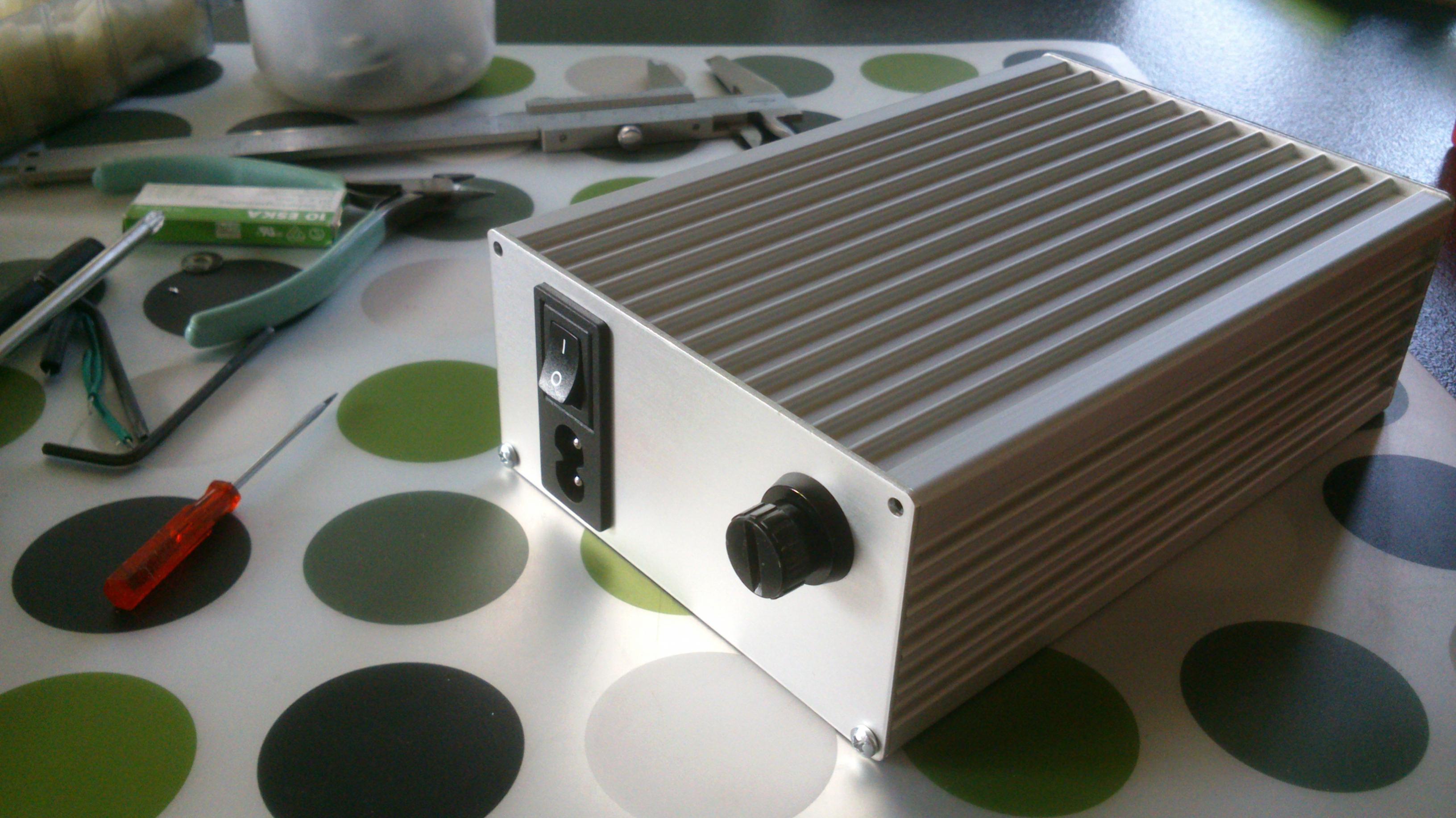

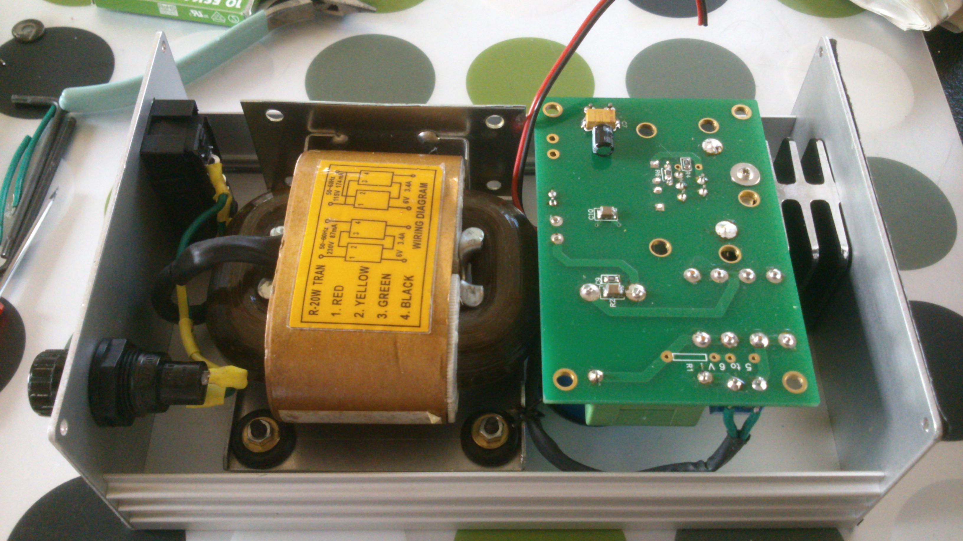

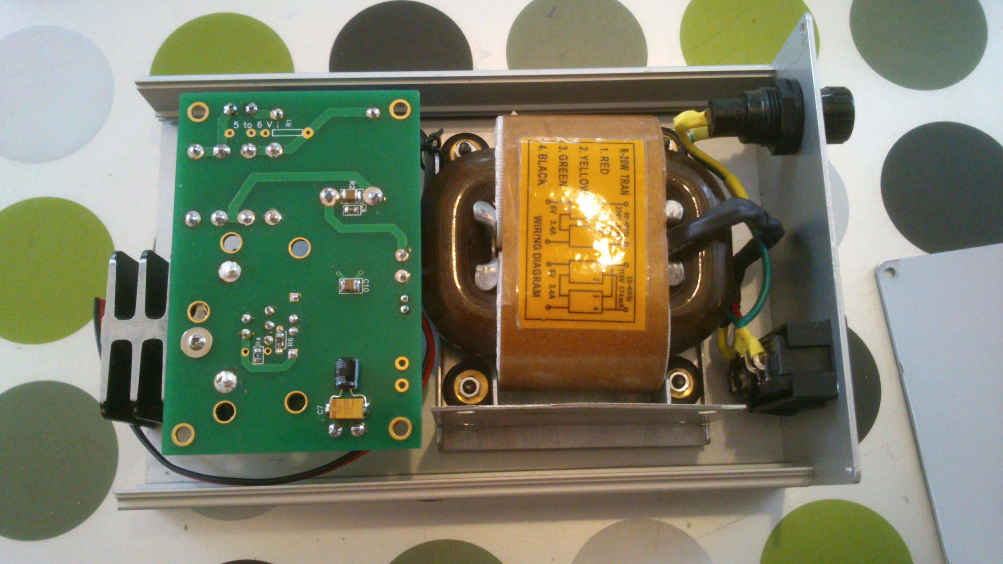

My SBT PSU

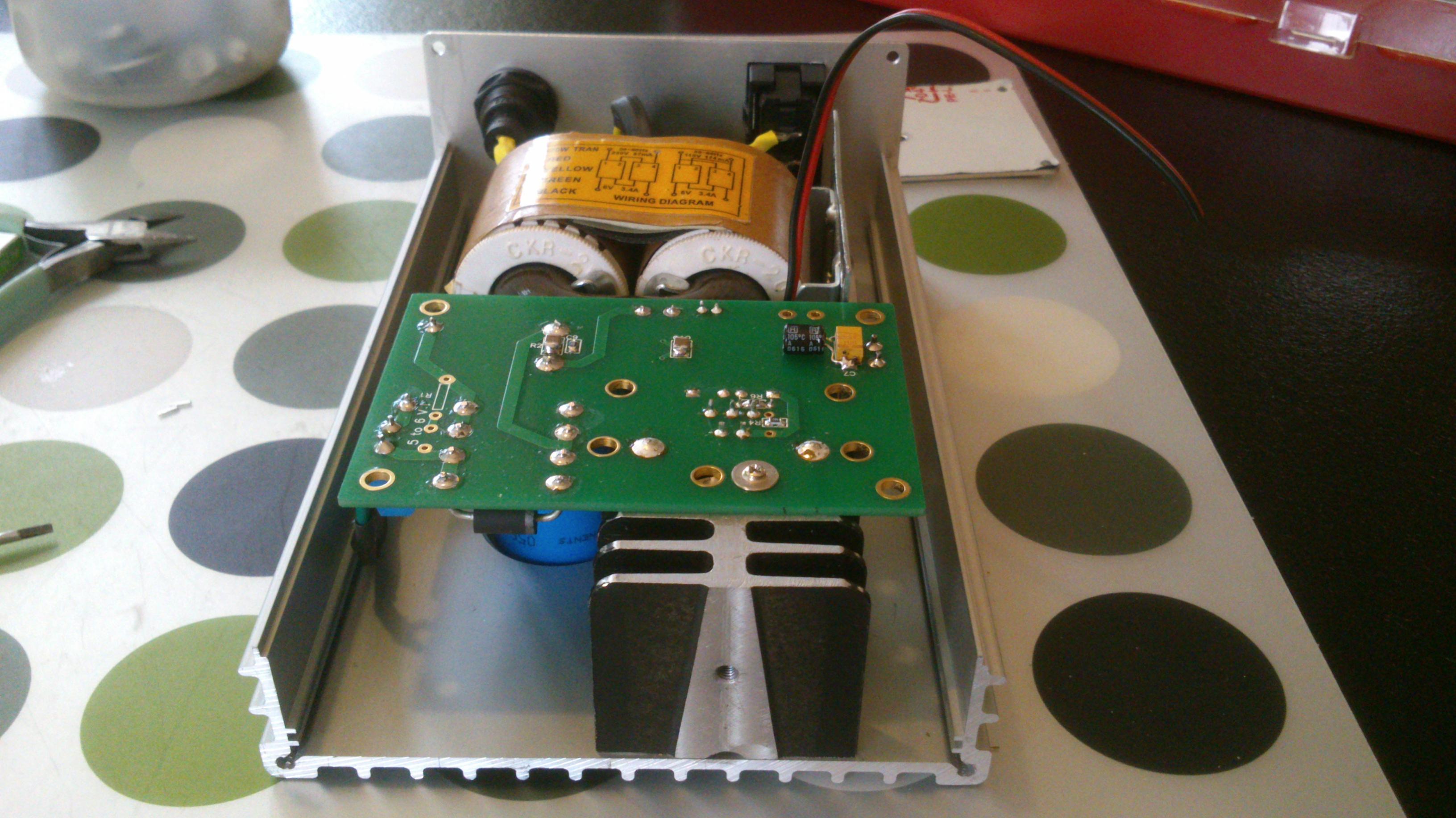

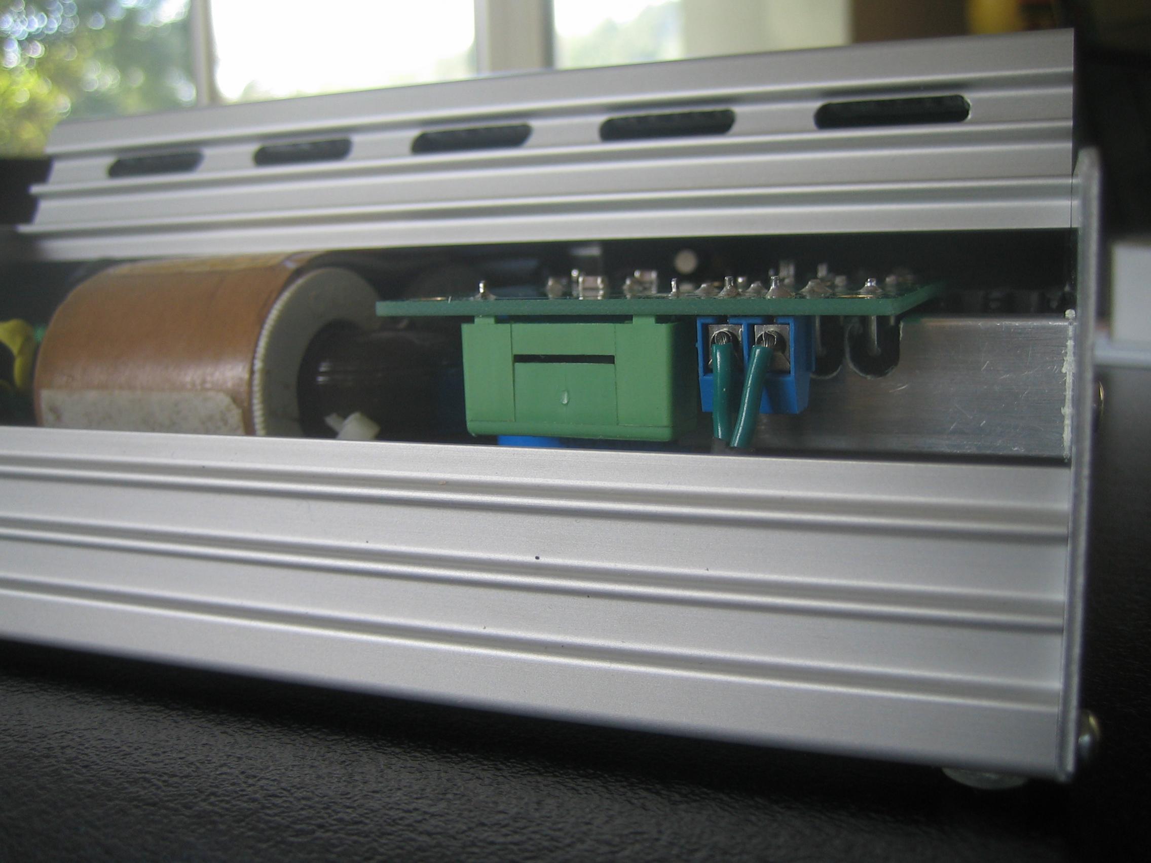

Here pics of my build. The box is from Conrad also the big cap. Helas a little to big but with a hole in the bottom it fits.
The transformer is on a subframe. The heatsink is adjusted to fit on the bottom and side of the box to make thermal contact. The box is working now for a couple of days and stays very cool. The DC-power connection is a Lumberg 2,5mm and no contact problems.
Difficult to compare with the standard PSU . I tested with a resistor for 2,5A load and no problems found, very small voltage reduction from 5.04 to 4,98V.

OK, nice build but I would secure the board with at least 2 standoffs. Are you sure no contact can be made with the top cover ? It would make sense to add some ventilation in the case itself. It seems most heat will go to the case but it won't hurt to check the internal case temp with a temperature meter probe. BTW the board was meant to be used the ordinary way to allow for cooling of the diodes. I am curious what the extra capacitor at the output does ?!
I know it is difficult to compare as the Touch needs to boot up after switching PSU's and after such a time comparing is hard if not impossible. Only using them in parallel temporarily would be a solution but I did not take the risk. Switched a lot between both, the linear PSU was the better performing one IMO but it would be awkward if I wrote the contrary 😉

finished
Hi Jean-Paul. Thank for your comments.
The box is not a portable device so i think it is ok so.
As you could see the pcb is also fixed with the 2 pins soldered to the heatsink.
And next, the regulator is part of fixation.
Before with a closed box the diode temp was 42 degrees after a day in use.
But in between i made sleeves in bottom and sides for a lower result.
As extra i made a sink for the diodes. Now it stays 32 degrees.
I am happy with the result as it is now.
Regards, Loek
