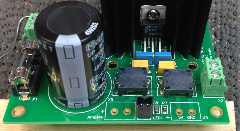

But now it looks like my chassis is a tight fit - heat sink will probably slightly touch my chassis - will this be ok or...trouble ?
I had to source parts from a couple of different suppliers, but now I'm building.
Hi the heatsink is connected to GND. To avoid problems I would insulate the regulator chip.
Thanks for the feedback Jean-Paul,
I did not have thermal paste but I had a thermal pad, so I guess that insulates the regulator chip from the heat sink. To be on the safe side I also placed a sheet of Nomex between the heatsink and chassi.

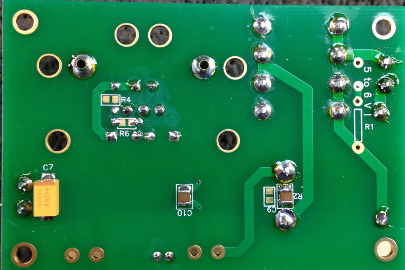

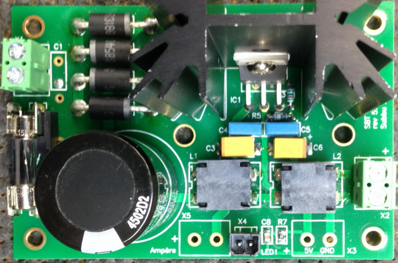

Wont Work
I've obviosuly done something wrong but I'm not sure what it is, I'm hoping someone might be able to see something in the photo's.
I get 8V at the amp meter output but nothing at the 5V output.
Yes 😉
BTW I see you solder first and cut excess lead wire off later. This is less good than cutting first and solder later. You put mechanical stress on joints which is not optimal for reliability. Makes sense when you think about it, costs nothing and makes stuff better. Make the switch !
