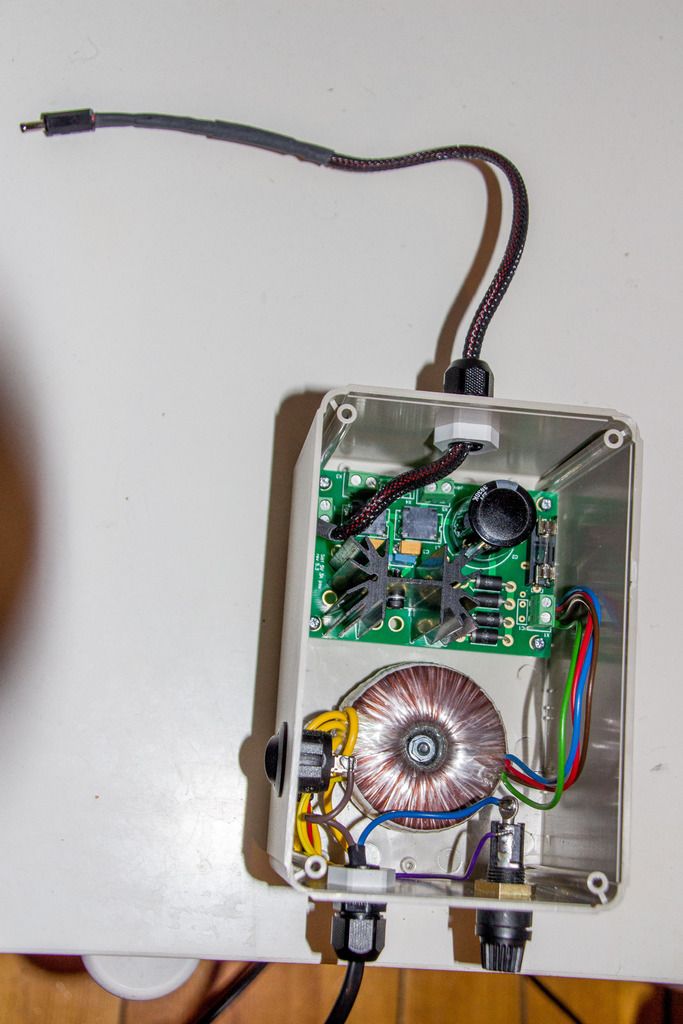

Here is my finnished PSU:
The heatsink does get a little hot during playback.
And it shure doesn´t sound worse than before..🙂
BTW Ryssen, nice build but I have to tell you to insulate the fuse holder at the primary side. It also helps to put the wires in the connector holes of the fuse holder and power switch and bend them a little so they form a "hook" before soldering. It gives a better connection and it is mechanically more sturdy (absolute best would be to use AMP crimping connectors).
Also no power LED which serves a a minimum load to keep the regulator working OK with no SB connected. You could have "wetted" the diodes at the upper side of the board a little with solder but that is just optics. Just telling you 🙂
Is that a 50 mm high heatsink ?
OK, 2 x 9V in parallel. How much voltage does this toroid give in real life with this load ? And how much Ampere flows through the load ? I assume the top cover of the case is perforated or that is has at least some ventilation slots ? You could drill some 5 mm holes in the bottom of the case at the spot where the PCB is located to enhance cooling somewhat. For instance the exact locations where the holes are in the PCB. You will need 4 feet then for the case. As it is a linear regulator it will always be warm but hot is another matter. The heatsink must transfer the dissipated power to the air so optimal natural air flow is necessary (certainly when loaded with a high load and/or large difference between input and output voltage). No fans please.
