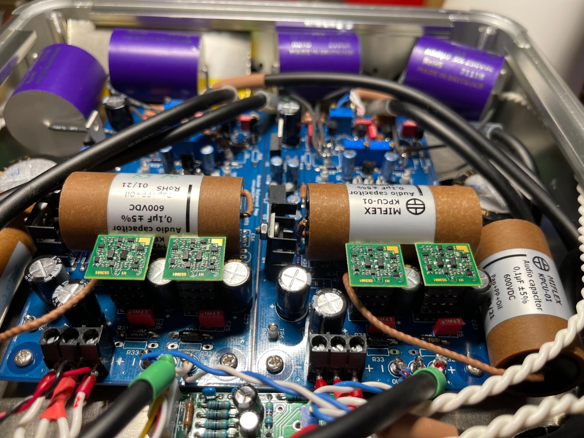

Thanks for tips. I presented my subjective and strictly personal experience based on original BOM in my “wired” two-floors setup. No any upgrades are made yet and plate voltage is also as manual directed equal to +5.4VDC tight for all relevant TPs.
Now, I already ordered Clarity Caps and Miflex caps. So, let’s see how it will sound with these caps installed. During waiting time, I must do something with my 60Hz toroids flux radiation and that junk pickup. That noise is below -95dB, so I can’t hear it even on my very high SPL headphones. But any way, make sense to try to reduce it with all its harmonics.
Later on I’ll also try what Nash did for plate voltages and H2/H3 changes. Ha, I have big plans….
Looks messy with wiring, but functional.
Now, it is day and night difference.
Details are came back and it is very juicy. I can say it is more “meat” in sound now.
I just started to run it 4 hours ago and I listened first time with new Caps now.
Let’s see what would be in a day or two of "burn in" with these Caps.
One question is remained and it is about better SQ substitute for almost obsolete OPA551PA.

Glad to hear that the big caps made a good difference. Do you have space to lift up the PCB enough so as to tuck them under?
Cant say what's better than the OPA551. I thought you were planning on using it primarily as a line stage wwith the Jfets you had on previously?

No, I do not have any space to place these Caps beneath my amp PCB. Amp PCB is in my second floor when first floor is copied by PSU. Just to remind you: I use 4 UltBIBs PCBs there, means two pairs with +/- outputs and two 25VA toroids.
About your second question: OPA551 choice is related to usage of Low Z headphones. I have 200 Ohm headphones and probably can use classic OPAMPs with way less than 200mA current. Will test several include single discrete units like Sparkos Lab SS3601.
Also, I was naïve and tried to use it for both purposes: as headphone amp and line preamp. I am afraid it is not possible with current configuration.

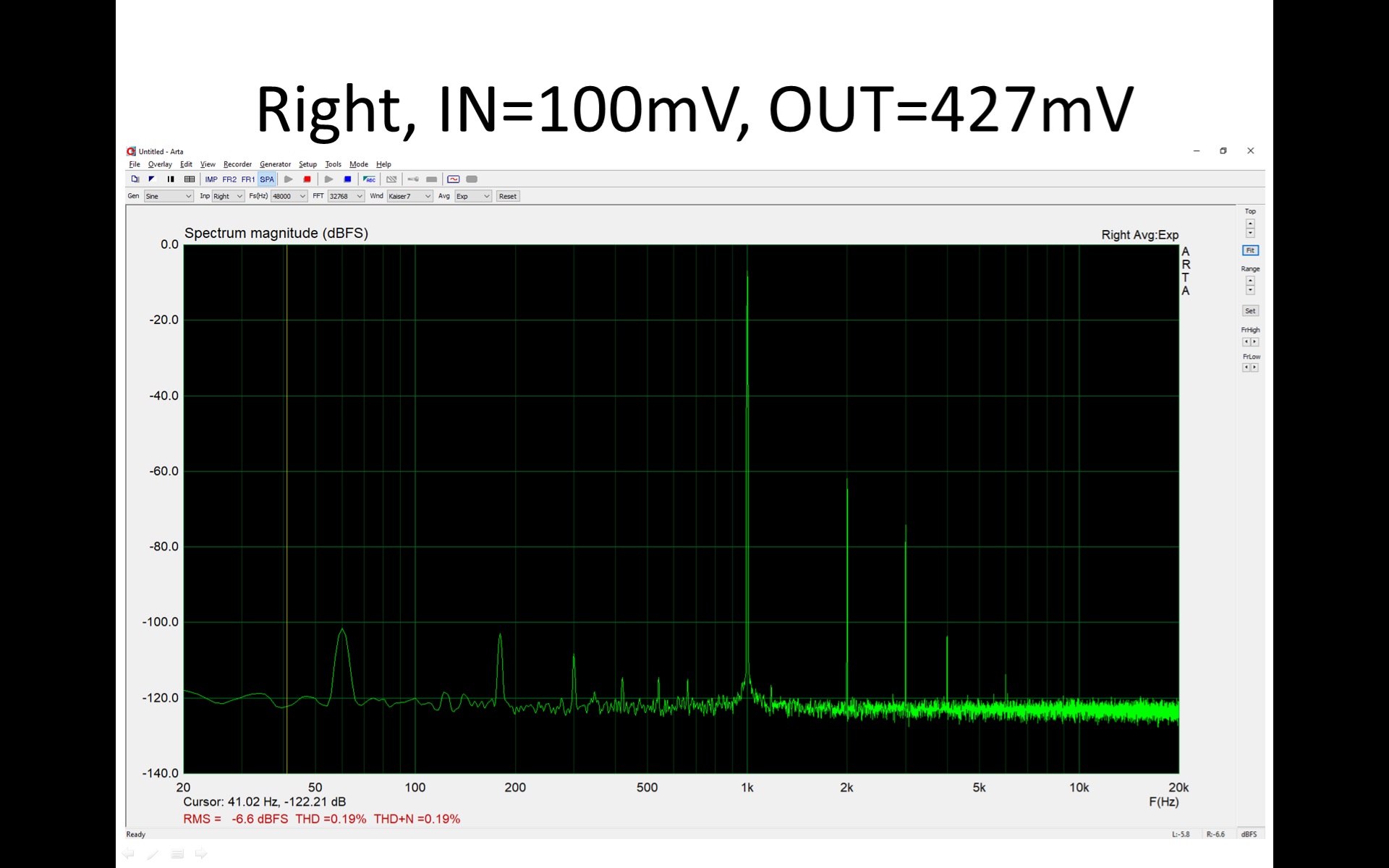

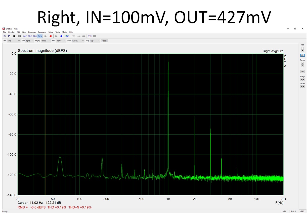

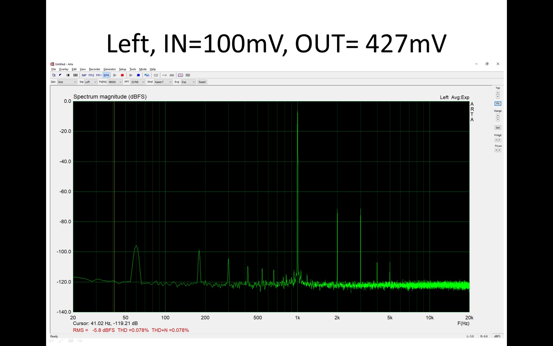

I measured initial FR and H1/2/3s via 100mV (did not go for 1V yet, but assume that situation there will be similar) input and see quite big difference in behave for L vs. R channels for harmonics. No difference for FR.
So, please advise.

I would tweak the bias to get the two channels FFTs a bit more similar. As to whether you like more H2, or less... that is just personal preference. Set it whichever way sounds better to you.
I would aim for harmonics more like the right channel myself.
Pete
Pete

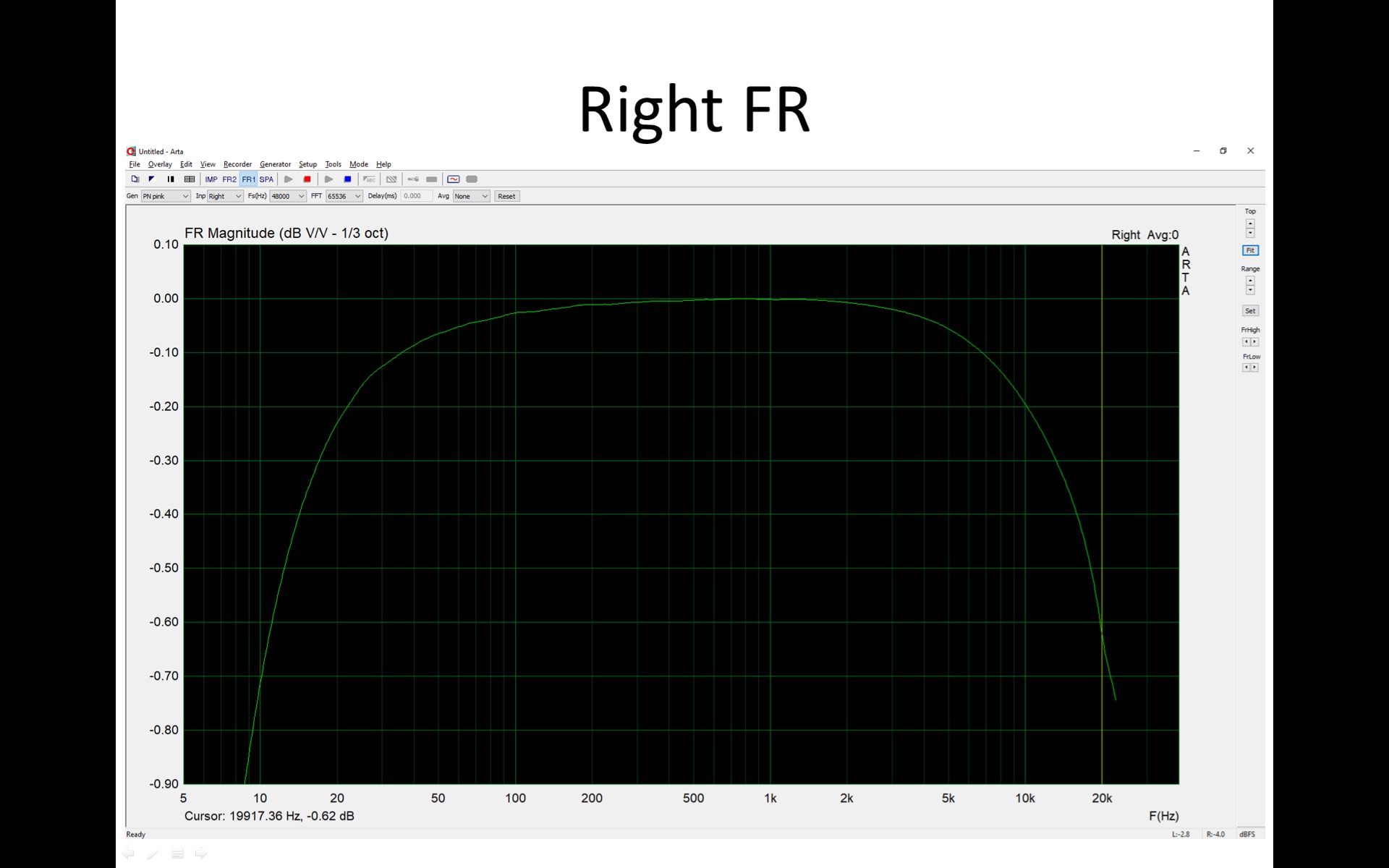

I compared my FR to what I found in your manual and seems it is very close behave, if not the same as you posted there. So, that part is not bothering me.

I set T3/T5 on both channels to be very close to each other. You can see how Hs looks like in attached image. Through 0.25V and 0.5V inputs, outputs Hs signals seems very close to each other too. For 1V in, it is hard to judge harmonics due to too many of them on screen, but again, it's looks close on both channels..
I like how it is sounding now, but I have some question. It seems it is quite shy on highs.
Is any way to add some high frequency by adjusting harmonics?

Reduce the THD shown at 0.4v out from 0.19 to 0.05% and let me know. As PM has said H2 is a matter of taste. See my previous posts with THD as a possible guide. Roughly 0.05%THD at 1v in and 0.4vout sounds best to me in line use with my Sony Vfet power amps. This using the Focusrite gen3 setup I described earlier. Absolute numbers will vary on setup used. Lovely highs no shyness.
