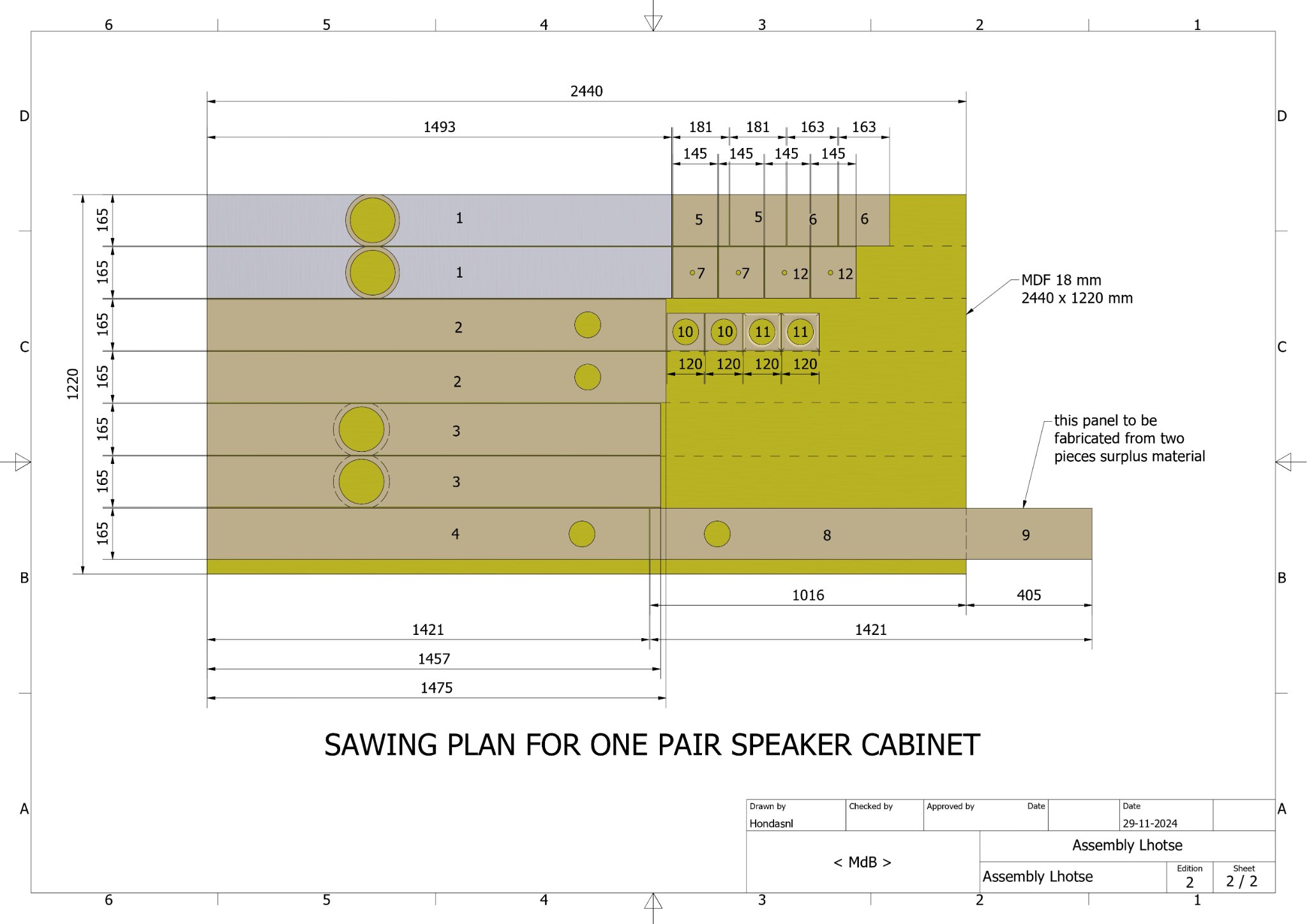

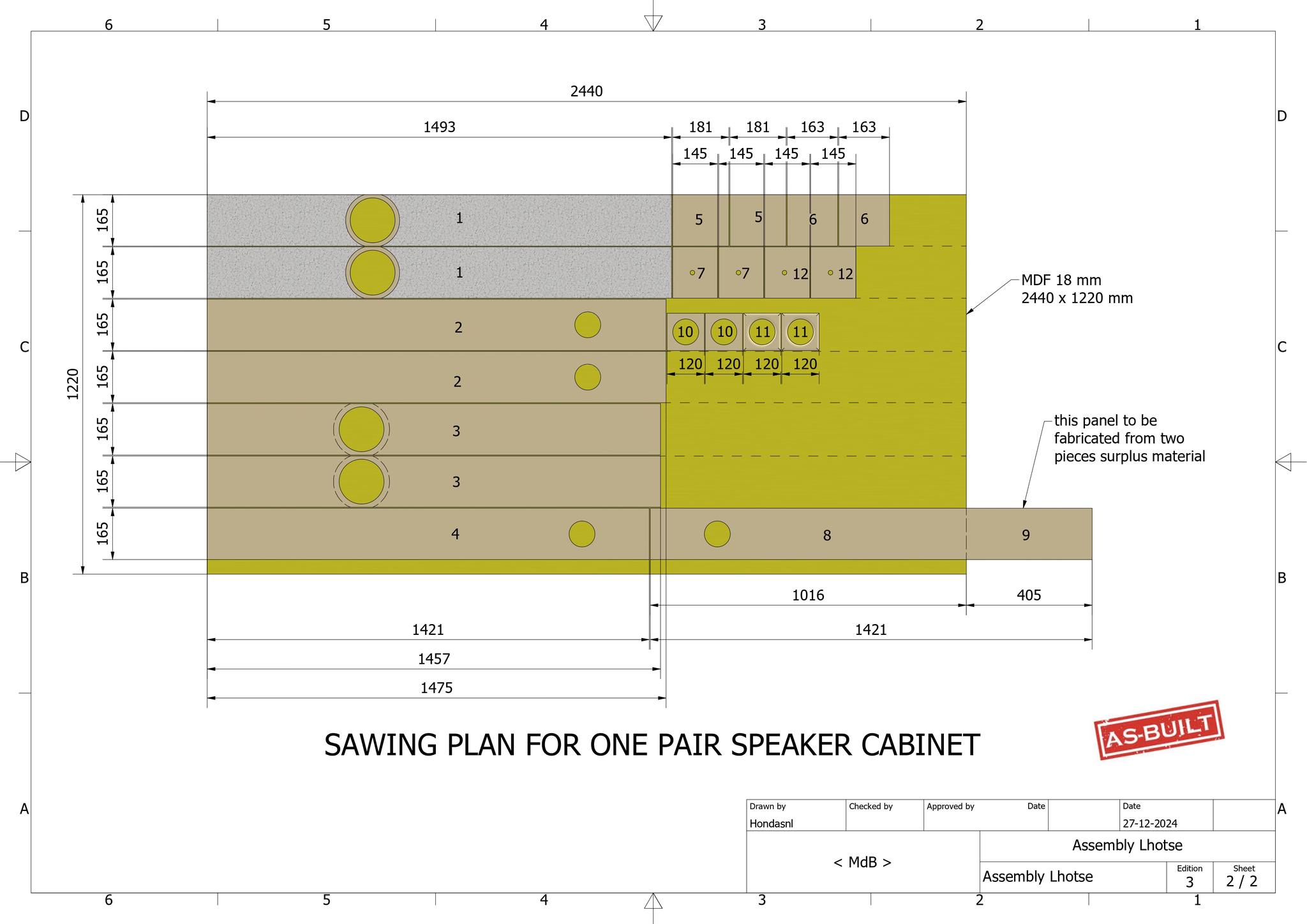

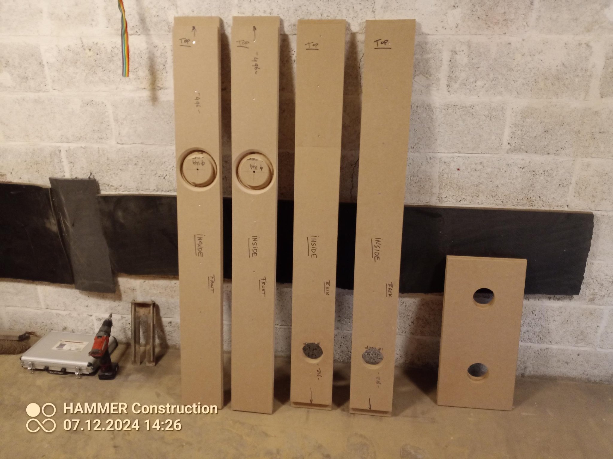

Building the Lhotse designed by Scottmoose

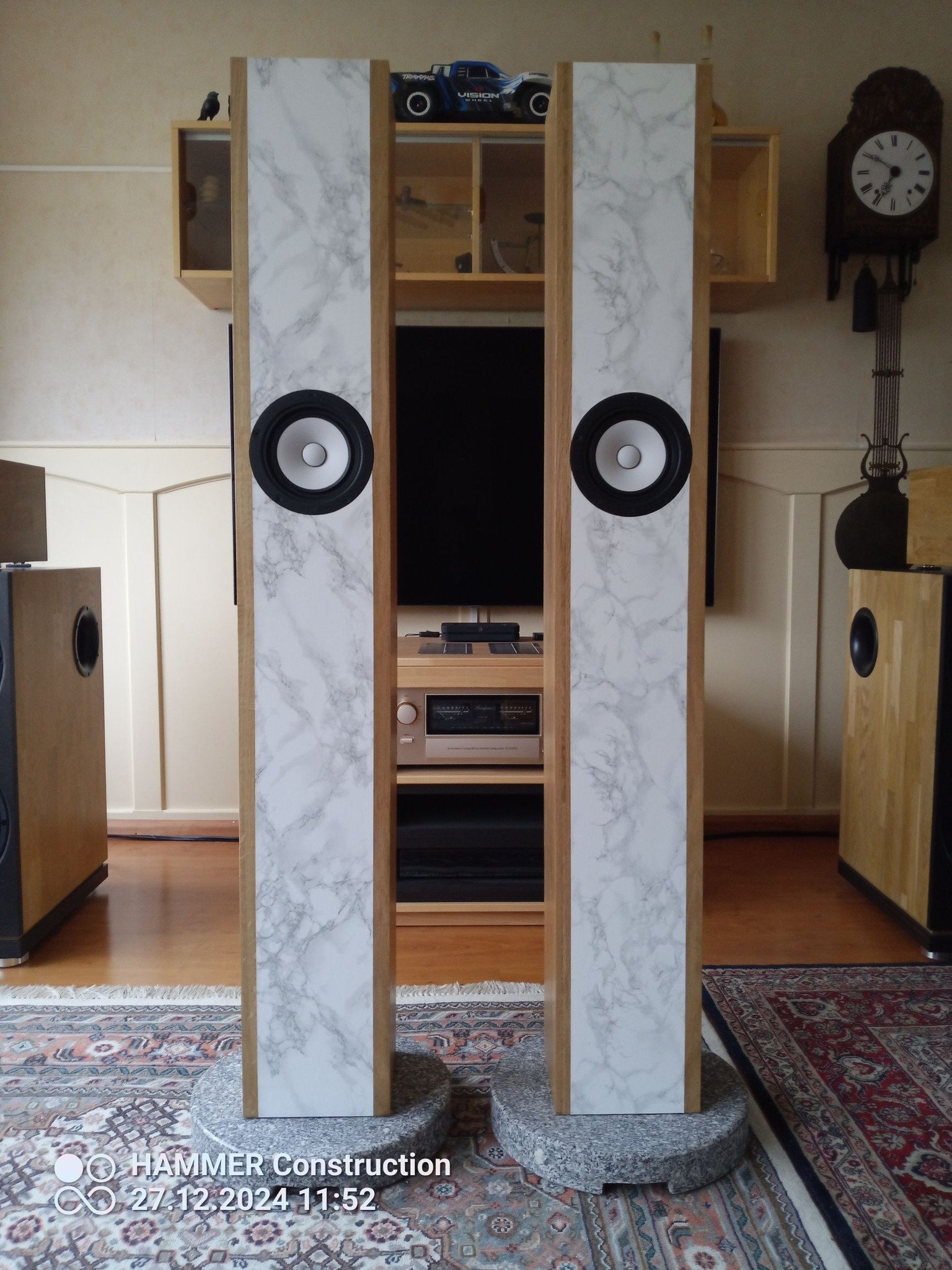

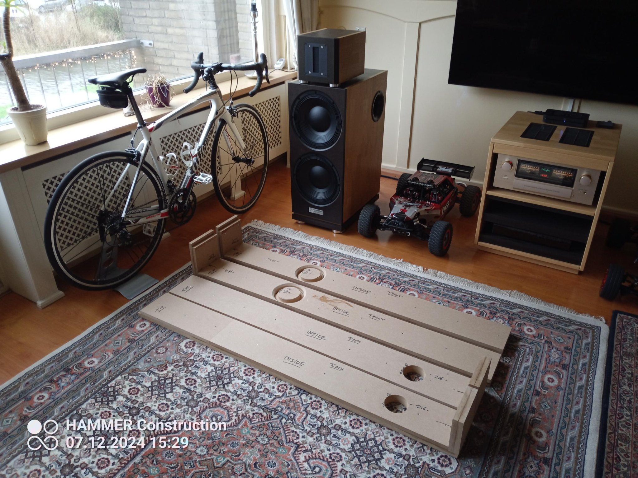

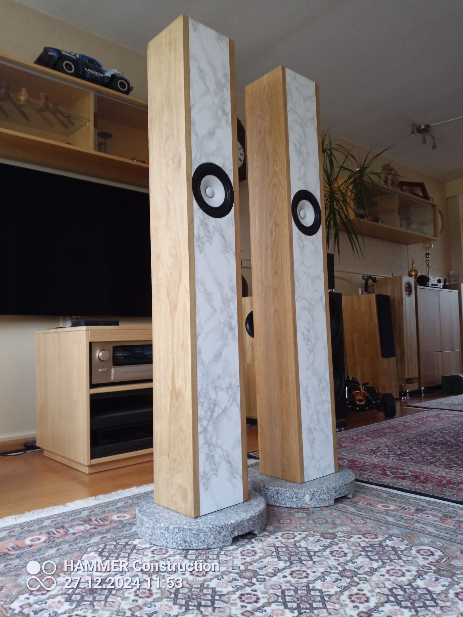

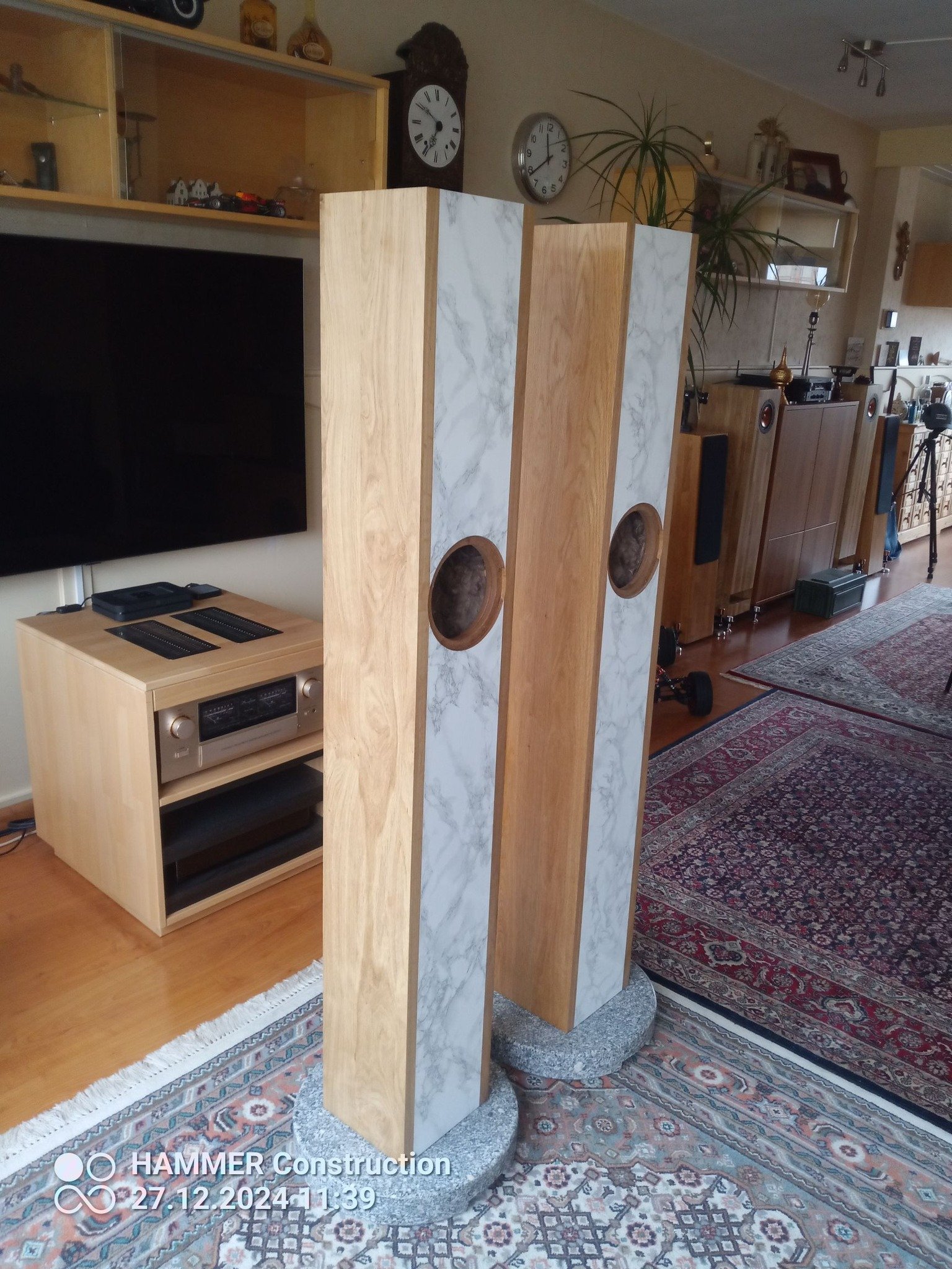

Finished! And they sounds beautiful!
