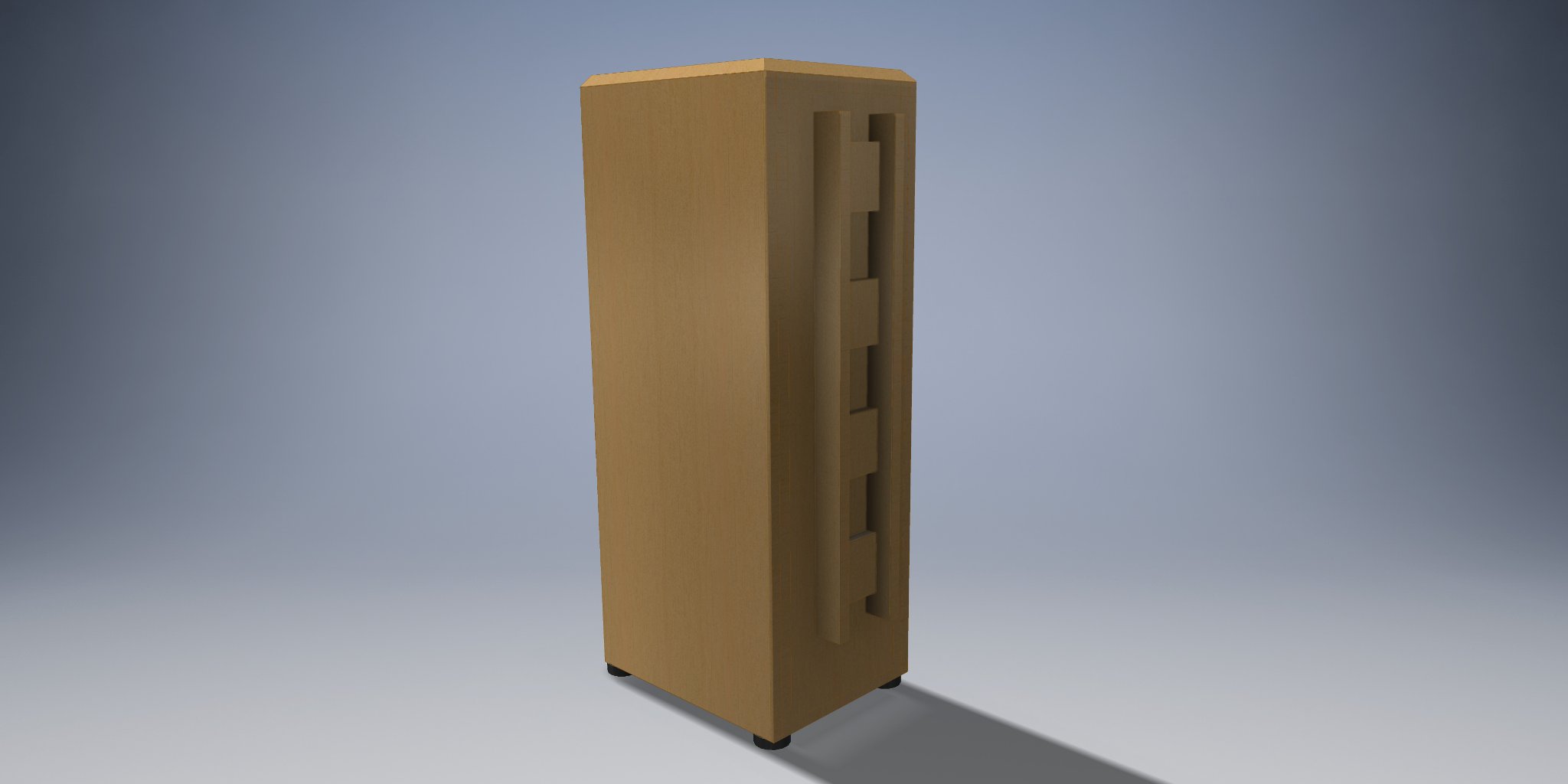

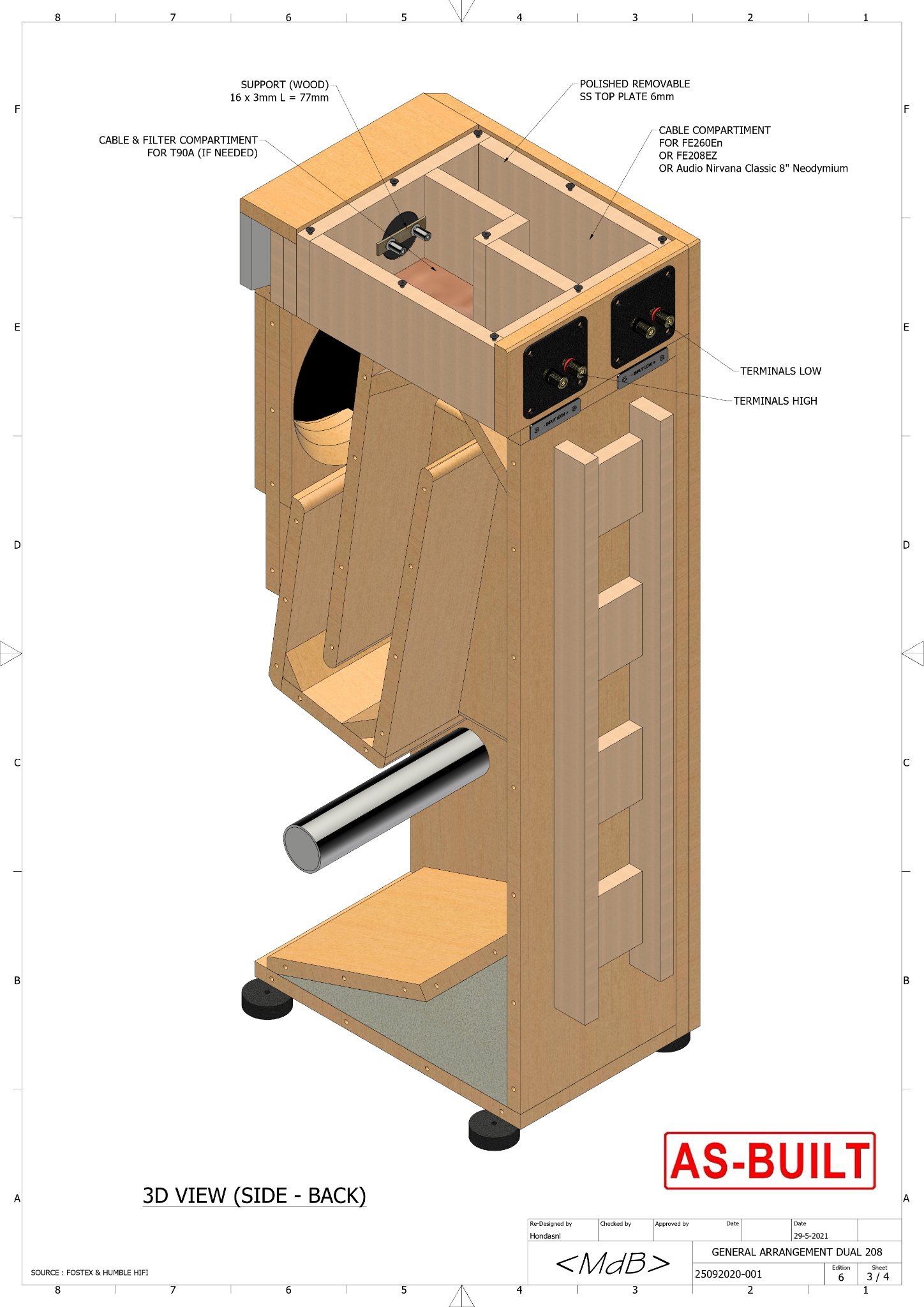

Any extra internal solid consuming volume/material will kill bass output comparing without it. The more volume the better the bass output. Specially for this relative small volumes. If you want to add any bracing please install this outside the cabinet as I said before. Again, this cabinet really dont need any bracing. It is so small and narrow it will be total over kill and brings you noting. If you built wider and deeper cabinets it will give noticeable effects. So my advice, keep this narrow cabinet as clean as possible inside for getting the best and lowest bass output.To those lurkers, Hondasnl has shown a blatant disregard for solid feedback in many of hgis builds if it goes against the “truths” he has exposed in his naratibves and builds.
I would pay attention to what Scott says.
Even these tiny little boxes benefit from a holey brace, Not so much related to the box itself, but how the driver performs becomes part of the box. Bracve does not affect the bass, but improves DDR.
That is a 3” driver.
dave

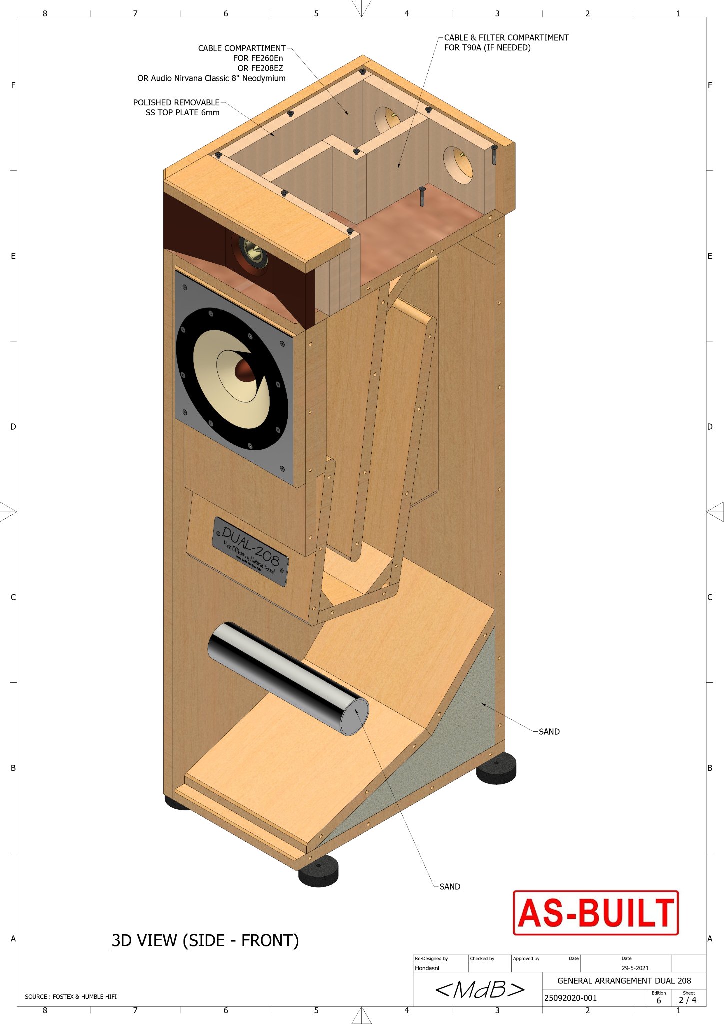

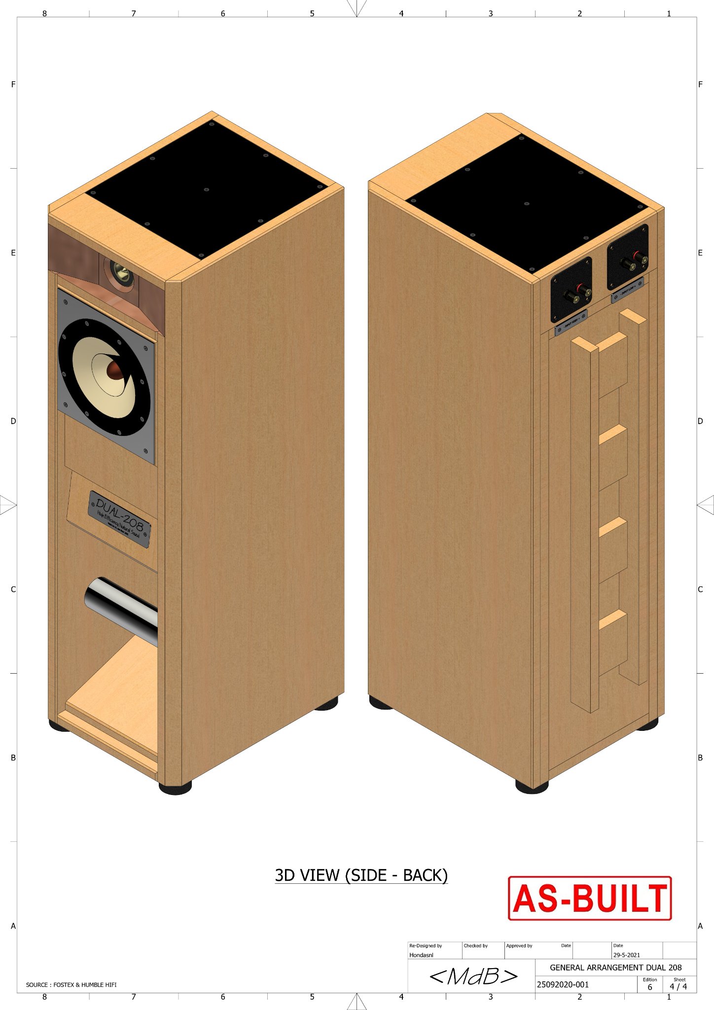

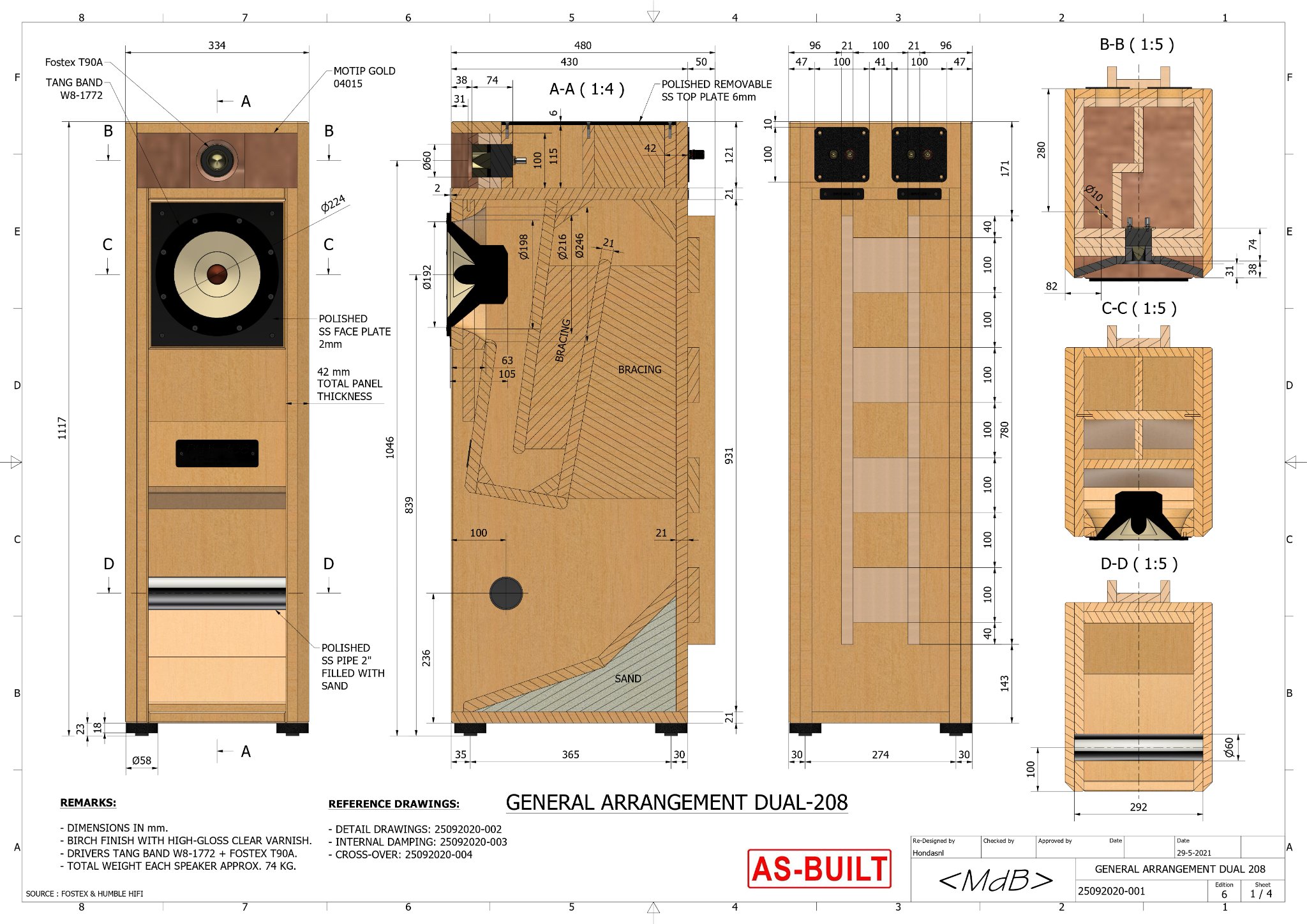

Example bracing outside the cabinet.

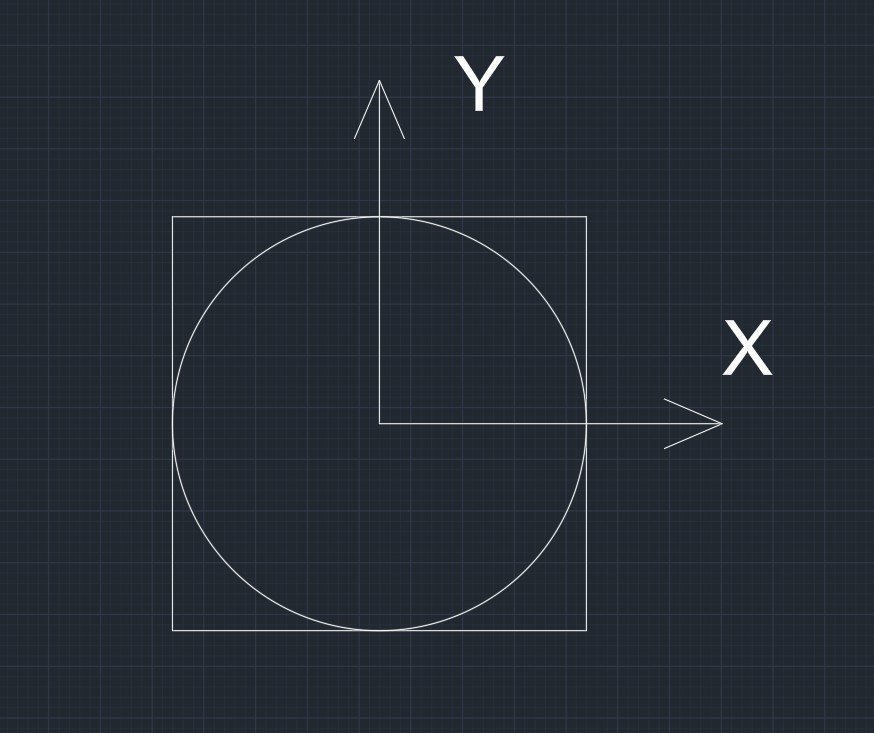

A square version with the same external dimensions offers the same stability as a round one in the x and y directions.Effective, but i find them kinda ugly. A rectangle would be less likely to tip over.
dave
I like the round version more than a square one ;-).
Only a little bit extra weight is missing but overall more than stable enough. Depends on the specific mass of the used material.
The square the circle is cut out of would be more stable, because the corners stick out, circle will fall over in any direction, a square or rectangle would be restricted at a non-orthoganol angle of fall.
dave
Hi Dave imaging the specific mass of the used material is very light then the difference will be nihil, thats what I mean.
And a square feet I don't like. I bump my toes against it and the vacuum cleaner.
Hi Dave imaging the specific mass of the used material is very light, then the difference will be nihil, thats what I mean.The square the circle is cut out of would be more stable, because the corners stick out, circle will fall over in any direction, a square or rectangle would be restricted at a non-orthoganol angle of fall.
dave

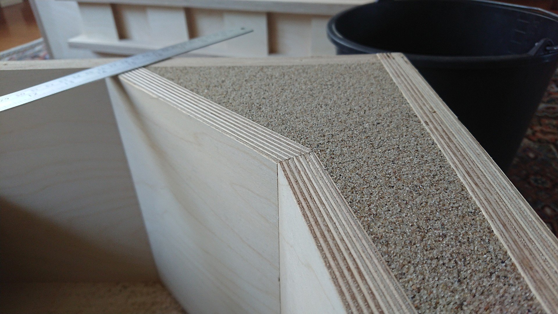

Is this primer paint layer you have used?
I like to finish the baffle of the Lhotse with: https://www.behangwereld.nl/a-23845034/plakplastic-steen/plakplastic-graniet-grijsblauw-45cm-breed-x-2m/?utm_source=GoogleShopping&utm_medium=cpc&utm_campaign=PLAKPLASTIC/Plakplastic steen&utm_content=Plakplastic&gad_source=1&gclid=EAIaIQobChMI_rGLi5GuigMVpoODBx15Qy4HEAQYASABEgKob_D_BwE#description
A perfect match with my superior recommended massive granit feets.
Is this primer paint layer?
No, it is 3D printer filament
