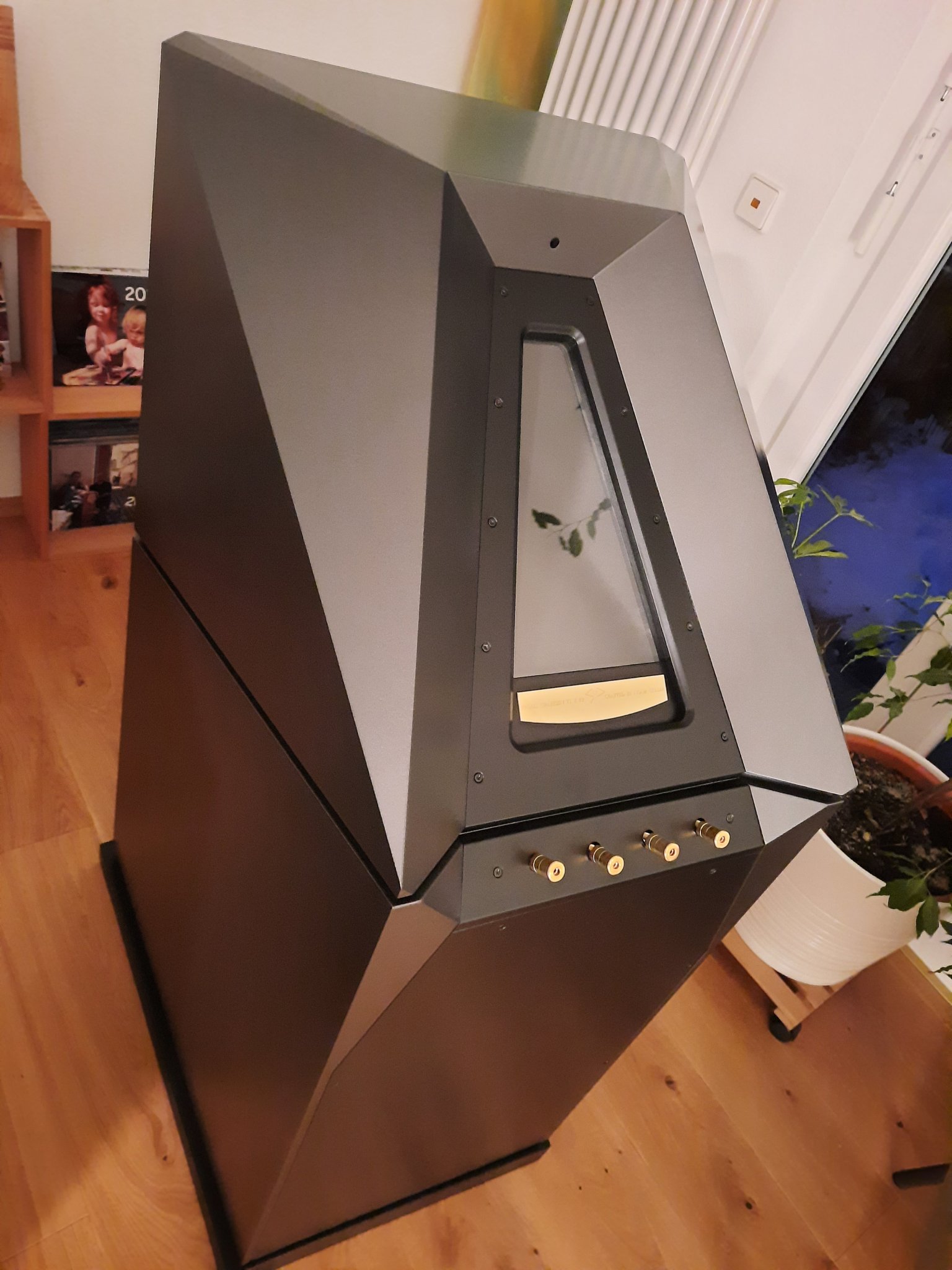

Would be great to see your project 👍, send some pictures if you haveFrom someone who has not finished his project since a while (but when the custom waveguide is finally done), with a wink:

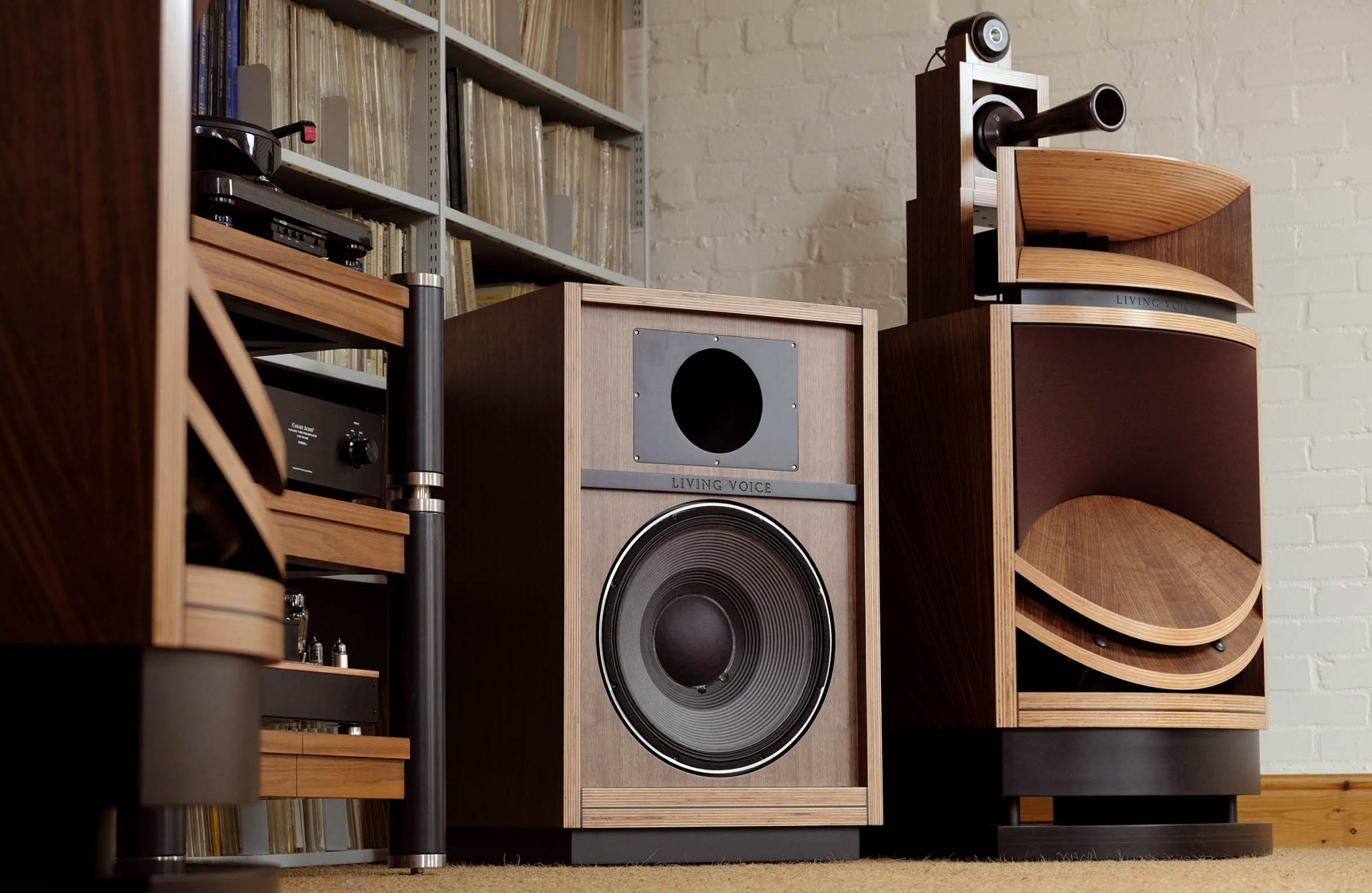

So Christmas is coming and it would be great to build my own Living Voice Vox Olympian...

I absolutely adore the design and aesthetics of living voice
And your TL2 too!
I estimate them at 150kg per speakerDo you have a way to estimate how much they weigh?

how is your TL2 build going? would be great to see some progress photos.

I haven’t done any progress with my TL2… but lots of other stuff audio related… Some crazy, some less 🙂 I’ll make some photos and will update soon!
