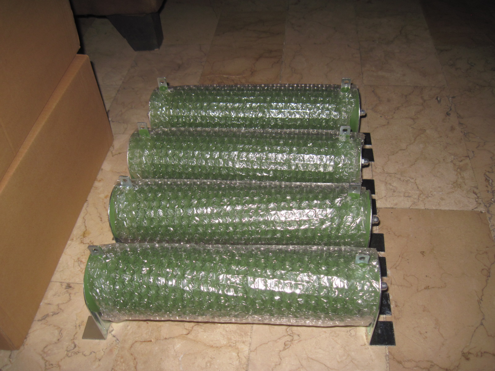

these resistors cost me about 1500 pesos each....
8 ohms 1000 watts, all you need is to just attach connectors/leads...

All I rememeber Andrew is they are circa 1600 watts at 230 V. They are at best +/- 10% I suspect. When sine wave testing 7R5 to 8R5 suits me fine. I do remember the one I checked before installing it as bang on 32R cold. When hot it can't be too different as the rated power is 1600W.

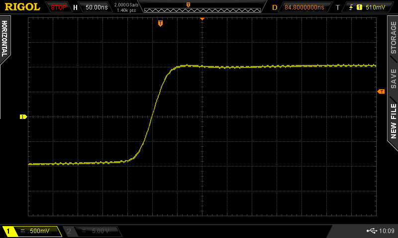

I built another unit today and this time I remembered to snap all scope photos at the same sweep rate! (see post #7 above).

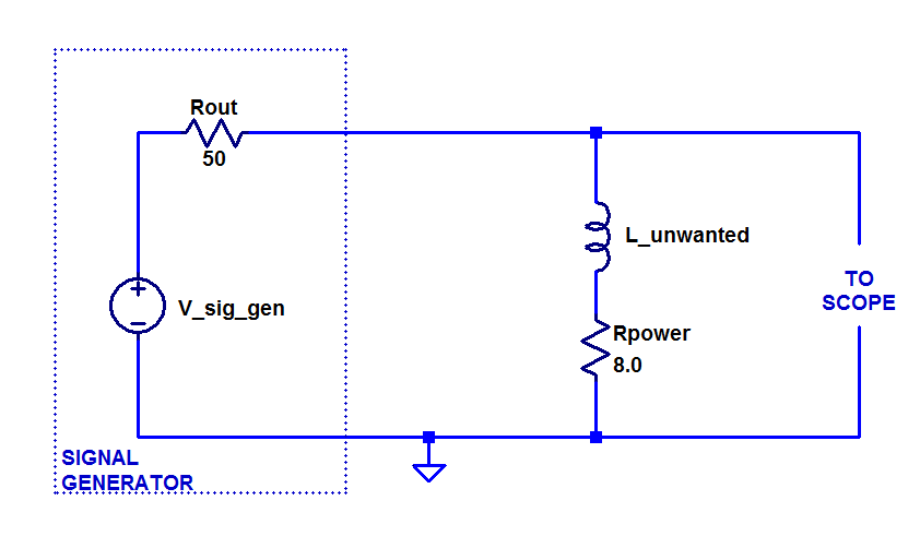

As a reminder, the goal is to construct a high wattage, noninductive, 8 ohm resistor using inexpensive 10W wirewound components (which are themselves, quite inductive). The resulting circuit is a factor of 10X to 20X less expensive than the exotic Ayrton-Perry type of noninductive resistor, see post #13.
I use square wave testing to observe the inductive behavior of these resistors, as Elvee did in post #3. The test setup is shown in Figure 1 below. A signal generator produces square waves, which are applied to the inductive 8 ohm resistor at right, and an oscilloscope monitors the waveshape. The inductive reactance of L_unwanted allows the leading edge and trailing edge of the square wave to overshoot, shown in Figure 2.
(Notice that the signal generator's 50 ohm output impedance, forms a voltage divider with the 8 ohm load)

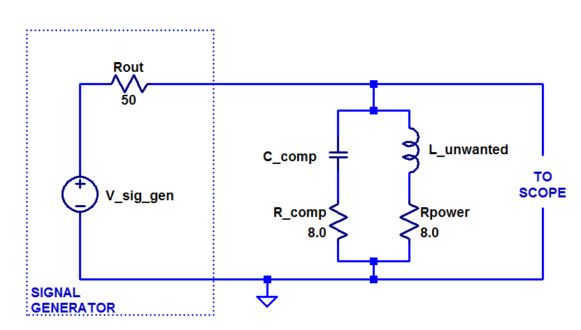

Then I add the compensator network (R_comp and C_comp) in parallel with the power resistor, shown in Figure 3. These are small, low-power components; they only conduct current at high frequencies (where radian frequency omega > (R/L); namely, above 2.5 megahertz), and/or during the fast edges of square waves where the high frequency signal components are present.
The compensated resistor's performance is shown in Figure 4. Inductive overshoot has been eliminated; we've now got a $12 noninductive 8 ohm resistor good for about 150 watts.
