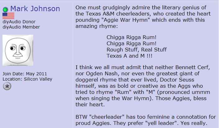

You can imagine my surprise when MJ started quoting,
"Chig-gar-roo-gar-rem!
Rough! Tough! Real Stuff! Texas A&M!"
It's out there somewhere, where exactly
I don't know.

Aircraft maintenance logbook entry by pilot: "#3 engine missing"
Matching logbook entry by licensed repair technician: "engine found on right wing after brief search"
Similarly found after brief search: attached below. Google Advanced Search feature named "this exact word or phrase" was successful
_
