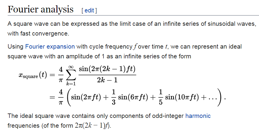

Hmmm, I applied a 1.0000 kHz square wave input when making the measurements shown in post #38. Are you saying that if I instead apply a 3.14159 kHz square wave (or a 100 kHz square wave) and make the measurements again, the output this time will exhibit overshoot (or undershoot) ??
Interesting screengrab from Wikipedia attached below.
Inductive cancellation only occurs at a specific frequency.

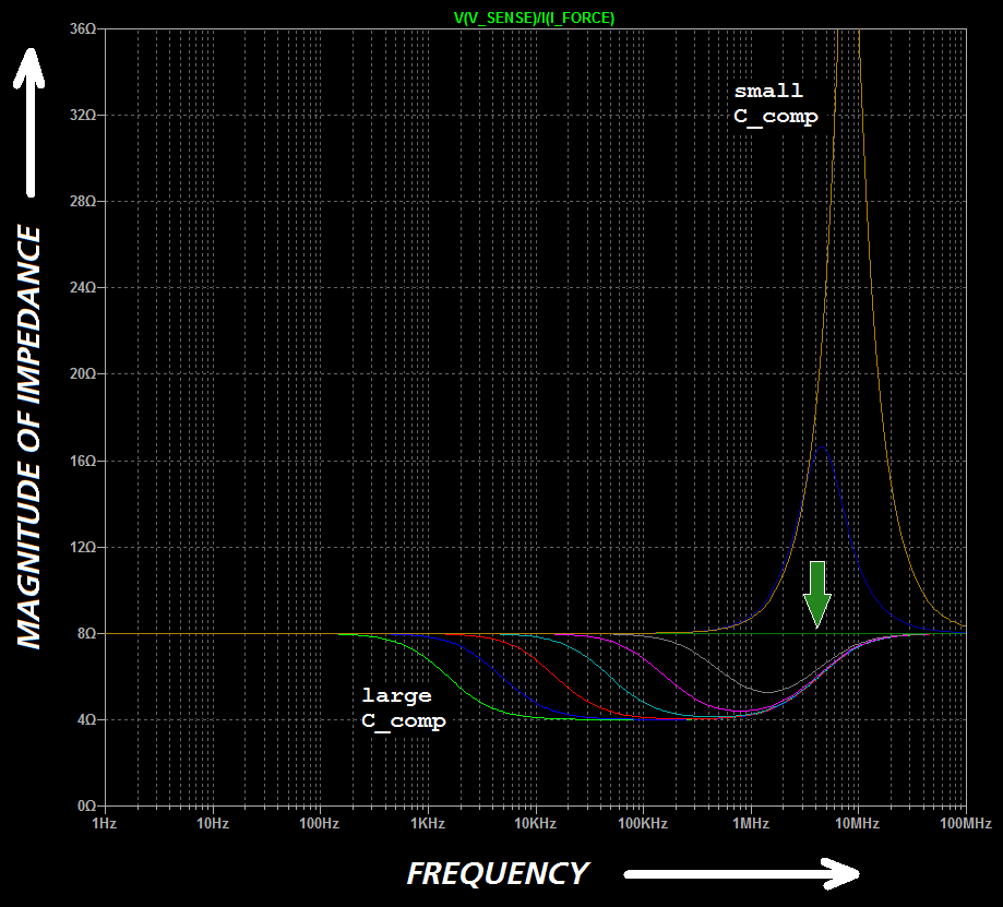

It's perfect compensation, do the math.
The impedance of the two branches in parallel is : ( R + 1/sC ) // ( R +sL )
= ( R + 1/sC ) x ( R +sL ) / ( ( R + 1/sC ) + ( R +sL ) )
= ( R + s ( L + RCE2 ) + sE2 LRC ) / ( 1+ s2RC + sE2 LC )
= R x ( 1 + s ( L/R + RC ) + sE2 LC ) / ( 1+ s2RC + sE2 LC )
=R provided that L/R = RC
This is complex frequency domain circuit analysis, but you can
simulate the circuit if the algebra isn't good enough.
Since A // B = AB/(A+B) we have:
Gather like terms in the numerator and denominator
and multiply by sC/sC to clear negative powers of s:
Pull out a factor of R in the numerator:
Comparing like powers of s in the numerator and denominator,
the zero order and second order terms of s are the same, and
we see that the linear s terms can be the same if L/R = RC

It's too bad you didn't read post #8 before boldly stating "Inductive cancellation only occurs at a specific frequency.". It's also too bad you didn't attempt to confirm or refute your bold statement by performing a circuit simulation; that might have avoided some embarrassment. See arrowhead on figure attached.
It would be nice if you apologized to member rayma for your lecturing tone. It would be nice if you acknowledged that member rayma proved the final result and you misunderstood his proof. It would be nice if you vowed to double check and reconfirm yourself, before making similarly bold statements in the future.
