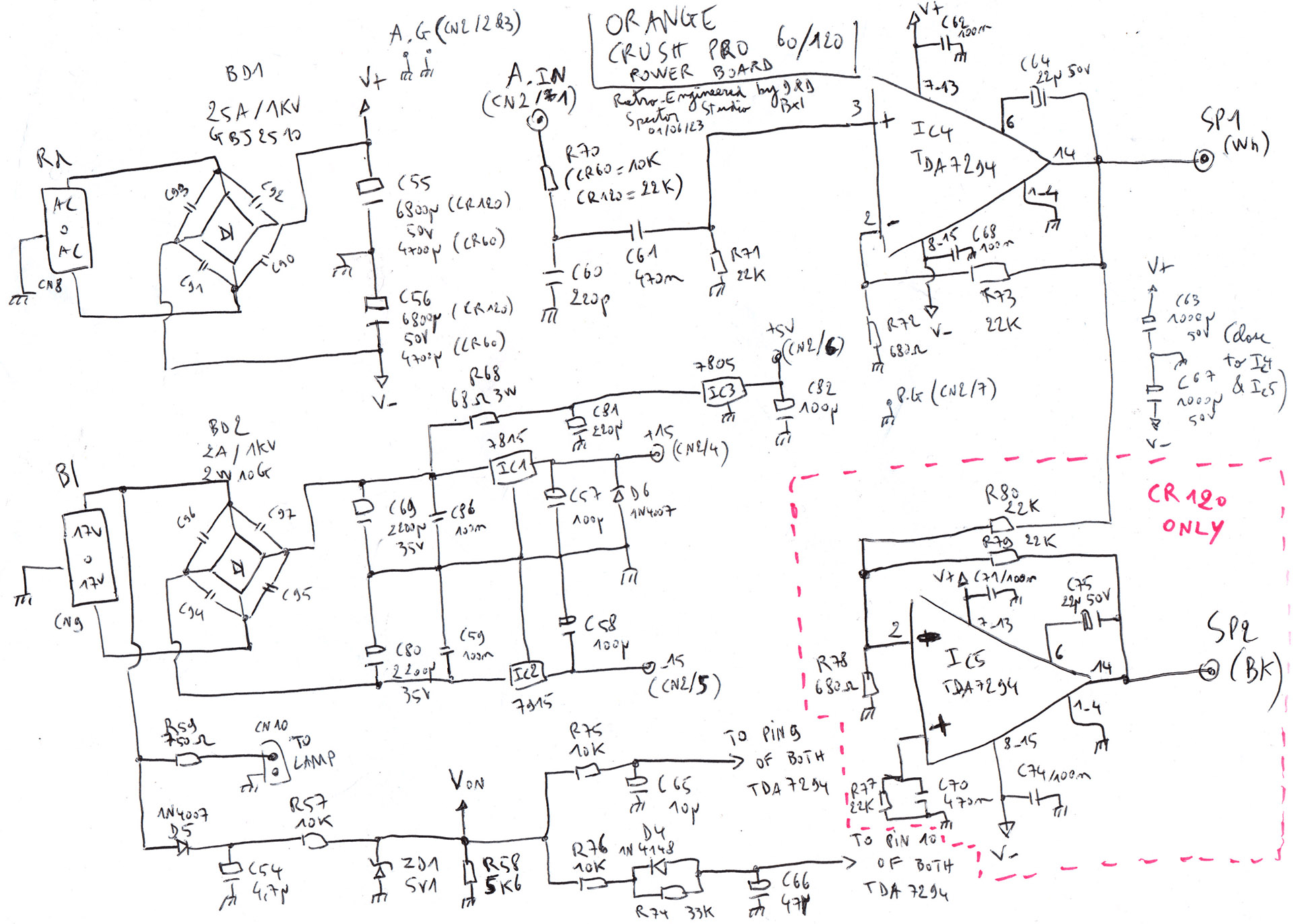

I did just find out that there is a guy on the GroupDIY forum that is selling boards for the Orange CR60/CR120
Orange CR60/CR120 power amp boards
It doesn't have all the parts like what comes with a kit, but I bet that I can source all of the part somewhat easily. I just need to get the right power supply.

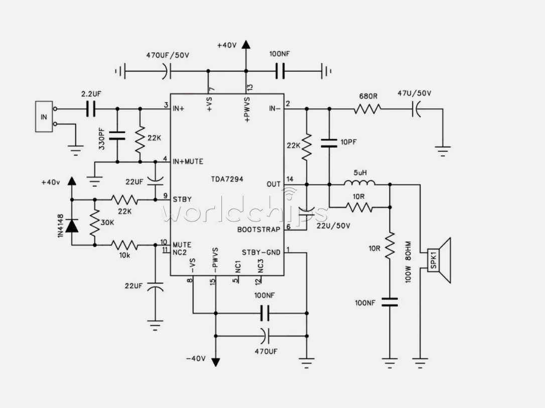

Here is the schematic the same user shared
I haven't studied the schematic against the one from eBay but here is that one too
Interesting.
That said, all (EBay board, Orange clone, DIYAudio members) are using the same schematic: the one suggested in datasheet for simple and bridged TDA 7294.
Just compare them, so here winner is the best made PCB.
Meaning: for any given configuration (simple or bridged respectively) all will put out same power, sound same, etc.
All are using +/- 40V supplies which I already mentioned is the important parameter.
King of Techs Enzo used to say: "the amplifier is just that thingie between power supply and speaker"
Only difference is that bridged one puts out twice the voltage do is more suitable for 16 ohm speakers, everything else stays the same.
