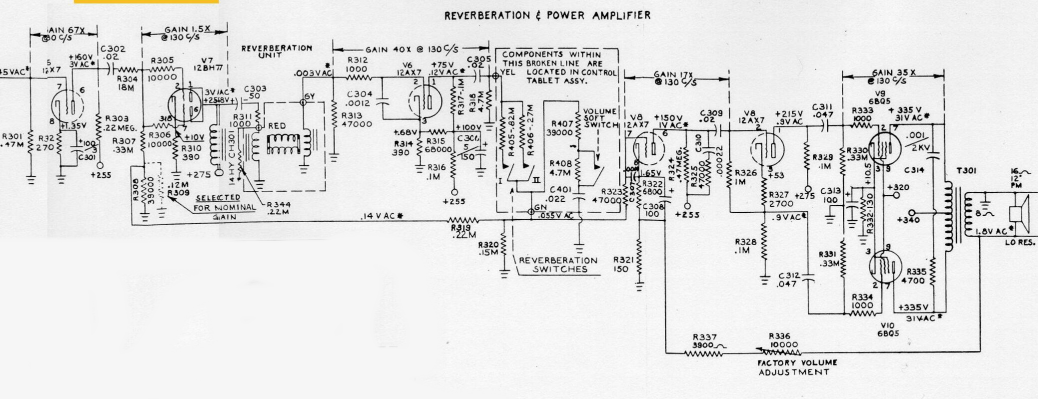

I find it stunning no one probably even looked at the pictures of that little 6BQ5 P-P Hammond amp I suggested off ebay. (No affiliation with the seller)
$100 free ship and still for sale...with its I'd say more than adequate power tranny and how easy can it be Fender style point to point wiring underneath.
Looks like it even has the reverb tank driver / circuitry in there; just get the springs for it and you have that part 95% done too - probably have to add the control pot - and label it "Reverb".

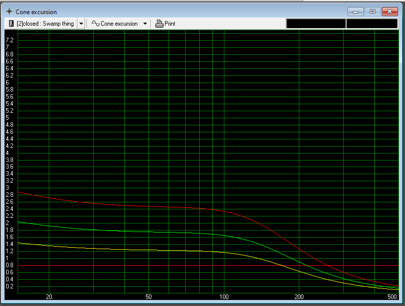

Lets look at a typical underhung 150 watt guitar speaker in a sealed box, which is super fair to it not open back so it actually has more cone control.
Xmax rating as discussed before is .8mm some go to 1mm. Once cone travel reaches .8mm you are at 10% distortion or Xmax or linear travel.
Look at the red line straight across measuring .8mm =10% distortion cone movement above that is far far more than 10%
Yellow line = 15 watts already exceeded xmax by almost twice
Green line = 30 watts
Red line = 60 watts

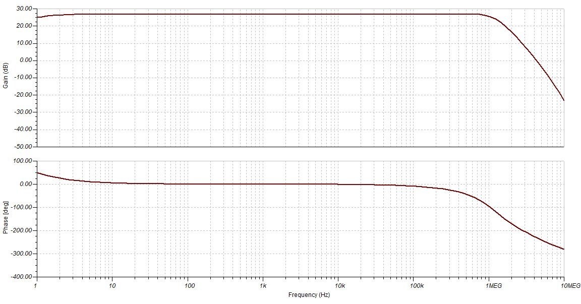

Your other question is below , amplifier bandwidth or AC analysis of very simple amplifier and bandwidth is close enough to 5 Hz to almost 1 Megahertz
is far far far wider than the guitar pickups, strings or speaker

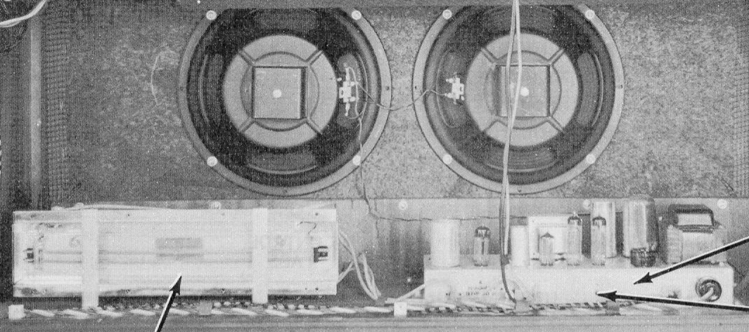

Not too bad, in my teen years we would find fully abandoned organs at the Salvation Army donation station on weekends.I find it stunning no one probably even looked at the pictures of that little 6BQ5 P-P Hammond amp I suggested off ebay. (No affiliation with the seller)
Since the trailer wasn't open on weekends. People filled the parking lot with junk / donations.
I built a few 30 watt tubers with basically free organ amplifiers. Many of them with working tubes.
And had a good collection of reverb tanks and rotary speakers with foam horns found in organs.
All free sitting on the street. One organ had all tube oscillators so that gave me 88 free 12AU7 tubes
and a 6V6 push pull power amp. Wurlitzer and others had pretty big amps.
That all tube oscillator organ had a transformer big enough to run 88 tube filaments
So was a massive massive huge transformer, and I got a lot of high voltage coils to build tube Theremins

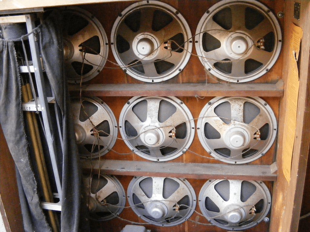

Yeah - those were the days. There was a restaurant in Yelm WA that had these 3 big tone cabs. I asked about them and they just said "take 'em - get 'm out of here". Couple of nice amp chassis in those, 15" field coil speakers...Not too bad, in my teen years we would find fully abandoned organs at the Salvation Army donation station on weekends.
My proof that I've parted out an organ or two is one remaining part I still have, a mercury filled tilt switch on a lever, used to turn the thing on. Apparently, ordinary dry switch contacts would not do, for the AC line current the thing took.
Really !! as in the big Hammond tone cabinets3 big tone cabs
Nice! love those things.
Leslie speaker was the " cool" thing to have
So the big tone cabinets got sold cheap. But would blow away a Leslie for sound output
Always wanted one for that reverb tank its basically the mother company for Accutronics.
My friend Roy bought a C3 tone cabinet. It had the early reverb patent from Hammond
Often called "Necklace" type spring it went from top of cabinet to bottom. Insane
More speakers in that thing than imaginable, we were laughing like children when he bought it.

Maybe should post a picture of the necklace reverb spring.
And why I thought people were insane back in the day and underrate the tone cabs
cause they weren't spinny winny overpriced Leslies.
People can see the huge reverb tank in the rack wrapped in cloth
and maybe see why me and old Roy laughed hysterically when he got one
The amp inside was a pretty large rack had countless tubes, multiple rectifiers

I have no idea what you are trying to say. I am guessing that the lower scale is in Hz and the other axis is distortion. I see the yellow at 1.4, green at 2.0, red at 2,8.Direct radiators can be around 1 to 3% distortion for " Hi Fi" so depends what you consider " distortion"

On the low frequency response I was asking in response to your saying a guitar speaker flubs out at 15W. I was not asking about the SS amp needs, but you have to back up through a few posts to remember what my question was. I will ask it again, how do the doom metal guys get the low end for dropped tuning if the speakers can only accept 15W in the low end? I would guess your graph should tell us but as shown, the red line shows what would be great distortion in a hifi system (red at 2.8).
Either I am a little slow or your graph does not match up to what you are saying. But I am at the point where I do not care as it does not further the OP's desire for an amp.

Hz and cone/coil displacementI am guessing that the lower scale is in Hz and the other axis is distortion.
They hit distortion at 15 watts, as mentioned low end gets pretty flabby around 30/60 watts
depends how well the suspension is worked out. There underhung so they wont hit damage
like a common overhung speaker does when it starts going past linear distortion
