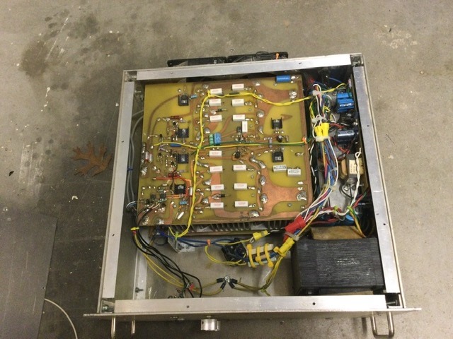

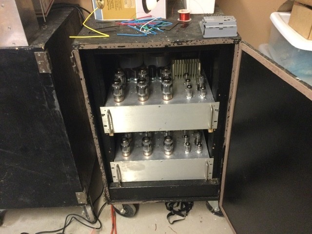

Something also “known to work”. I had two of these homebrew units an used them gigging for my entire college career and a little beyond. Supposed to be like a Crown DC300A, but with all the improvements that were made for the PV CS800 and full comp outputs which are less prone to oscillation. I got 80v/8A EI transformers for next to nothing (toroid $85 today from Antek). So that determined the size of what got built. With 8 output transistors per channel they are good for bridging into 4 ohm, with a DJ at the helm. I was that DJ and I do not have irrational fear of clipping. Two pair is enough for most normal use. One works just fine on +/-42 volt rails (Can reduce the SOA circuit resistors to 3.3k). I’ve used this same thing scaled to all kinds of power levels over the years, and made them with class G and H multi rail supplies. Hi fi, instrument, PA. The SS one above uses a symmetrical VAS (like the BGW), +/-84V, and 7 pairs of outputs. I’ve gone bigger, too. The original KM441 transistor set is NLA, but works if the substitute is designed for the same purpose. 15003/4 outputs, C5200/A1943 drivers, and your favorite fast TO-126 for the vas and predriver for these rail voltages. For a single channel use a 400VA trafo for +/-55-60, and 300 VA for +/-40-42.
