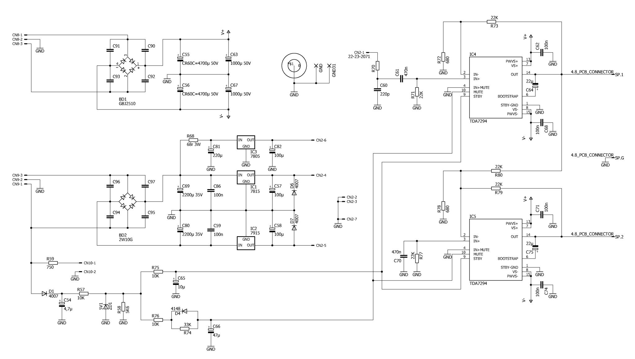

Among other reasons, because trying to build the perfect amp on first try can be very frustrating, and that after a LOT of work to get everything, so my suggestion is, Just start the engine running:
1) get the
* power transformer : 28+28V 150-200-250VA
* diode bridge: suggested GBJ2510 or a 6A 400V bridge and worst case any generic chassis mounted 35A 200-400V bridge, simply because it became a standard and
* filter caps: 4700uF@50V needed for the datasheet/Orange bridged TDA7294 amp.
The apparently useless 1000uF@50V caps shown in parallel actually mean those are placed close to the Chipamp board to decouple it.
Build that power supply.
No doubts there, it's a simple circuit, it will be kept for sure, can feed 1 or 2 TDA7294, what's not to like?
No doubts, not wasted money or effort.

It looks like you'll need two transformers - or one with both the 30-0-30 and maybe a 12-0-12 secondary windings for the +5, +/- 15 part. I'm pretty sure you cant just use the 30-0-30 winding there...Here is the schematic for the board I have
Interesting how they do the sequenced / delayed logic levels in analog, to "bring up" the chip amps out of standby and un-mute them.

The board has what looks like diode rectification. Is this different than that?* diode bridge: suggested GBJ2510 or a 6A 400V bridge and worst case any generic chassis mounted 35A 200-400V bridge, simply because it became a standard
Or is this in reference to testing tbs build with a generic board instead of the one I have?

It needs diode rectifiers .The board has what looks like diode rectification. Is this different than that?
I suggested some.
If board includes them, by all means use them.
If you feel confident, straight build the cloned OR120 board.Or is this in reference to testing tbs build with a generic board instead of the one I have?

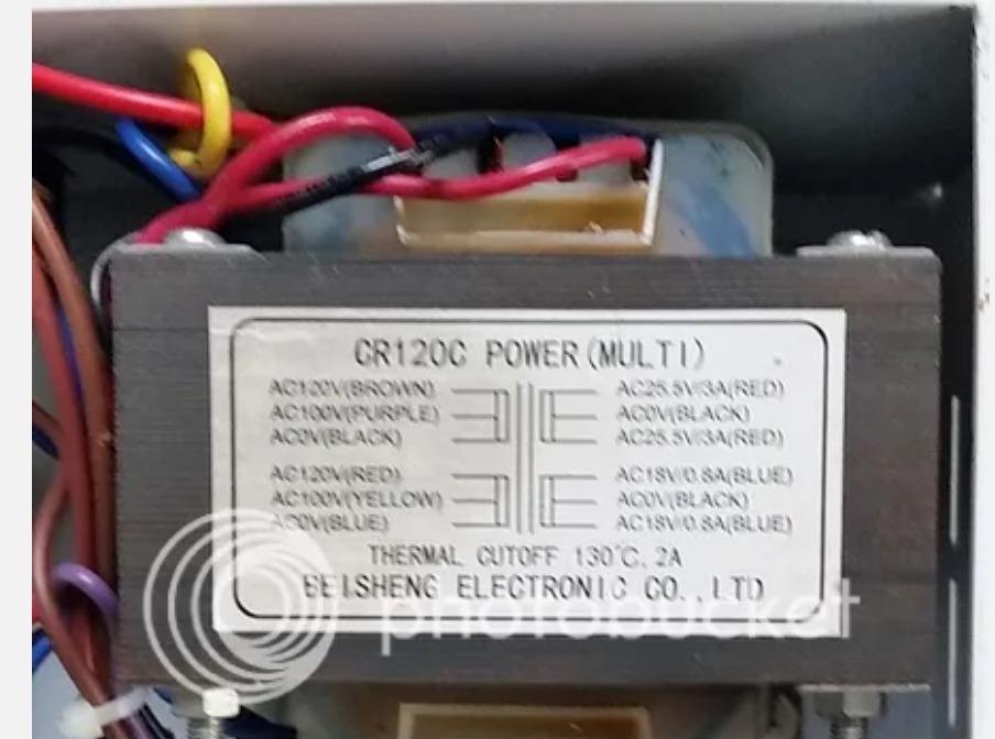

Looks goodI found a picture of the CR120 transformer View attachment 1314604

25-0-25 was a good call at 330 VA
Why I recommended a 330 watt transformer
which does not follow rule of thumb of Double the power
going in or 200 watts. Again its a tradeoff with bridged amplifiers
you get more voltage swing, but it consumes more current
so you need to up the VA rating.
about what they are using.
to figure VA assuming generic .8 power factor.
formula for VArating = (V secondary x I)/0.8
V = secondary voltage ( 51 V )
I = current ( 6 Amps )
.8 = power factor
According to unlikely but maybe ish tiny transformer
magic sticker
382.5 VA transformer for power section.
Great thing about good old transformers
is you can pull more current than their rating.
Voltage drops, but current keeps coming.
Only problem is they can exceed the wire gauge
current rating and get hotter than hell.
Was not regulated as much in the 70's and 80's
but now days max exceeded transformer rating
was 20% to pass certification. Likely been lowered
since, have not done commercial stuff in awhile.
As you can see Orange used a transformer
with thermal cutoff rated 130c
Just in case this happens.
Oh I bet that little guy gets hot too.
Least they used a E core, which I like as well.
Most manufacturing switched to toroidal cause they are
somewhat lighter/ were cheaper. I like the old school E cores.

I'm worried you don't seem to notice the difference between single supply and dual supply.
TDA7294 needs dual , +/-40V DC supplies.
Or +/-35V to play it safe.
You constantly mention "40V" or "25V" or something like that, which is wrong.
You even bought the relevant PCB so please stop shifting goalposts.

That said, enlarging the very fuzzy Orange transformer label, it seems to say 26.5+26.5VAC for nominal +/-37.5VDC.
Fine. They do not go to the limit.
Even a 2 x 25 or 26VAC transformer will do, so ....

I don't see a volume pot in the schematic I shared. Where should that go and what value should I use?
