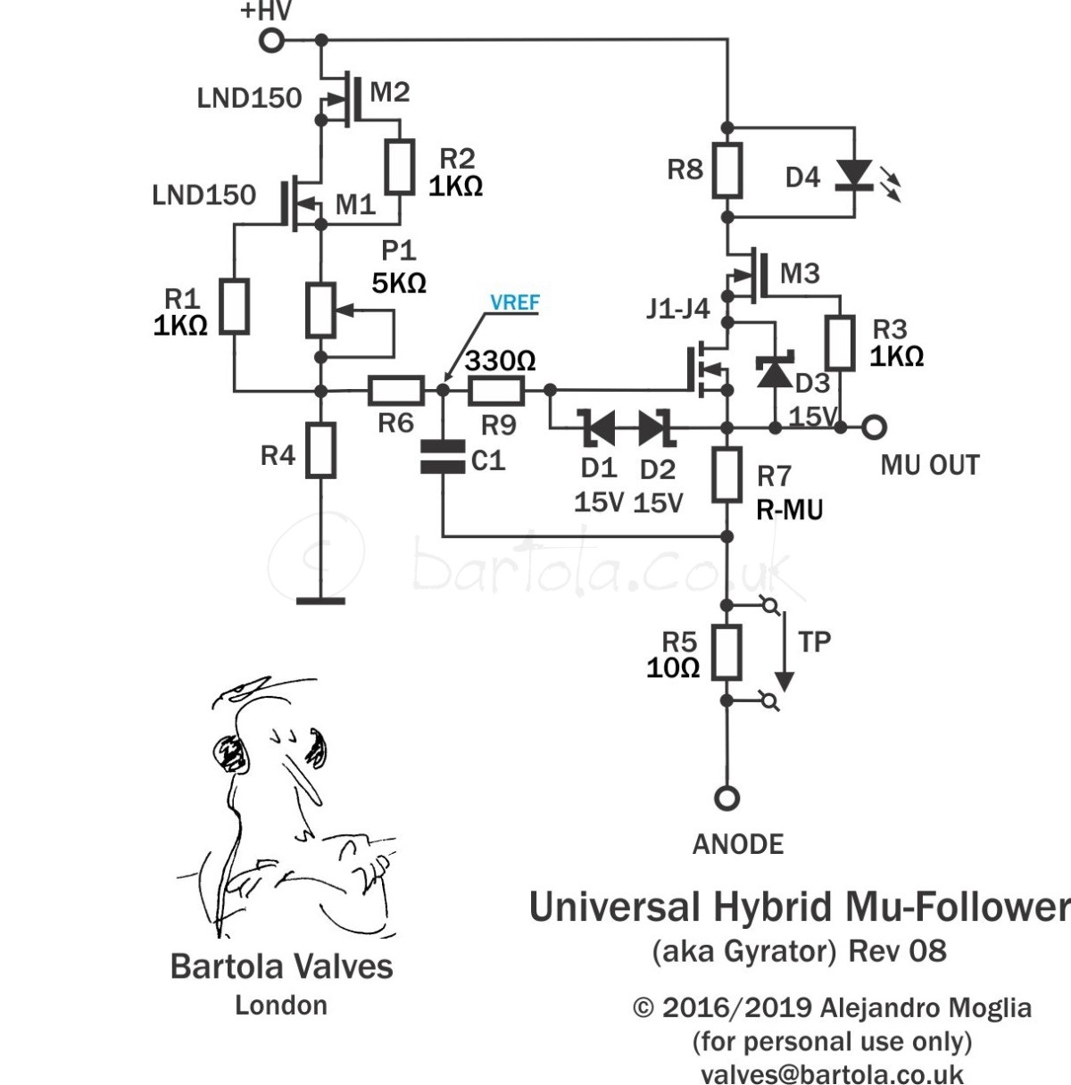

Gyrator parts:
R11 right 973R left 1K01
R7 right 984R left 993R
R8 right 475K left 475K
R9 right 9,86Meg left 9,93Meg
R6 right 498,2R left 499R
Trimmer both 5K
C3 100nF
M2 & M3 both LND159
U3 both IXTP08N100D2
J1 both 2SK3557-7-TB-E
D1& D2 both Zener 15V 1/2W

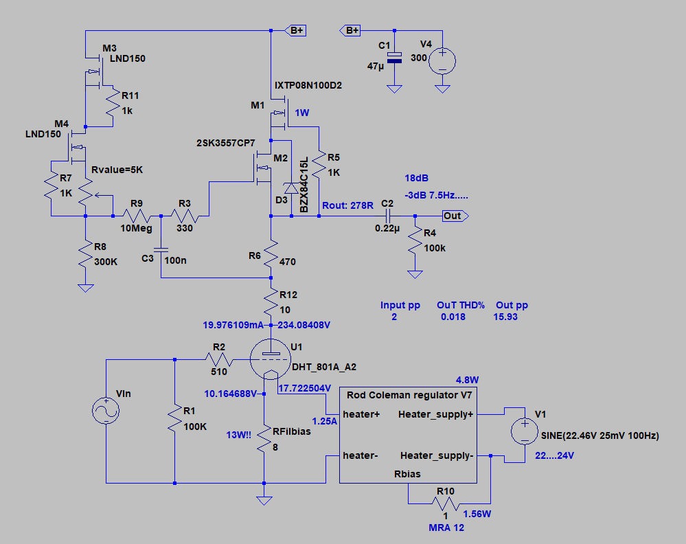

BF862 EOL, I followed Ale's advice to use 2SK3557. Ok I'll install D1 & D2.
Why this big difference in level between channels not reflected at measurements?
?The Ale's hybrid mu-follower is the Rev. 08, still needs D1 & D2?
Soldering the zeners I discovered the 100nF cap one leg desoldered, now both channels sound with the same level and I'm the man most happy of the world🤗
In your preamp, yes.
The emerging operating point will be little different, and R.C. regulator must be set again.

If I remember correctly, you use R.C. V9 regulators.
Rod recommended 3V voltage overhead for this.
If you use 8R as filament bias resistor, the recommended minimum raw voltage for R.C. regulator:
(1.25A*8R)+7.5V+3V= 20.5V
If the values in PSU (PT secondary voltage - 23.1V? -, PT DCR - 1.195R? - , chokes DCR) are correct, the secondary RMS current is 2.29A .. below the 2.4A .... but probably will overheat.
Rule of the thumb: use at least twice power (current) capacity transformer for large/r/ current as calculated.
See schematic in #35 post.
