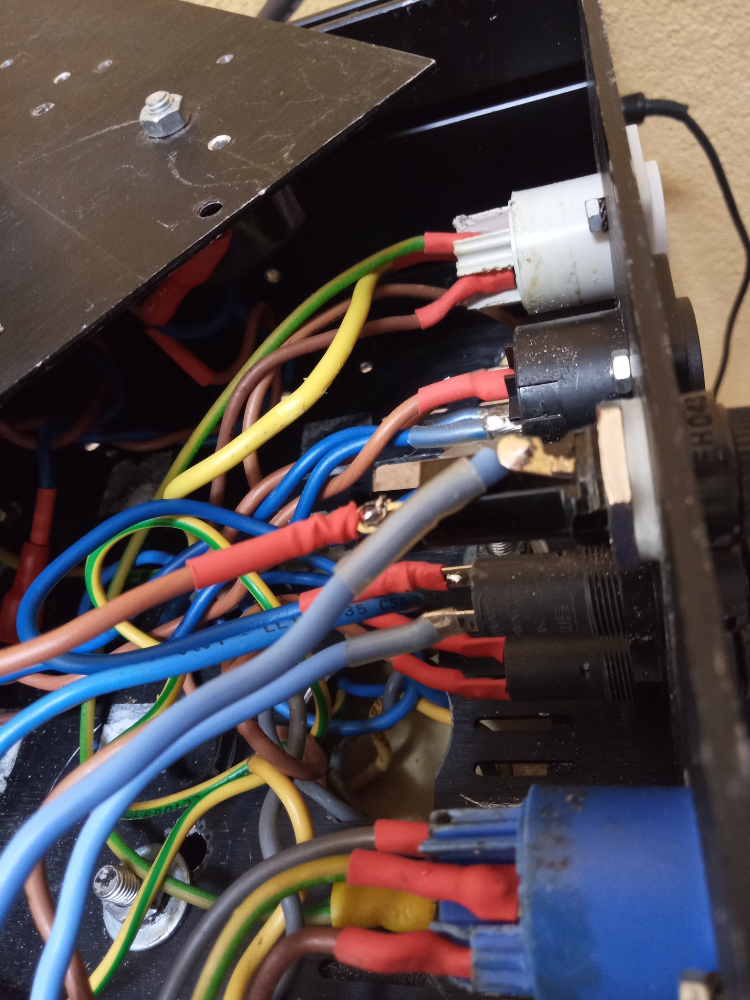

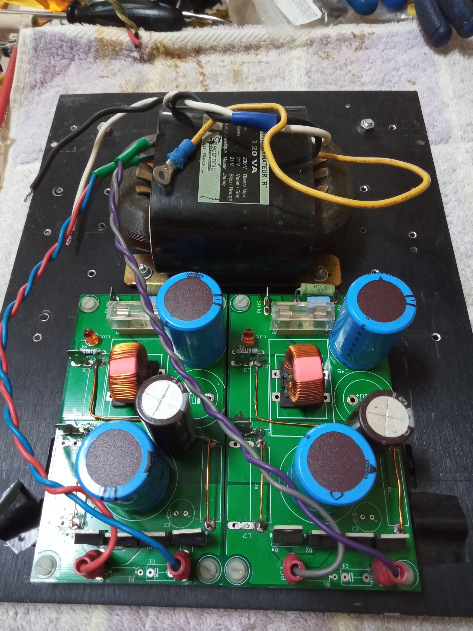

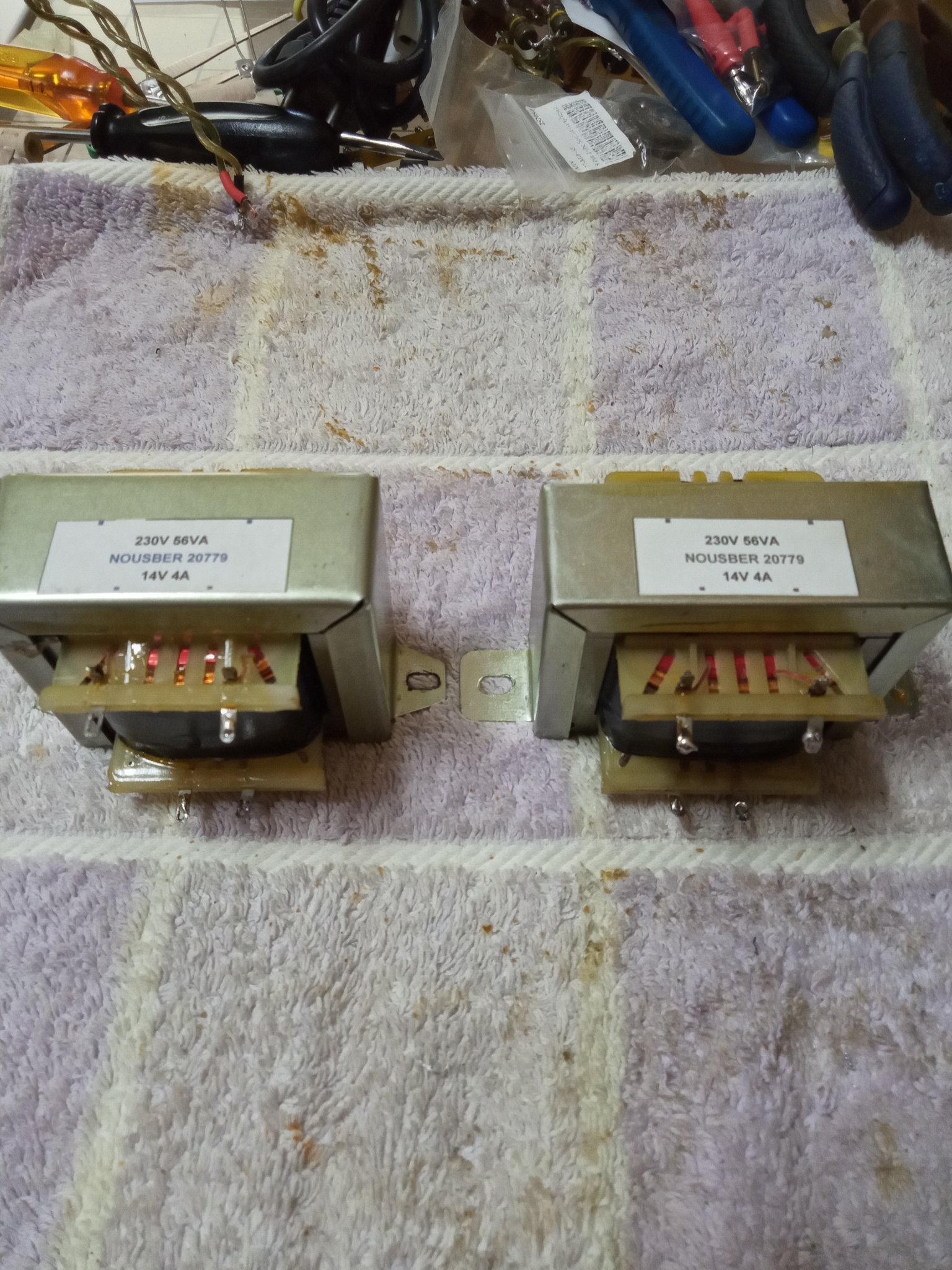

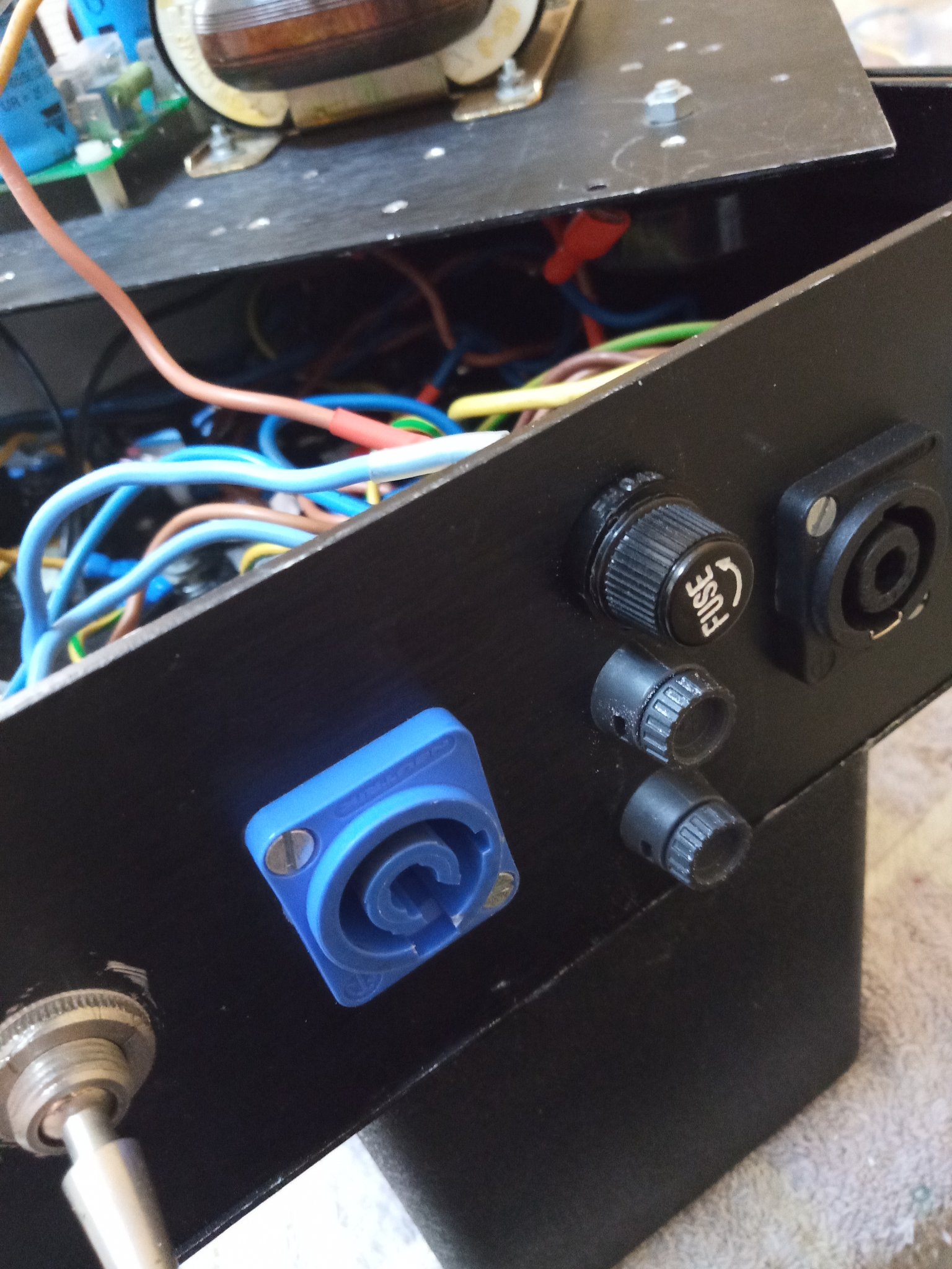

Due to the big power transformer for filaments I had to change the primary fuse to 6A also changed the fuse holder for a biger one, fortunately can left the secondaries 1,6A fuses.
6A a bit overstatement, the average is about 0.5A.
IMO 3A is more than enough .... but ... of course, if you want to weld .... 🙂
I do the maths 230VAC primary : 120VA = 1,91A + 10% tx regulation x 2, isn't correct to protect the primary?

N. B. 2 Changed fuse 6A for 1,6A.

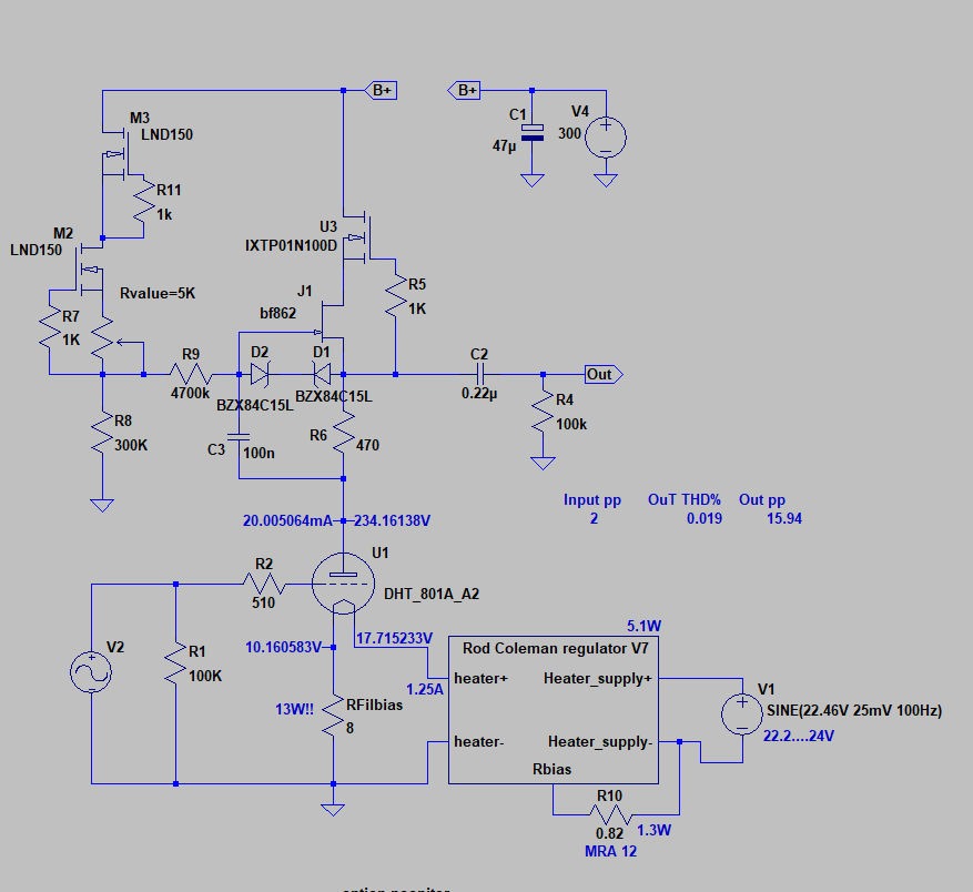

Using cascode CCS both channels as anode load don't reach 20mA @ anode 234V, same CCS worked fine at 20mA for 12B4. Also left channel sound too weak. Voltage across filaments are aprox. 10V both channels. Voltage both filaments 7,5V.

Now two channels with hybrid mu-follower B+ anode both channels 234V as per schematic, right channel draws 17,39mA & left channel 16,3mA.
Filament resistor right 10,54V
Filament resistor left 9,96V

I'm sorry Bela always the weak channel is the right.Using cascode CCS both channels as anode load don't reach 20mA @ anode 234V, same CCS worked fine at 20mA for 12B4. Also left channel sound too weak. Voltage across filaments are aprox. 10V both channels. Voltage both filaments 7,5V.
N. B. Used SSHV2 with CCS set to 60mA.
With both channels with hybrid mu-follower still same problem of weak level at right channel.
