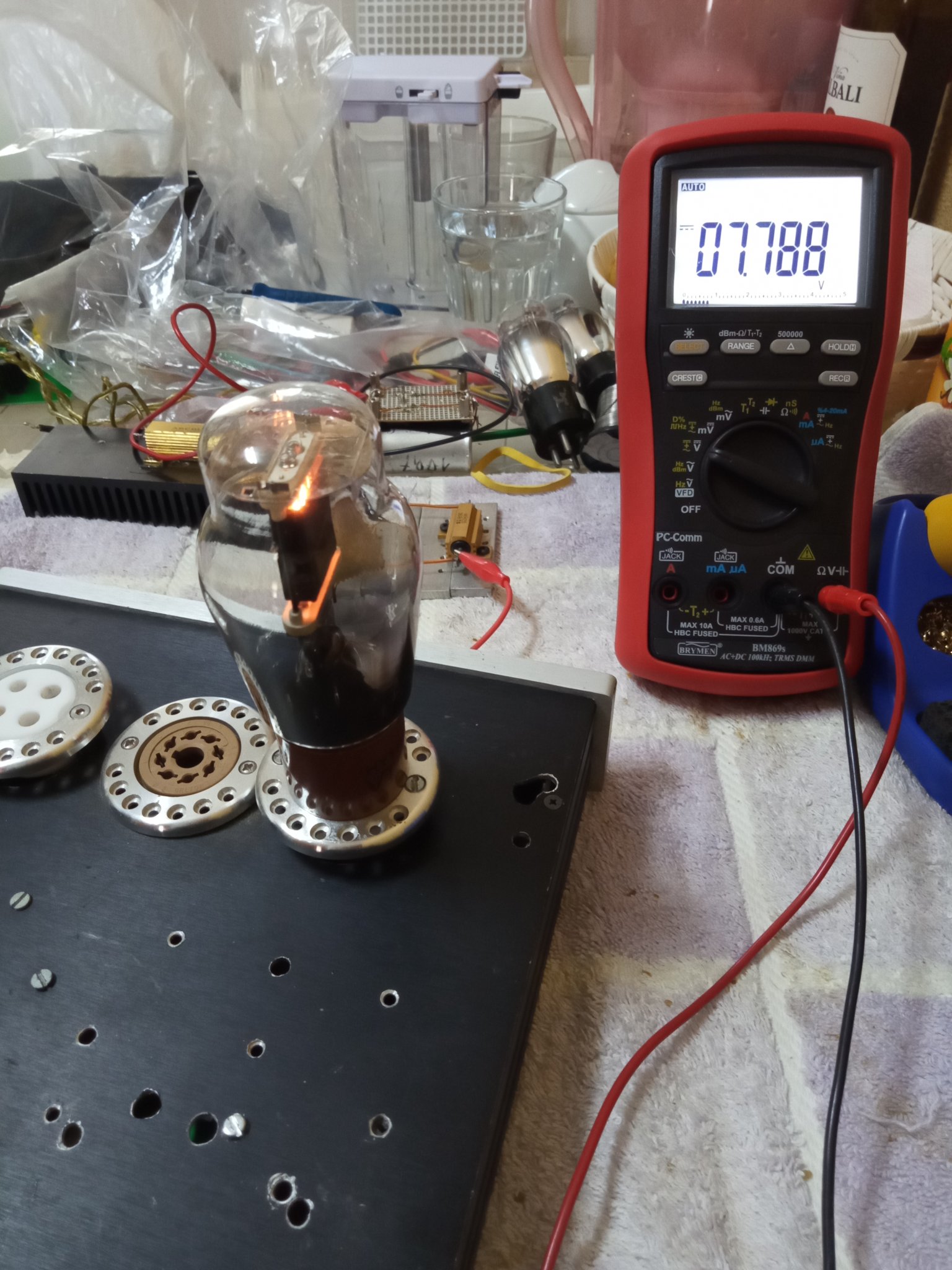

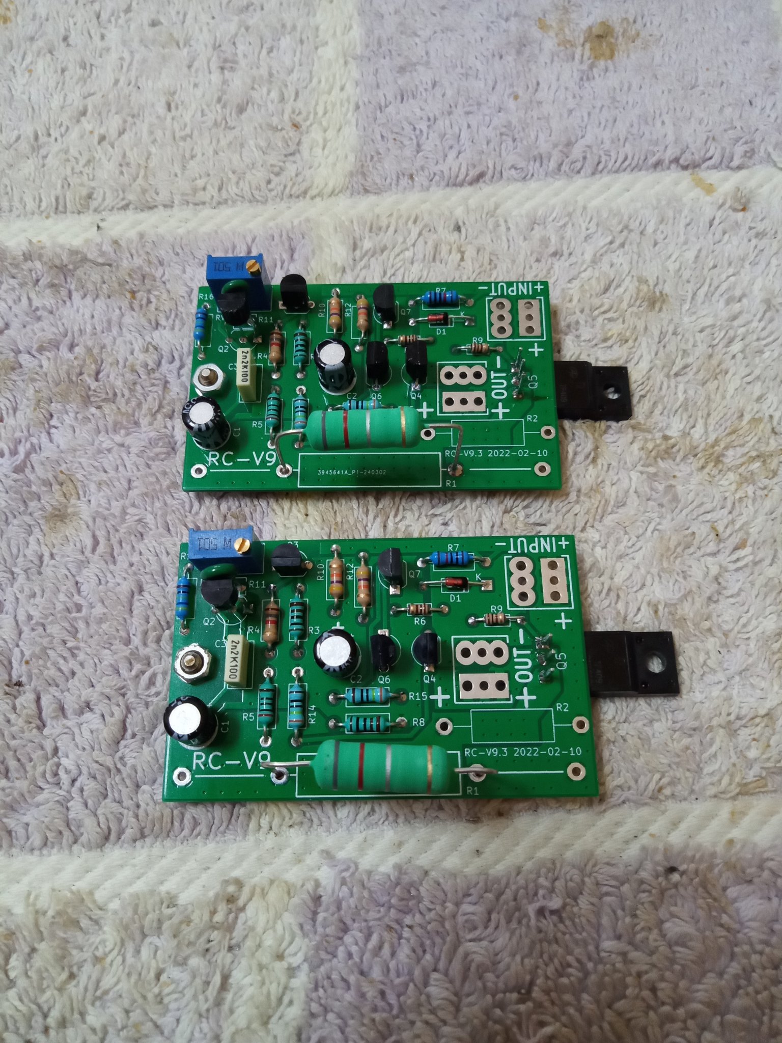

If you have 0.82R, use it.
R1=1/Ifilament
Some years ago I bought box of 1R Mills MRA12, so I used its instead of 0.82R, which was in the kit.
V7 was capable working at 90% potentiometer value with 1.25A.
R1=1/Ifilament

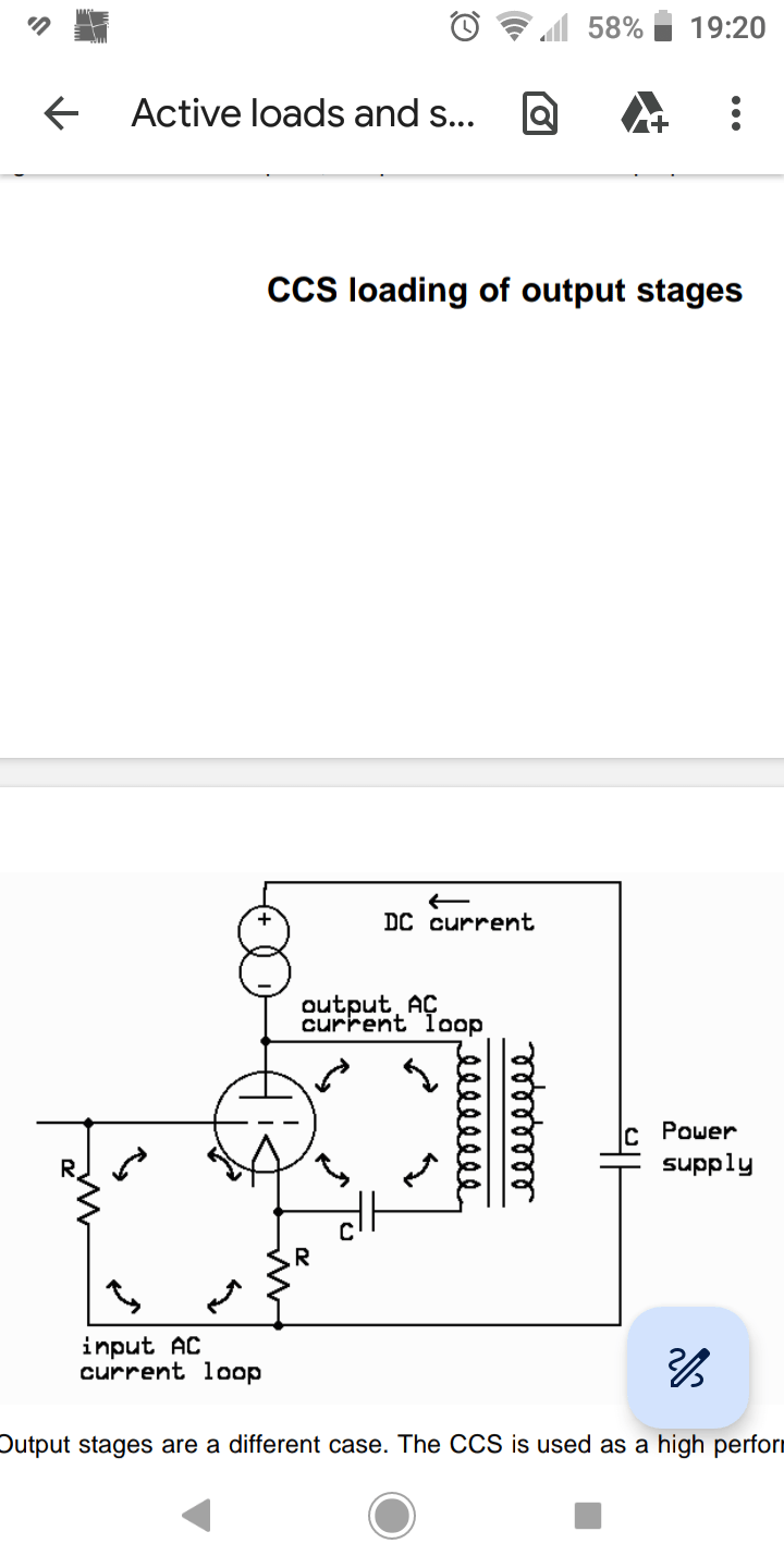

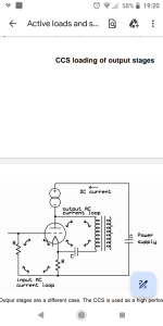

What's the goal of using parafeed OPT in preamp?
Here it only means disadvantage: costly capacitor, costly transformer, degrading bandwidth and distortion.
"CCS loading of output stage"
Apples and oranges....
It's totally meaningless in case of 801a (mu=8) as preamp.
You should decide what you want.
I'm sorry Bela you are right, low mu + OPT left the lineamp with a little gain, no gain or negative gain.🙏
