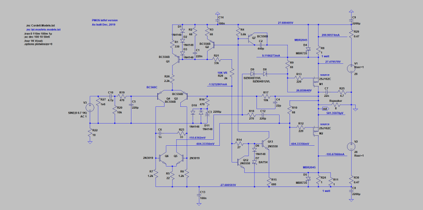

Hi Elvee,
Thanks for your creation. I have built one channel on perf board, and it seems to perform just great, especially piano and vocals. The bass is quite good as well.
I used the prescribed components with TIP3055 as outputs. I used 200pF for C12 for now. My supply voltages turned out to be +- 27.8 V, so I added a trim pot (10K) to R21, to adjust the current through R21. The R21 current is 1.38 mA, and the current through R8 is around 230 mA. I kept the two zeners as 12V.
The heat sinks are barely warm, and less warm than the other class AB amps I have.
Now, on to the second channel...
There was some discussion on having hexfets for the output stage, and you had proposed a circuit with N-MOS outputs. I was wondering if we could use P-MOS devices, so I can just switch the outputs and reuse the existing PCB(perf boarded), without a major sex change operation. Ofcouse I can switch in the higher gate stopper resistors. I simulated the P-MOS version and it seemed to behave well. Are there any down sides in using the P-MOS output devices? This is just for my understanding, and apologies if this is a silly proposition.
Thanks again.
PMOS can work, and are theoretically the shortest path from a regular C to a MOS version, but unfortunately the technology of Si only allows second-best transistors in their P version: they use a larger die, have larger capacitances, higher Rdson, lower transconductance and they are more expensive (and rarer).
If none of this is an obstacle for you, PMOS are OK, otherwise use the sensible option adopted by other members: inverted circlophone, where all the polarities are reversed.

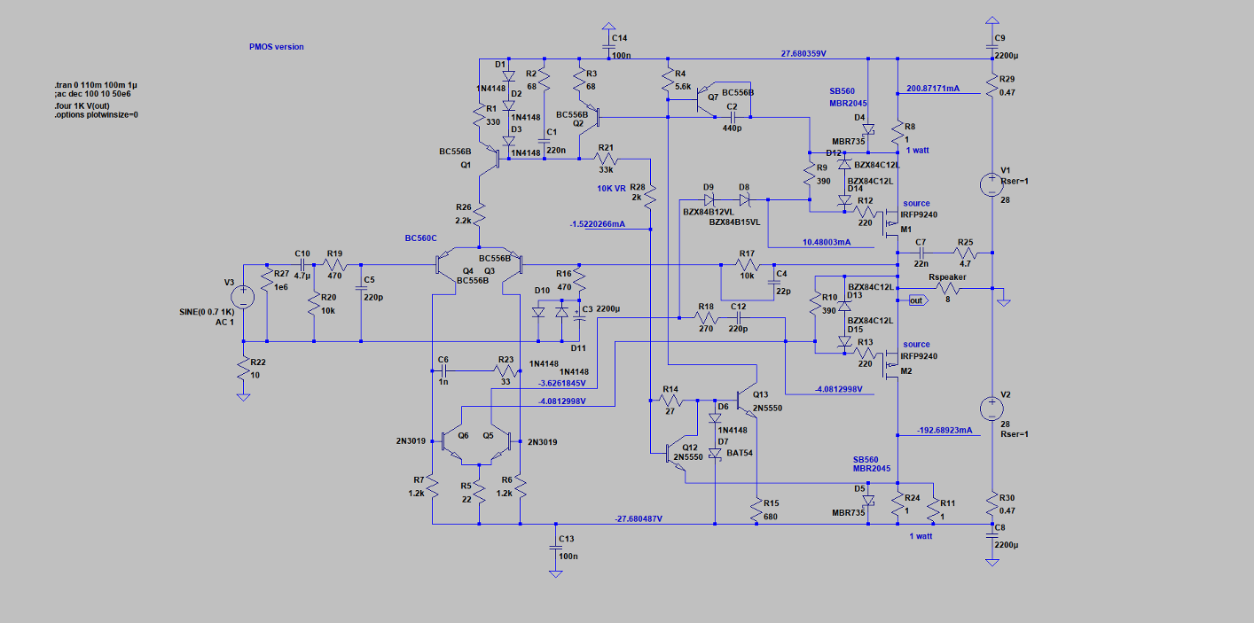

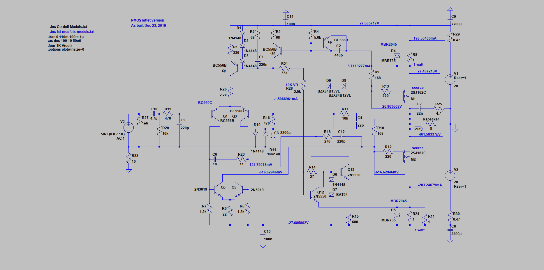

Hi Elvee,
After completing the second channel of the BJT version, I went on to build a modular PCB, which can accomodate BJT, P-MOS Lateral, P-MOS Vertical output stages.
I built a P-MOS Lateral version first and it seems to work fine. I have attached the simulation circuit, and the computed values seem to match in reality. There is 1.48 mA through R21.
I have a question regarding the low current through R9 and subsequent low currents through Q5 and Q6. I was hoping for higher currents, so I can bias the mosfets a little higher. Is there cause for concern or do you think I should leave it as it is?
The sound is spectacular, with details in vocals I hadn't heard before.
I need to build the other channel before trying out the P-MOS Verticals (IRFP9140).
Thanks again for this wonderful and accomodating design.
3mA through Q5 and Q6 is indeed a bit low.
Such a low current could have a negative impact on the slew-rate for example.
It is caused by the large (relatively) R9 R10 and small threshold voltage of the PMOS.
The solution is to reduce R9,10: this will force the servo to increase the current in Q5 and Q6.
A value of 68 or 56 ohm should be adequate.
200mA through the output seems right on target; if you want to increase it (I don't think it is necessary), you can decrease R21
I reduced R9, R10 to 68 and things look good now. There's around 12 - 13 mA through Q5, Q6. I also increased I(R21) to 1.52 mA. The outputs are running a little hotter now.
It sounds very good, and I will keep this configuration for testing. Now, on to the next channel.
Thanks and Happy Holidays!

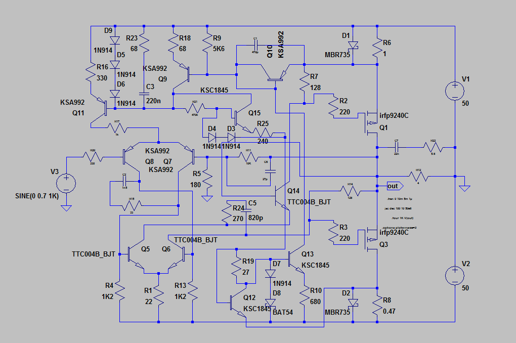

I made a quick LTSpice sim of circlophone with 50V rails,
and IRFP9240 outputs.
It seems to be ok.
asc file + models attached as zip file.
Elvee, do you think it looks OK?
I thinking about building it with IXTN40P50P outputs, and maybe
will try experiment with slightly higher rail voltages...
