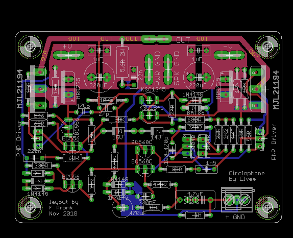

I have assembled the circlophone this Evening,I used project 16's layout. I will upload a photo in due course.

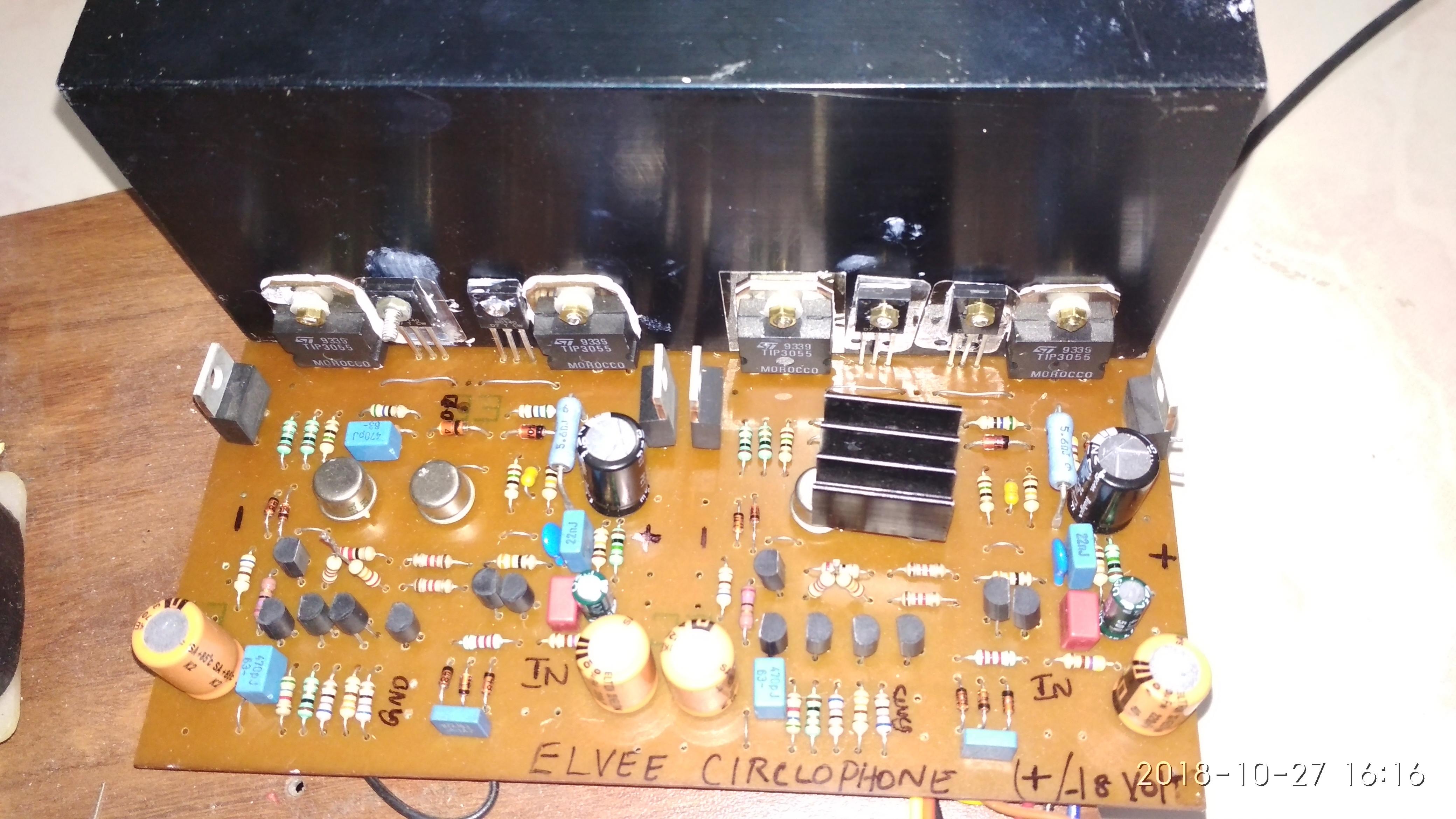

As per Vijay's request, here's a pic of his Circlophone build which he forwarded to me earlier. We auditioned it yesterday with my setup, and it is indeed exemplary as claimed.
Just minor observations:
1) It needs about 5 to 10 minutes of warm-up for optimal sonics.
2) It does better with my modified 2-way Lyrita Horn Grande with 3rd-order Elliptic XO for the woofer and 1st-order for the mid/high, than with an unmodified Technics SB-CR77 3-way. Both have 12" woofers and vented cabinets, but the Technics sounded a bit bright in the upper mids. The Circlophone/Lyrita combo was perfect across the board, and the amplifier almost completely dropped out of the picture, adding no coloration or anything perceptible to the sonics, especially when listening to Indian vocals (that's huge in the local context, because almost everything here has vocals). It has brilliant imaging and instrument separation as well.
3) We tried and then removed a opamp-based pre-amp from the audio chain - the pre- was too veiled and coloured for such a transparent setup.
4) Input coupling caps are Sanyo CZ 4.7uF/50V electrolytics, which measure great on DF (~0.5%, almost on par with Rubycon BG STD). After listening to the audible sonics, I can't really find a reason to substitute these with film caps - I'll reserve the experimentation for future builds if needed.
5) Outputs were warm to the touch, but not excessively so.
6) VAS uses BEL 2N3501, slightly more expensive than BF469/470/869/870 locally - will give the latter a try in future builds. Sanyo 2sc3953 may also be workable - a variety of NOS Chroma transistors are locally available.
7) Power Schottkys are MBR745, which are not always easy to source locally. We'll look for commodity substitutes in due course - there are some inexpensive 5A axial-lead Schottkys around.
To reiterate, this is an exceptional topology with transparent sonics that requires no tweaking or alignment, at a slightly higher BoM than a good gainclone. Highly recommended.

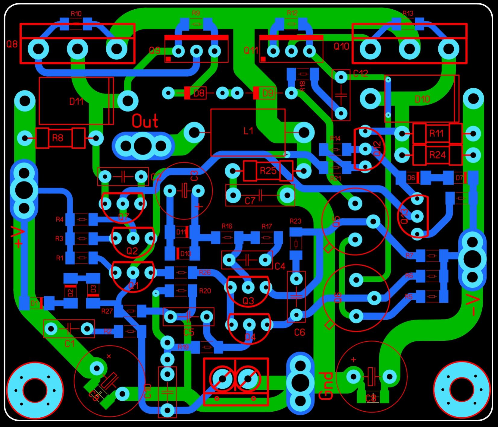

I successfully used TTC004B as VAS transistors on my circlophone. I currently have only one channel working on a temporary heatsink. Testing so far has been rather minimal. Both channels will go into a permanent enclosure next month. PCB is my design: the only significant differences from most other circlophone PCBs are changing the VAS transistors to TO-126, and moving the KSA1220 drivers and MJL21194 outputs to better support mounting the PCB on the heatsink.
Greaat, that´s really good news! I now nothing about pcb design but your board seems really easy to heatsink with only four little 2nd hand HS (actually what i got ;D). I´m guessing someone would be able to switch between 2sc5171 and TTC004B by simply fliping it 180° (since one pinout is EBC and the other CBE?). I may be interested in the future if you have any spare board.
congratulations for your build !
Regards
Regards
The four transistors to be heatsinked require M3 screws. Drilling and tapping your heatsink to take M3 screws is not that hard and is a good skill to learn. The PCB also has four holes for proper mounting but you probably can just use the four transistors to hold the PCB in place.
TTC004B and 2sc5171 seem very similar except the pinout is ECB vs BCE. Fortunately, flipping the 2s5171 180° is all that is required.
I do have a couple for spare boards, and can make the gerbers available to anyone who wants to have their own boards manufactured.
