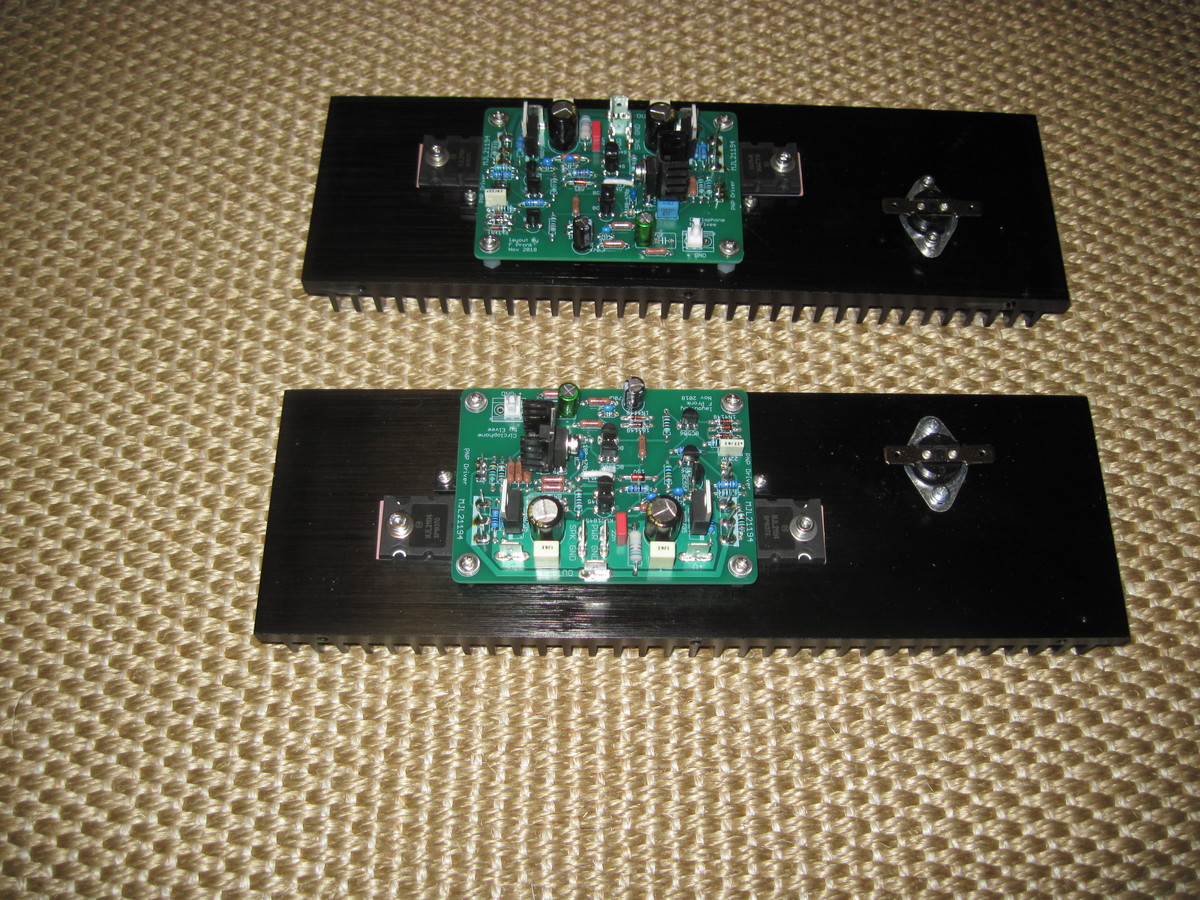

I successfully used TTC004B as VAS transistors on my circlophone. I currently have only one channel working on a temporary heatsink. Testing so far has been rather minimal. Both channels will go into a permanent enclosure next month. PCB is my design: the only significant differences from most other circlophone PCBs are changing the VAS transistors to TO-126, and moving the KSA1220 drivers and MJL21194 outputs to better support mounting the PCB on the heatsink.

I completed this amplifier build about eight months ago and am very happy with the result. Speakers used with this amplifier vary but is currently is an Aplair 10m MLTL. Power supply is a Connex SMPS300RE +/- 35V with an ebay "2409-2" aluminum chassis.
Attached is a picture of the two boards mounted on their heatsinks. This arrangement allows for a more compact build and probably better heat dispersion than with boards designed to be mounted horizontally.
