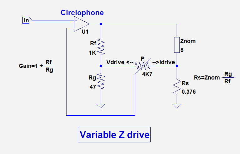

Btw i need to modify the standard Circlophone such that the output impedance is adjustable between "zero" Ohms and some hundred Ohms. I found that particular broadband speakers appear to "like" some current drive. How to do that in a simple fashion? So far no pcb just breadboard wiring
Better to have some improvement than none at all...ok. but using standard Schottky rectifier diodes it is beyond 700 mA and that - besides output swing - matters not?
Here is an example: it is not specific to the Circlophone, and can be used with most "regular" amps having inverting and non-inverting inputs.Btw i need to modify the standard Circlophone such that the output impedance is adjustable between "zero" Ohms and some hundred Ohms. I found that particular broadband speakers appear to "like" some current drive. How to do that in a simple fashion? So far no pcb just breadboard wiring
The potentiometer allows for an impedance variation comprised between Znom/(Gain-1), in this example 0.376Ω, and near ∞.
There is thus a floor to the output resistance, but I don't think it matters much: it is equivalent to a few °C variation of the voice-coil.
Achieving zero or even negative resistances would be possible, but would involve the NI input (tricky...) or an external opamp.
The concept of Znom is required, even if the speaker has a wildly different value at some frequencies, because a comparison base for equal power levels between voltage and current modes is needed.
Note that with this simple scheme, the DC offset voltage of the Circlophone will be amplified by the gain, meaning you should preferably match the input transistors.
DC elimination would of course be possible, but would require another layer of complication
