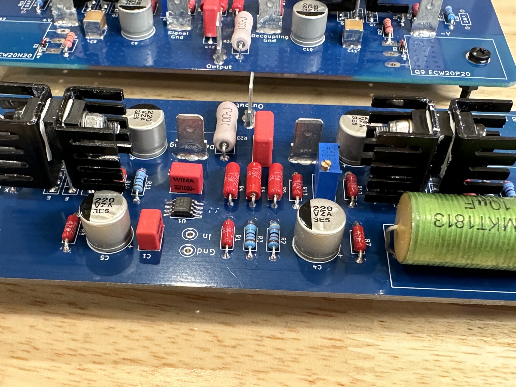

I should have both boards completed tonight with the exception of the LatFets. I need to prep my heatsinks before they get mounted.
Question, I don't remember if Tombo addressed the initial setting of the trimpot before soldering?

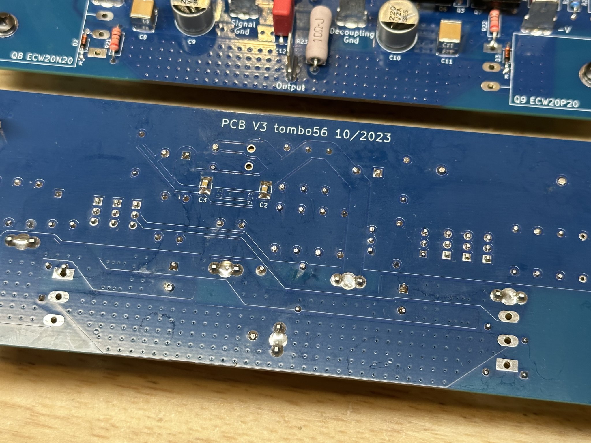

LPCLA boards are stuffed and ready for the next step😁.
These boards are a pleasure to work with! No need to fear smd here, Tombo oversized the pads for very easy soldering. The BJT triplets were assembled separately and gently dropped into the pads, spacing is perfect. For C2 and C3 I used smaller 0805 size 4u7 caps from my stash with the same specs as the BOM.
The next step won’t be as much fun with winter setting in. The garage is cold and thats where the drilling and tapping magic happens.
It doesn’t matter much as bias is limited to about 1.4 A. But, for trimmer orientation as on the picture (adjustment screw head toward PCB top) turn trimmer max. clockwise for minimal bias.
If trimmer potentiometer is mounted with adjustment screw toward PCB bottom, then it should be set counter clockwise for lower bias current.
