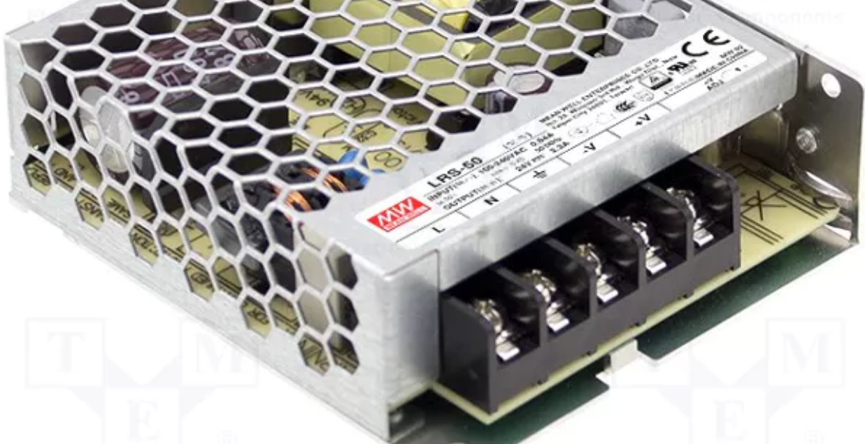

Meanwell LRS-50-15 is a very affordable and good solution to have regulated power supply. Paired with AmyAlice filters, it provides low noise. 👍I’m impressed that your amp is so well behaved and quiet using an SMPS power supply.
Amplifier PCB design uses two outer copper layers as a static shield. That provides additional immunity to RF EMI radiated from the SMPS supplies, so everything should be fine.
I built the F8 with SMPS/AmyAlice and it is dead quiet, so I used it again on this amp - dead quiet again.
Certainly a cheap way to go.

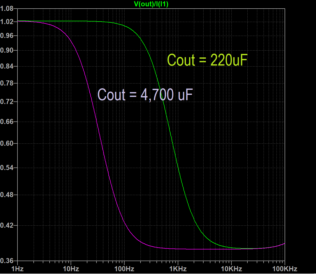

Consider also that capacitance multiplier output impedance is high and good performance relies on the large output capacitor, as is with any unregulated supply.Consider this.
https://www.diyaudio.com/community/...-at-the-capacitance-multiplier-output.389938/
Indeed, agreed. Hence, I will be using your R25 or R21/Prasi combos in my best Class A builds and reserve capacitance multiplier based supplies for my other more “experimental” Class A builds or prototypes. In addition, although rare, capacitance multiplier based supplies have interesting recovery issues that occur during momentary brownouts of the AC line (a rarity in my neighborhood) but nonetheless should be mentioned. When they do occur…HUMMMMM!
For large Class AB designs, especially those with very high PSRR I think I will stick with large cap banks, i.e. Wolverine, etc…unless I am more concerned about voltage rail sagging at extreme power output levels.
The absolute lowest supply impedance is an incredibly important factor to PS design in serious amplifier (and preamp) designs imho.
