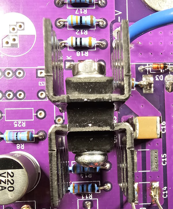

BJTs are tightened together with one screw and two flat washers. Here is picture from my development build. They should be provisionally stacked together with heatsinks before inserting them on the PCB. As a control point for orientation, BJT marking letters are facing toward PCB center for both BJT triplets.
After inserting one pack on the PCB, solder first just one central pin (middle BJT). Then adjust position (tilt) and then solder another to fix position, and if good solder the rest. Finally, align heatsinks and tighten assembly.
Now, when soldering is mentioned. This is a 4 - layer PCB with no thermal reliefs for easy soldering.
If soldering iron is indirect heating 60 W type (900M or similar) it will be real PITA to solder power MOSFETs and power/ground wires or fastons. Crank temperature above 400° C and use fattest tip you have.
With T12/T245 types, that have direct soldering tip heating and higher power, it is easier. Still, I had to wait 10 -20 s before solder would nicely flow at those spots.
