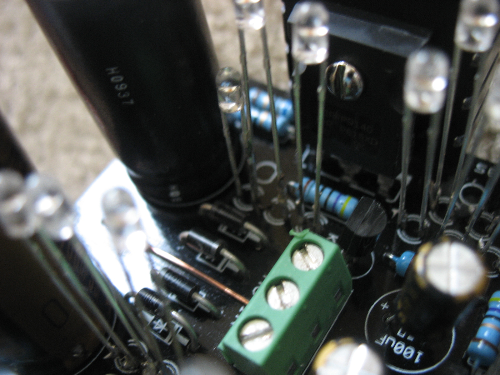

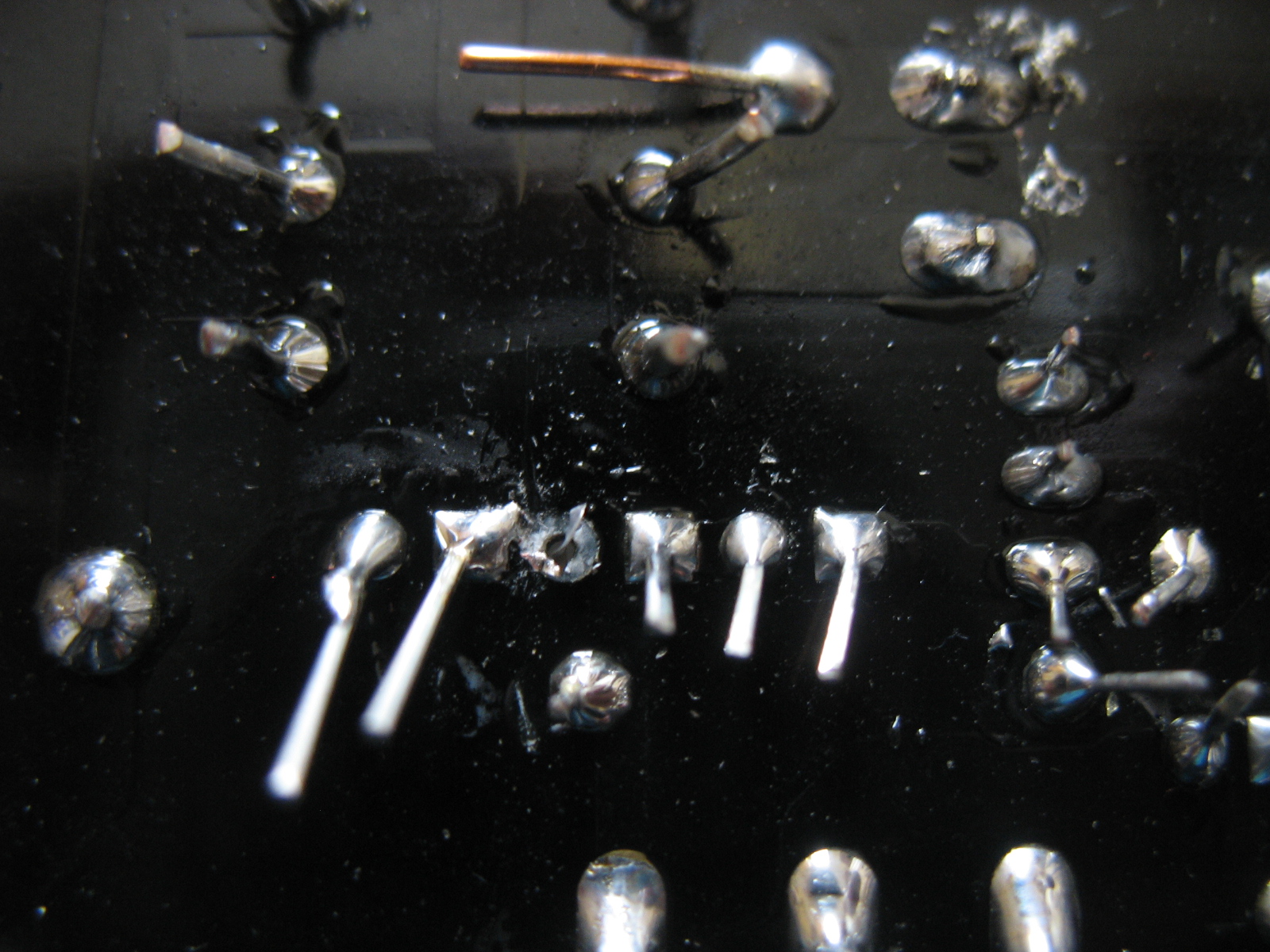

led orientation pain
Yes, even after reading some things on orienting the leds properly, I managed to orient all of them in the exact opposite direction. Here are some pics.
I fixed it by chopping off the tops and re-soldering new ones on the top side of the pcb, although this was not my initial plan. At first, I tried to desolder a couple of the leads of left in the holes, but the pads themselves started lifting. This can be seen in pic 1. So, I used the top side instead. Pic 2, shows the solution to pads that were lifted..... just solder the successive leds' legs to each other.
I hope this helps some other unfortunate soul who might make such a mistake. More pics when final build is done.
(the power led is yet to be fixed 😀)

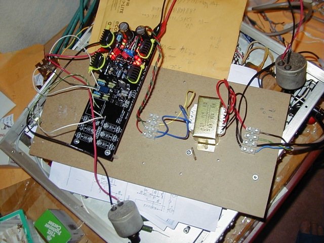

Worry is over, it has been singing for 2 hours with my workbench gears. It replaces a passive preamp by Scott Nixon that I bought a few years ago. The first impression was very positive, the added dynamic and the revealing of the detail were quite noticeable.
I will let it run for the rest of the night to break in.
Thanks Papa, Salas, and TeaBag to make this possible!!
Thank you, Salas.
Here are a couple pictures taken while it was singing. I am not even close to finish. Next will be the chassis which used to host a couple SCSI hard drives ...

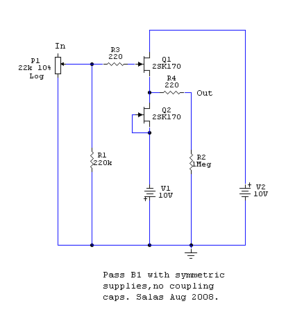

Totally matched is best. If one is slightly weaker, then use it as the CCS S&G connected one that goes to B- (That is the one which we call ''lower'' if you view the pair as given schematically).

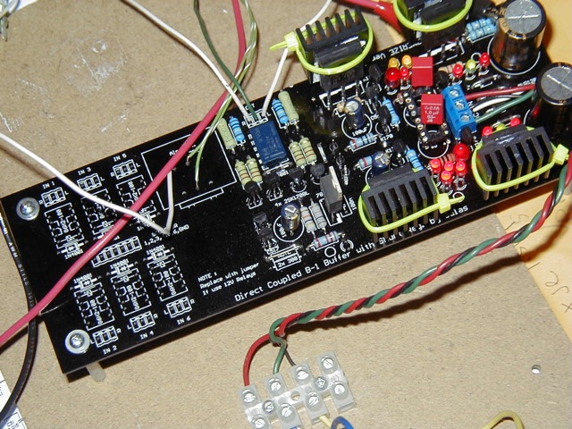

Good day to all!
To clarify by using the output relay as reference:
The matched jfets are 2 pair labeled "4x 2SK170BL" aligned with middle of the board off the end of the relay.
The "lower", "weaker" of the matched pair is closer to the extended center line of the relay.
Sorry if I am being too analytical.
Yes, those 4 jFETs are the amplifiers.
Yes, the middle pair are the CCS and the outer pair are the source followers.
If you have slightly lower Idss and want to use them in the CCS position then the middle pair are where you locate the lower Idss jFETs.
Remember to keep the selected pairs together, either the left pair or the right pair.
If you look at the PCB traces you will see the G & S connected together indicating the CCS duty.
Print off the PCB layout, big enough to fill an A4 sheet. Makes it easy to see where everything goes.
