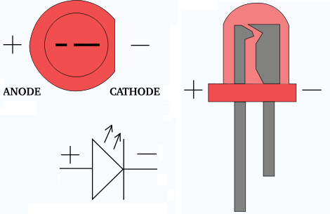

Testing my b1. The leds don't light up at all, but I hear the output relay clicking. Could someone point me to a circuit schematic. I don't understand when people say "measure voltage across R1". What is R1?
I haven't tried measuring the dc offset. But I think as a first step I should get the leds to light up. Maybe, I have them reversed.

There is a place designated as 2 68R positions in parallel. On both sides near the main filter capacitors. There are 3-3 holes actually so to put 3 100R for the same result if not having 68R. Those are in parallel and form the current setting resistor value. Across those you may find a voltage drop of 1.6-2.3V. Shows around 2V in most builds. That would mean circa 60mA which is the current of the basic set up that will survive without heat sinks.
Next to each row of leds there is a D symbol indicating their correct heading. Towards the flat part cathodes go. The schematics are in the first 2 pages.

Thanks Salas. Will check back and report. I have quite a few diagrams for the DCB1 but none that show the names. I will look it up.
I'm getting +-17V instead of +-10V. Also, across the 2x68R, I get 0.77V.
