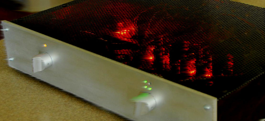

The baby led shunt voltage reference must be a positive contribution too? Did you ever get to hear the LSPD with and without it? The glow through the mesh cover at night must be well, hypnotic.🙂
I'm not sure, I would like to think that it contributes positively, surely it does. The slightly low voltage output may be helpful here also, pushing the "pot" resistance up, easing source impedance constraints just a bit? Still drives these buffers in parallel with no problem at all (110k input). This pre hides nothing, tremendous resolution, and is showing me weaknesses with the rest of my system, poor source mainly which will get attention at some point. Another area of interest, different music / production technique is more "contrasted" than before. Hard to explain but I think it's another clue that the system has taken another step or two up, and is "getting out of the way". Does this make sense?
I'm certainly hypnotized and mezmerized..... several hours per night in fact for the past month....

I talked about the orange LED at post #1295. It's not a necessary component of the LDR circuit. Just a personal touch kind of thing I came up with, gives the front panel a balanced but interesting contrast I think. And a friendly reminder to run the volume at half for a long, productive life of the LDR's when in "standby" mode.
Front LED's are run by an 8V regulator, with appropriate dropping resistors of course.
