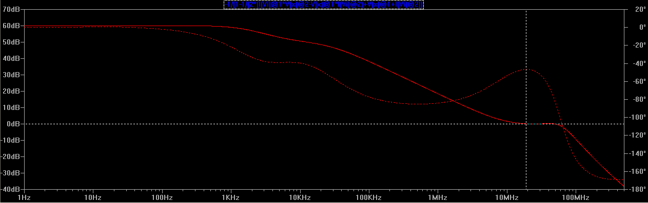

would you advise on audio quality brands resistors for shunts, gate stoppers, audio part
why do we need carbon films for gate stoppers and how much watts
are PRP or RN Dale good enough for both - shunts and audio part

Carbon is generally a better practice for gate stoppers and grid stoppers because they present no resonance dangers with parasitics. In this particular shunt the theoretical phase margin is vast (over 130deg) and normal 1/4W metal film will work too. Still, carbon stoppers are good not only to avoid real oscillations if a design is on the verge, but transiently a preferable measure. Minimum impact in this case though. I don't find subjective influence in the shunt from resistors. Dale and PRP are very good in the audio part, in the shunts part only capacitors matter, and I would save money by using generic resistors in the shunts.

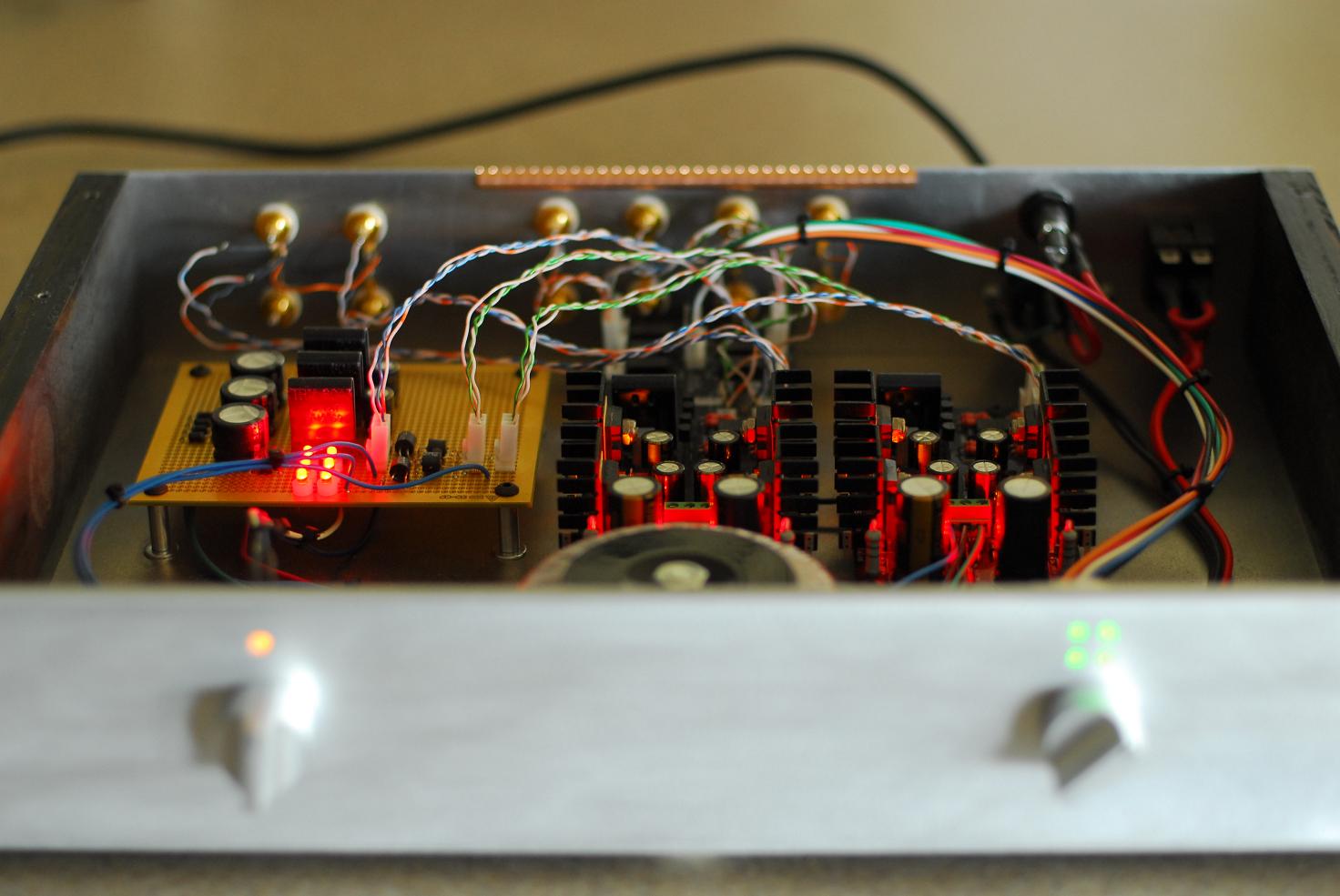

Did I get lucky? I feel lucky...
My local electric service is over the top, literally. The transformer sits at the corner of my yard. I have ~122 VAC. Along with this I am using a "25.2 VCT" transformer. It is pretty generous as well.
I have +/- 14.7 VAC rails going to this. I hoped to be able to "hot rod".
V across R1's are 1.462 & 1.502
The output relay clicks.
DC offset is .001/.003 V
Vout is 9.48 & -9.19
The mosfets are P140 & P9140. I do plan to heatsink them.

Your results look nice Ed, have you heard it already?
Delight us with a close up picture from the board 😀
