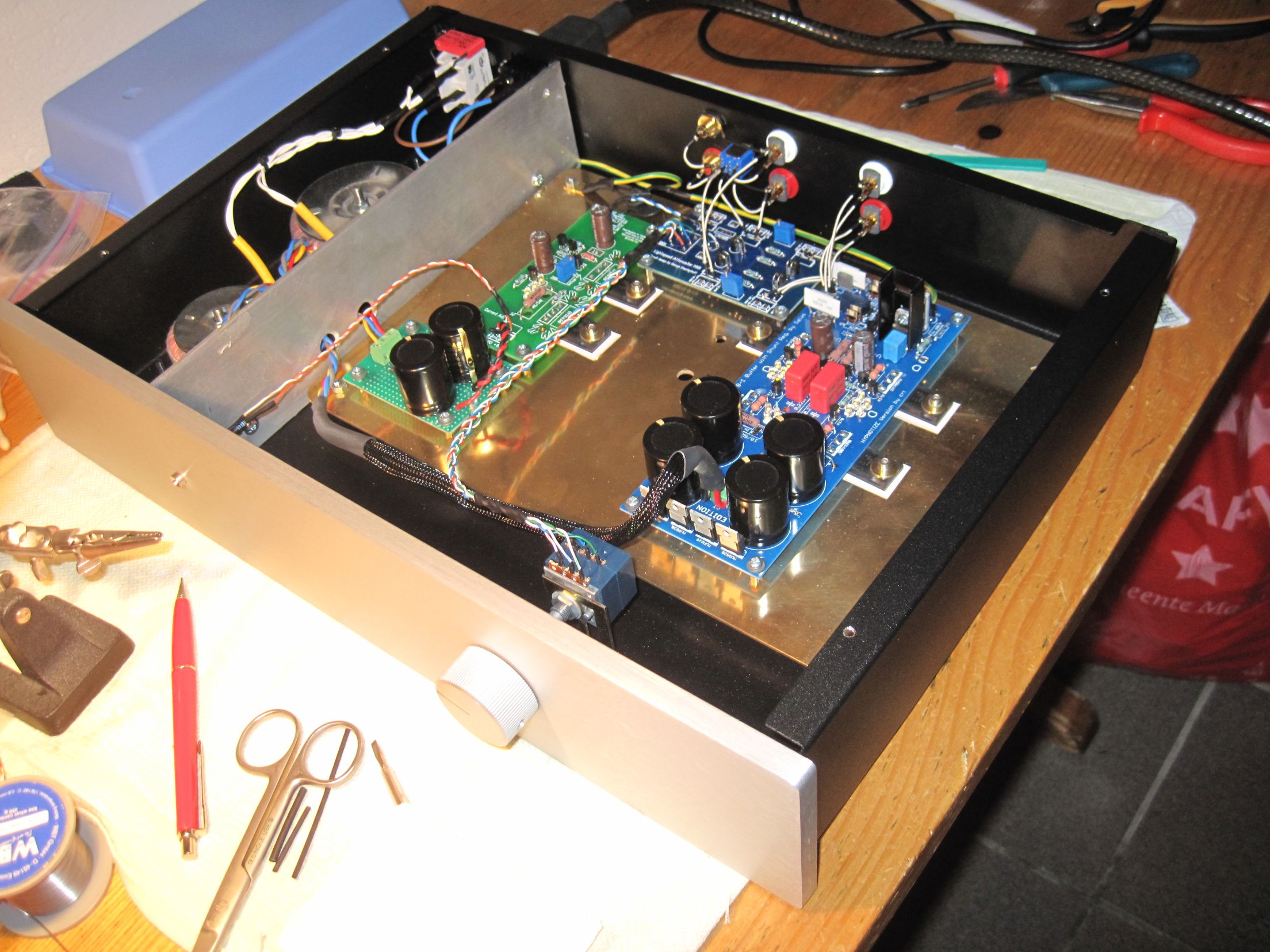

DCB1 evaluation
Salas, the DCB1 is playing now for a few days and I must say it sounds super. Sounstage is suddenly much bigger, wider and deeper, there is more body, piano is clear and has weight, bass is thight and has punch. Voices are accurate without sharpness. It puts a big smile on my face with now and then disbelieve of things I really didn't hear before. The F5 is today ready too and already makes a good couple, needs a bit more burn in. Thank you and Tea Bag, dvb-projekt, spencer and others. 🙂
