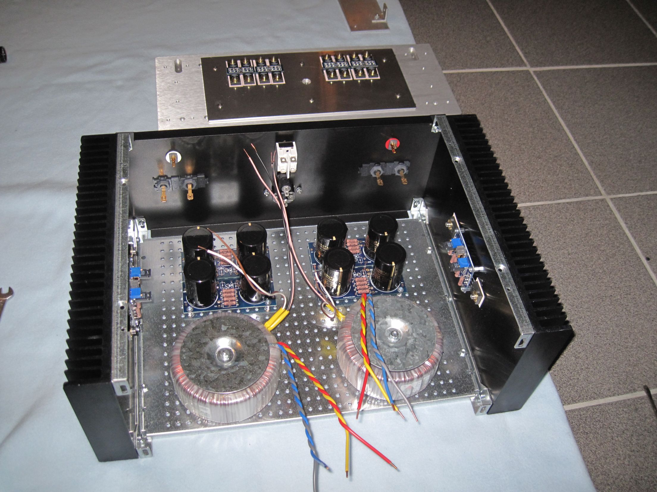

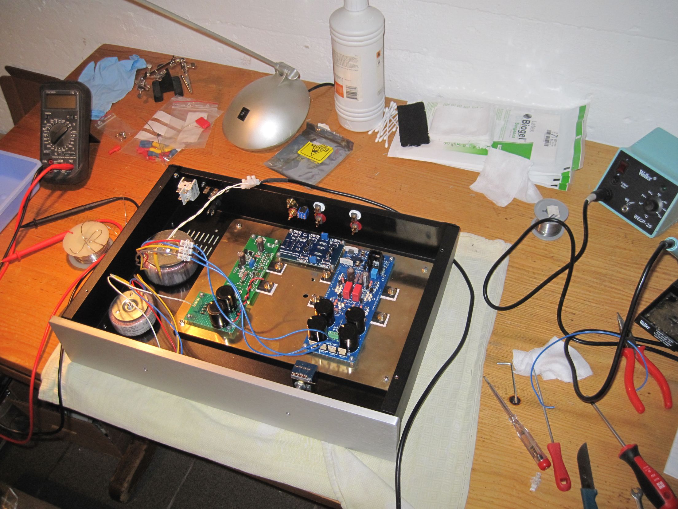

Building a symmetrical PSU B1 buffer

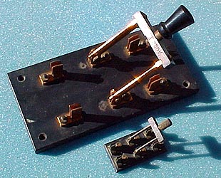

I....guess....this could even be considered an alternative for your power switch.
(Be careful. Wiring "mains" circuits can be deadly. Have an experieced friend assist you--and have them double-check your work)

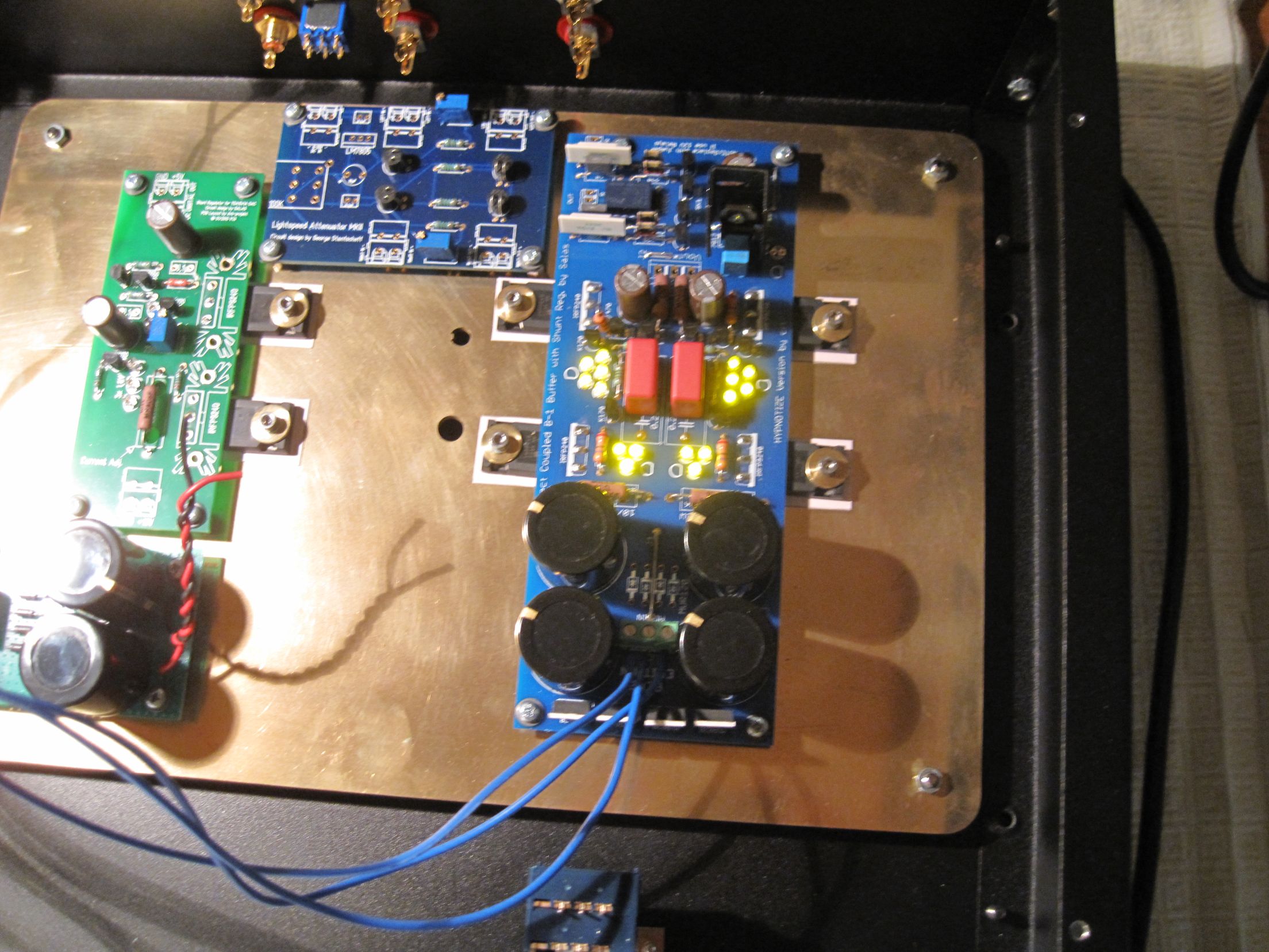

If I want to hod rod the DCB1, would the heat sink on the BOM sufficient?
Would the measurement any different between standard and hot-rod ones (like DC offset)?
Thanks!
No its not sufficient. Get 1C/W common sink per rail Mosfets or use a sturdy metal plate enclosure floor and mount Mosfets like in some power amps under PCB (like they do sit ups). Isolation pads are necessary when the Mosfets backs are on common metal resting place, else...smoke. Yes, they will measure a little different for current setting some times because Vgs of Mosfets changes with current and temperature. Also the audio Jfets can change offset a bit in a hotter environment. Anything under 5mV is not alarming.

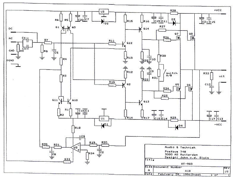

The present amp is A-18, Hawk, designed by John van der Sluis, Netherlands, see scheme. No pre-amp just a 100k log pot.
If the amp schema had values we could figure out the gain, has enough open loop gain to allow set it conventionally as far as the topology hints. To check any CDP's RMS output, a 0dB sine wave from a test CD (preferably below 1kHz) and a DMM set at VAC would show.
