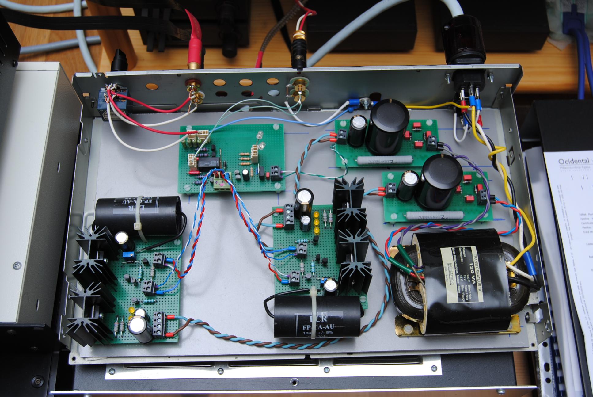

I am sorry but I could not resist the temptation to post this pic of my P2P DCB1 build.
It is using V1 shunts but it will soon be upgraded with a Reflektor pair.
Even now, it sounds better than My Pedja buffer with V12R.
I wish I could have a simple DC detector to add just for safety because my meridian 103 amp does not have any input cap and no DC protection.
Hope those Bourns Vref trimmers do not fail during my listening sessions.
I am having difficulties setting the same DC offset on both channels because the PSU is common to both.... Maybe i should use a separated PSU for each channel 🙂
One led lights on power on and dims after the relay closes.
The other led lights up when the relay closes.
I will choose what to use when I finish the case.
I must build the new shunts in the first place and I want to include a DC sensor to open the Relay if it senses more than 2mV on the output.... maybe a mosfet can de used for that purpose.

That is a mighty ambitious target.
2mV for how long? 1second, or 10seconds, or 1minute?
20mV for how long? 1millisecond or 10milliseconds or 100milliseconds?
200mV for how long?
Do you see the problem.
You have to decide what the next stages and equipment can tolerate for what period of time. Then design to trigger just in time to protect the equipment.
