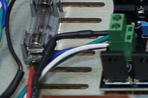

Where are you sourcing 12vdc for the LED?
Pass DIY Addict
Joined 2000
I used the AC secondary going into the regulator - I didn't want to pollute the nice regulated DC that feeds the Pearl boards. I added whatever 1N4004-like diode was in my box on one leg followed by a 20k (adjust brightness to taste) resistor. Diode first, then resistor, then LED. Both are wrapped in heat shrink. The other leg just returns to the other end of the secondary.
I've attached a cropped image - it's a bit grainy though because this was not the focal point of the original image. The green & blue are the standard Antek secondary, the white and black power the LED. Technically, the LED is blinking at 60Hz, but I can't see that fast😉. If your AC supply is higher, just use a larger resistor. You could drive it right from the 120v mains if you want with the same arrangement, just pick a 100k-150k resistor...
I used the AC secondary going into the regulator - I didn't want to pollute the nice regulated DC that feeds the Pearl boards. I added whatever 1N4004-like diode was in my box on one leg followed by a 20k (adjust brightness to taste) resistor. Both are wrapped in heat shrink. The other leg just returns to the other end of the secondary.

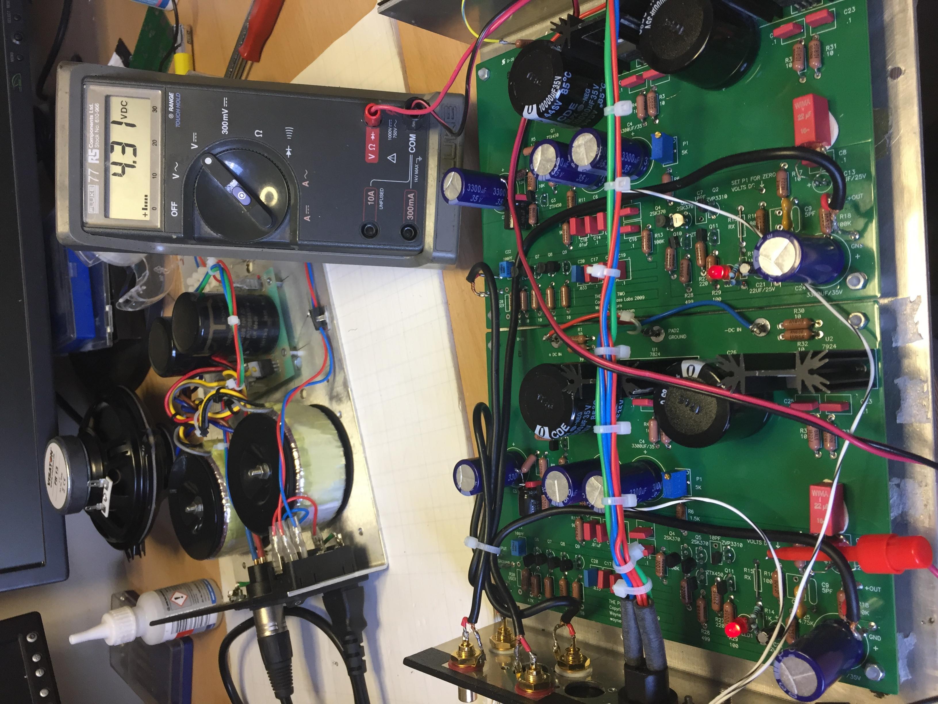

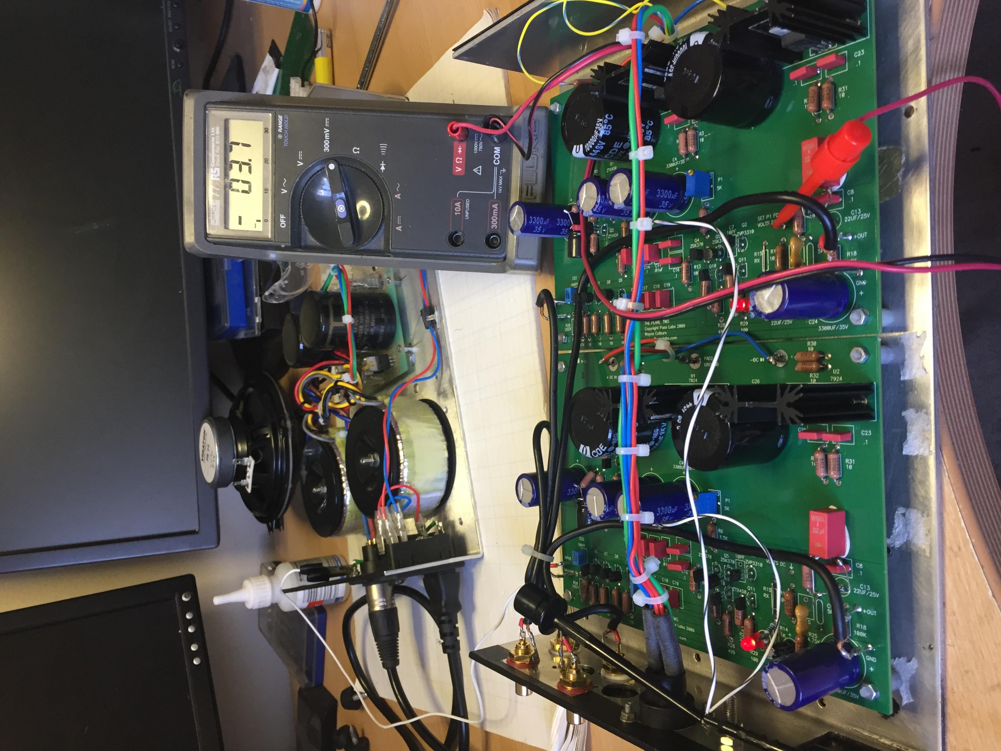

Need a bit of help Guys..
Built a Pearl II quite some time ago Apr 2017ish. My issue is the P1 0 volts. I could never obtain a steady state 0v rather it would float from - to +mV as much as 100 in both directions but from time to time would hold a steady + - 10mV but over a period of say 10 minutes it would go off on one but would come back to 0 then off in the other direction.....
Now I have a P1 of 4.0volts + . Which sets up a horrid crackling while listening. DC on the out is less than 10mV at this time.
I can tweak P1 back via the 5K pot but over long periods (many months) it creeps up again. (well its done it twice now) As the P1 0v move up the sound degrades so I know what to expect.
TIA
TIA
You can solve this by inserting an electrolytic cap between R14 and ground (47-470 uF), many have done that. I believe bypassed with a small film cap of 0.1 uF or something like that. Search this thread and the Pearl Two thread. On a previous build I put an Elna Silmic II of 100uF in there and the DC was stable at 0V. At the moment I'm rebuilding the Pearl on the official boards. I will try without the cap first, but might go this route id DC is not stable within reasonable margins.

Here is what Wayne had to say about adding a cap to reduce offset drift (I don't have the direct link, but it's in this thread somewhere). I did this and it worked great, DC offset is now rock solid very close to 0.0mV.
"The cap in series with R14 (on the ground side, but being a series arrangement either way should work) keeps the DC gain at unity making the DC offset more stable. Use a nice (Silmic) electrolytic 47uF - 470uF works fine, 25v or more and use a film bypass if you want. Just lift the ground side of R14 and connect to the + lead of the cap and the - lead goes to ground. A bipolar cap would work here also but a standard electrolytic will work and they can take small amounts of reverse voltage but this shouldn't be a problem. If you get it all setup and adjusted you may not need output cap.
Leave P1 in it adjusts the DC offset. You can maybe remove the output coupling cap if you use the cap in series with R25. Short the cap out with a clip lead adjust P1 for the best you can get then remove the clip lead."
