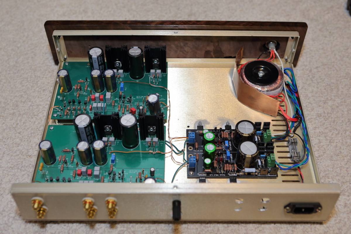

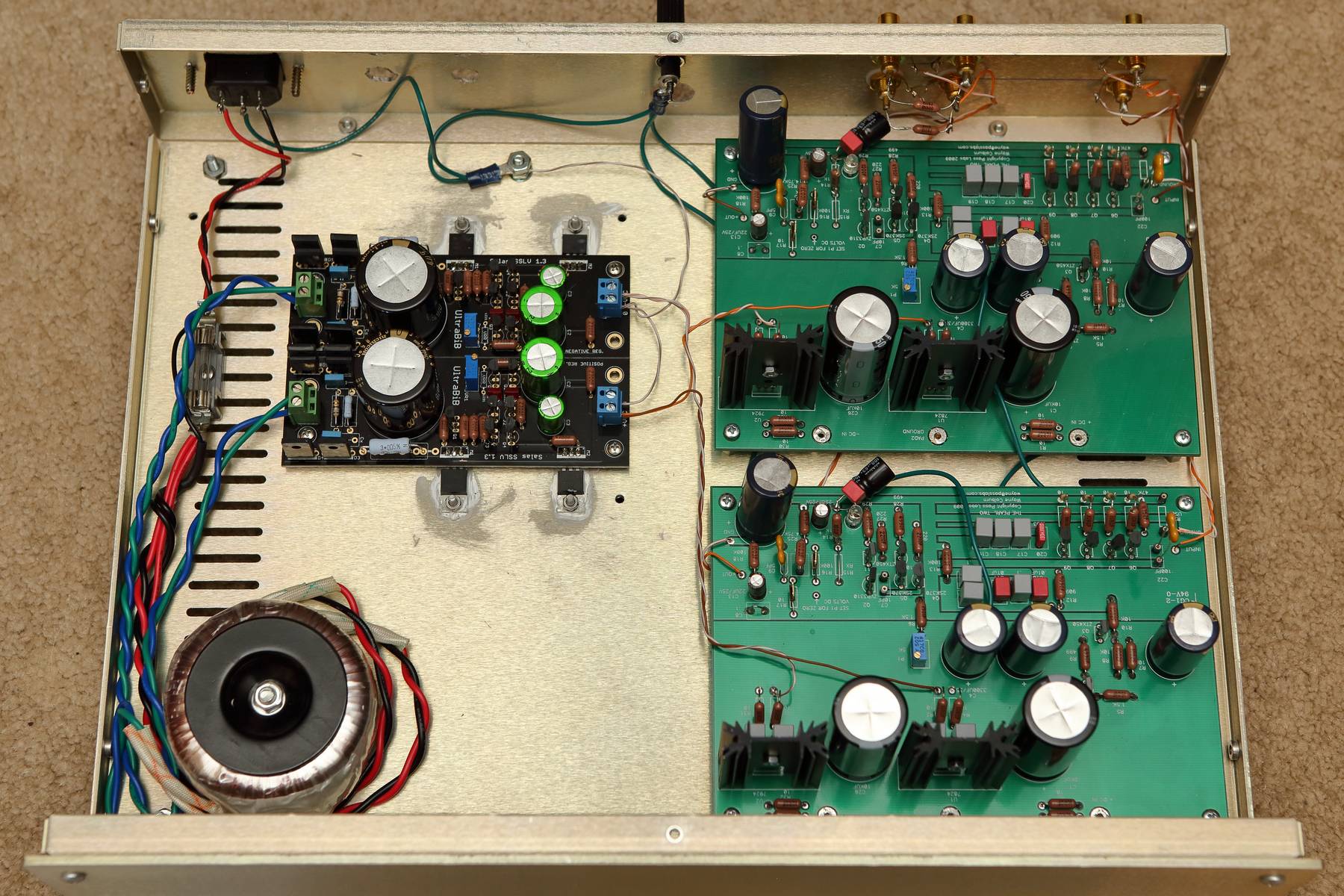

I recently rebuilt my Pearl II so the power supply is inside the box (got one shelf back in my equipment rack!). I used an Antek 25VA transformer and it works great. I'm not sure whether I used the 22v or 25v version of this transformer - my notes have a conflict in them. It was probably the 25v version to give the regulator 10v of headroom...
The transformer drives a Salas BiB v1.3 regulator that is set to draw ~200mA for each rail. The negative rail on the Pearl draws about 42mA for both boards, the positive rail draws about 84mA for both. The little 25VA toriod gets a little warm with the constant 400mA draw from the regulator, but certainly nothing to be concerned with.

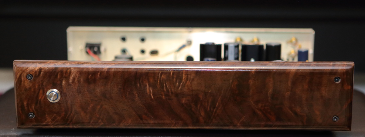

I don't think this was necessary, but I added a small copper shield around the transformer to help corral the AC power wires and dressed it up a bit by replacing the metal front plate with a nice piece of figured walnut wood that I finished with tung oil. I added a front panel power switch and changed the grounding configuration a little since this image was made. I'll post an updated image with the wooden front panel tonight when I get home.
The result is nice and quiet with no AC or ground hum. In one channel, I get a very slight "popping" sound with my ear to the driver at full volume. I think Jim described as the popcorn sound inherent to the jFets.

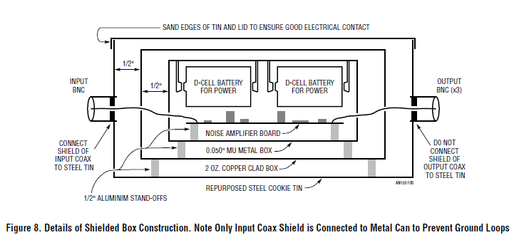

Best thing you can do to avoid the field from a trafo interfering with the Pearl is to use separate housings and an umbilical. Better yet, if you can find a small rectangular "tin" box, house the preamplifier section therein.
I am afraid that the way the ground pour was designed for the Pearl 2 PCB leads it to act as an antenna. The sketch below is from a Linear Tech application note. We are not worthy!

Here is a picture of the copper shield I put in front of the transformer. Although it doesn't look like it from the angle, it stands taller than the transformer - almost all of the way to the top of the chassis. I don't know that it really makes a difference, but I had a spare piece floating around so I used it.
The other image is the walnut front panel with an illuminated power switch. The camera doesn't really capture the way the grain appears to shift when the angle of the light changes. It really looks much nicer in person.
