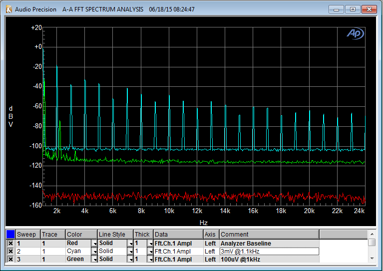

Pearl 2 design for MM cartridges: I've been observing high THD on the 2 which I have built on the PassDIY boards. Went back to the simulation and ran an FFT on the AP with 3mV (cyan) and 100uV (green) signals. Baseline is red.

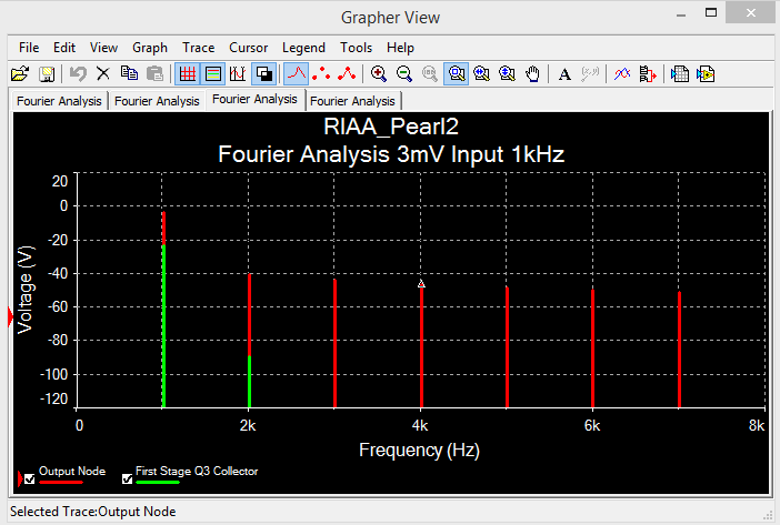

Chart to the left is simulation in Multisim. Red is the output node, green is the output at the collector of Q3.

You can "somewhat" fix the Pearl 2 for MM by changing the compensation network to "active" (think R15 // Cxa, R16 //Cxb) but there is a nasty zero @20kHz which requires a bit more compensation.
In the active version, of course, the gain will be set by (R15+R16)/R14.

Perhaps you can glean some info on the overload margin of the Pearl 2 second stage from the chart below. The X-axis is input to the second stage with the compensation network removed:

In any listening test, you have to control for the output level, and even 0.5dB difference will make a very significant impression upon the listener. The Pearl 2 is rated for +55dB, most MM preamplifiers are +35 to +40dB.
Overload margin is a significant issue -- from the HMN article:
4. Freedom from overload and blocking. This is another point where "classic" circuits fall flat. Let the cartridge mistrack or rattle slightly, whack the rock and lever that we laughingly call a "stylus and cantilever," and that 50kHz ding-dong resonance kicks the input stage in the groin- remember, magnetic cartridges are velocity sensitive, and though the mistrack is only momentary, that tip resonance is a lot of velocity. A minor disturbance (a swift kick) can turn into hundreds of milliseconds of overbias (rolling on the ground, gasping for breath).

The Pearl will easily overload with MM cartridge.
