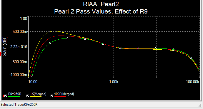

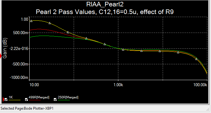

Your values fit with the calculator, but only when Ro from first stage is zero.
The Zout of the first stage should factor into the final result of the network design, but it's not 499R, it should be much smaller. Zout for a cascade gets into some matrix math...
At any rate, I took a look at how the value of R9 would affect compliance to the RIAA curve. I normalized the outputs to 0dB @1kHz. The first chart are the values I am using via Lipshitz with the coupling cap (C12/16) value changed to 1uF, the second are the values from the Pass article and the same change to the coupling cap (1uF), the third uses the 0.2uF values per the schematic.
