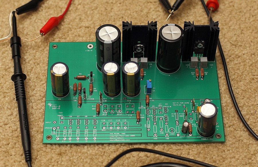

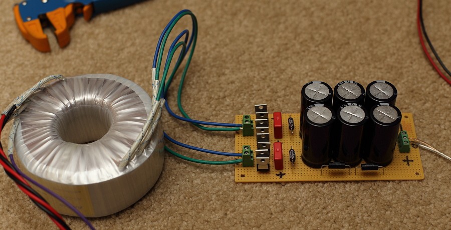

Just finished the outboard PSU for the Pearl as well as populating the onboard regulators. I've used a 28v transformer with CRCRC filtering (10,000uF and 10R). The outboard PSU provide 39.2VDC to the onboard regulators, which provide 24.3VDC for the rest of the board.
Everything looks OK, but I'm thinking +/-39.2V is a bit high for the 7824/7924 which specify a maximum input voltage of 40v. Should I put in a few diodes to drop the voltage down a bit?
I've also never used bleeder resistors in a PSU before. These are 2k2 3w and run at about 58c. The datasheet says they max out at 350c, so I presume they are good at this temp.

I was thinking of trying so 20r resistors that I have, but was wondering if they would do any good to bring down voltage since the power supply measures 39.2v all of the way through. It seems that the Pearl does not draw enough current to really make the resistors do much to the voltage.
I'll stick a set of resistors directly after the rectifiers to see how this affects the voltage.
Series resistors after the rectifier will make a noticable drop. It should work great! Also make sure you use large dissipation resistors, as the AC component that they see is quite large.
If you can take a scope shot of the before and after, that would be cool... filtering like that is extremely effective. (As it's so lossy.)

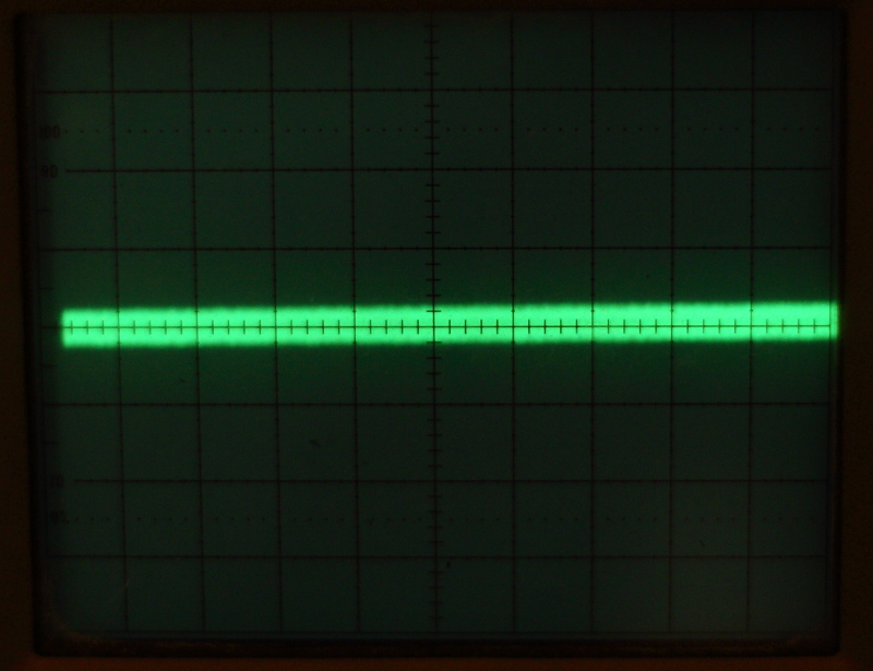

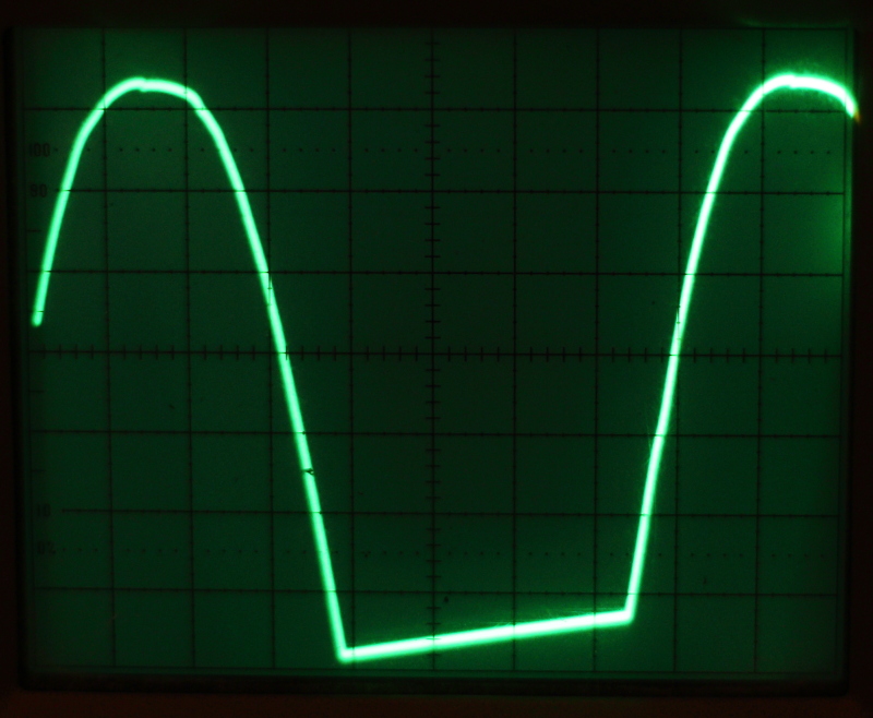

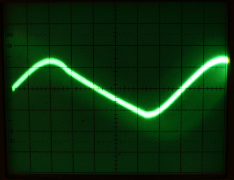

Did some measurements with various amounts of resistance placed in various places in the PSU. I'm using a 28v transformer, MUR820 diodes, 0.22uF film cap, 2k2 bleeder resistors, followed by CRCRC made of 10,000uF and 10R 3w resistors. This configuration provides 40.0vDC on the PSU output
To make any real impact on the output, additional resistance needs to either be directly after the rectifier or at the output from the PSU, after the last cap. Also, to make any real impact, the resistance needs to be rather large.
Placing a 20R 5w resistor after the rectifier provides 38.2v out from the PSU, which drops to 37.5v when one Pearl channel board is connected to the PSU. Changing this to 40R after the rectifier provides 37.0v out from the PSU, which drops to about 36.0V with one Pearl channel board connected to the PSU. Both of these changes are a little boring - not much happens here.
If I put a 1kohm 1/4w resistor on the output of the stock configured PSU, it drops the output voltage down to 32.8v with one Pearl channel driven. I figured this largely killed the value of all of the capacitance in the PSU.
Things got interesting, though, when I put a larger resistor after the rectifier. I tried a 390R 3w resistor and this dropped the PSU output to 23.8v - too low to be useful.
So, I paralleled two 390R 3w resistors (~200R) and this provided 26.3v DC on the PSU output when driving both Pearl boards, still enough to drive the output of the Pearl regulator to full power at 24.3v.
Three images from my scope are below. The first one is taken directly after the rectifier and before the paralleled 390R 3w resistors. This shows 5.48v AC ripple (1v/division) The second image is taken directly after the paralleled 390R resistors and shows 3.6mV (2mV/division) of AC ripple - quite a reduction in ripple! The final image is from the output of the PSU after the last cap. Scope is set to 2mV/division and shows less than 0.1mV ripple.
I will try one more configuration with ~100-120R after the rectifier. I'd like to give the onboard regulator just a bit more headroom.
