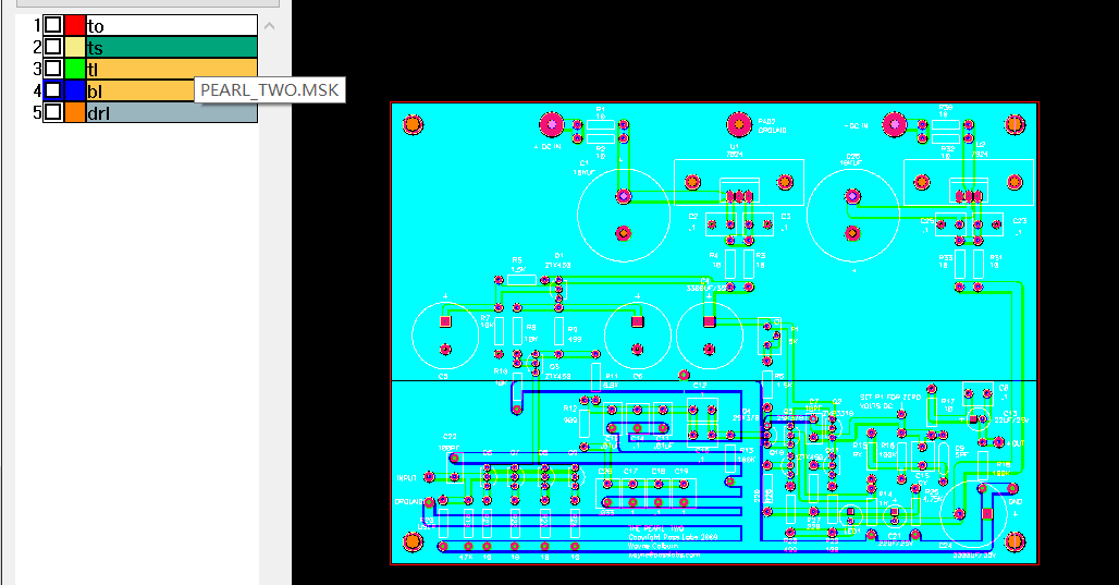

Good morning to the great DIY community. I would like to build the pearl 2 phono and from the passdiy site I followed what is reported: To build your own PCB boards download both Pearl files: file 1 and file 2.
I downloaded the two files and created a single zip uploaded to jlcpcb. I received this email asking:
As shown below, there is only one solder mask layer, where we can use it for both top and bottom sides?
Unfortunately I'm not the least bit expert on PCBs, could anyone help me on what kind of answer I should give? I thank in advance anyone who can help me.
Paolo
Paolo

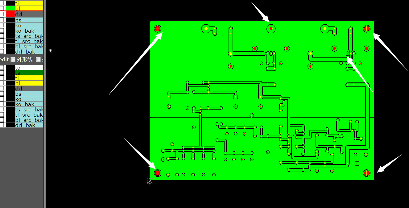

I received another question:
As shown below, there are no copper in the middle of the pads on hole area. Can we fill them up with full copper and make the holes on them as plated holes?
Is it necessary for the PCB fixing holes to be copper-plated to have the connection to the chassis?
I don't have the board in front of me, but the 4 mounting holes in the corners are fine unless you want to electrically connect to the chassis, which you don't,
Then I think I see the 4 holes for the two pins on each of the 2 heatsinks. Again, you don't want those connected (the heatsinks are isolated electrically).
Not sure about the others without a photo of the original board, but that's at least 8 accounted for.
@lillo: As Albert pointed out, the 4 PCB and the 4 heatsink mounting holes are isolated.
The other 'red holes' are all connected to ground.
I have a pair of unused boards from PL and I just poked around with a multimeter and that's what I found.
I also had some boards made using the available gerbers (and adding the solder mask) and they came out fine. In fact, I used these boards in my build since I was convinced I would somehow mess it up and didn't want to risk the original set. 🙂

Sorry, just to be clear. I meant that those 4 PCB mounting and heatsink mounting holes are electrically isolated from the circuit.
The 4 corner PCB mounting holes, for example, have metal on the inside (thus you can say they are plated), but the plating does not extend beyond the height/depth of the hole and is not connected to anything else.

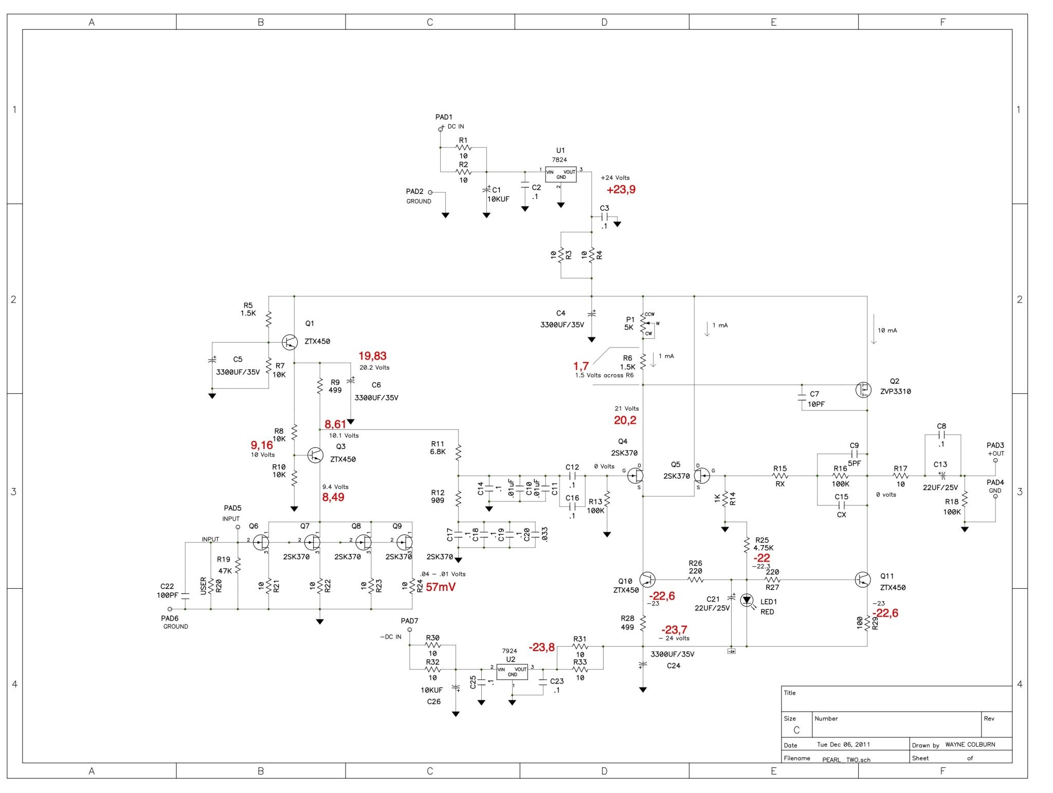

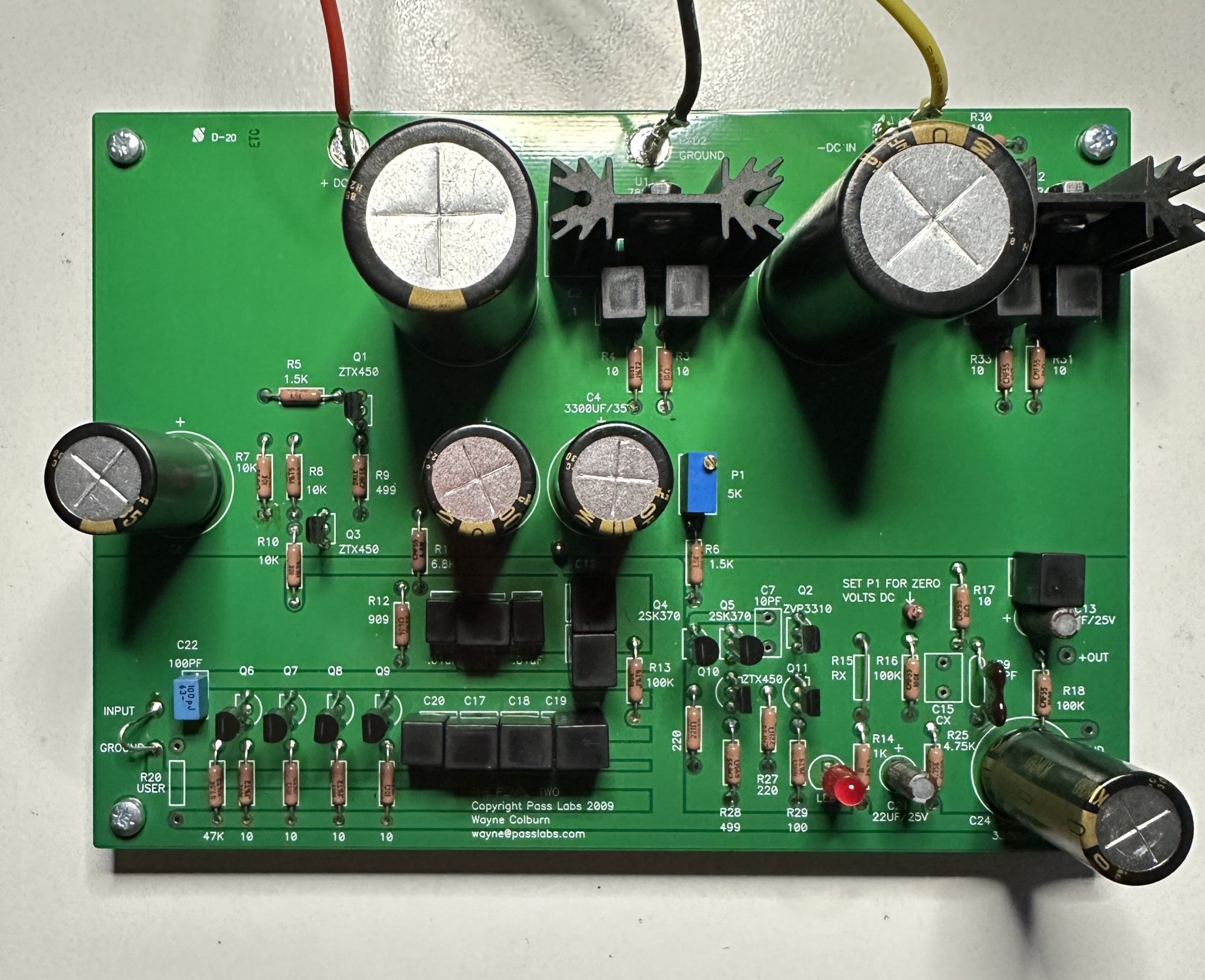

I’ve finally had the time to stuff the PCB and made some test on voltages
Here is what I can measure (in red)
Some value are quite different from the original ones…should I be worried about ?
All the components are as original BOM
